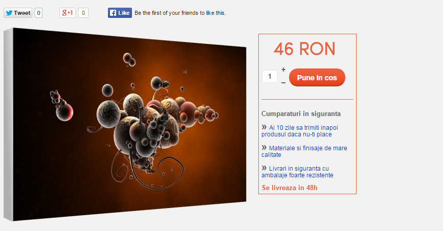

If you go to domain/abstract and click on any product you will only see the picture of the product and the Add to cart box.

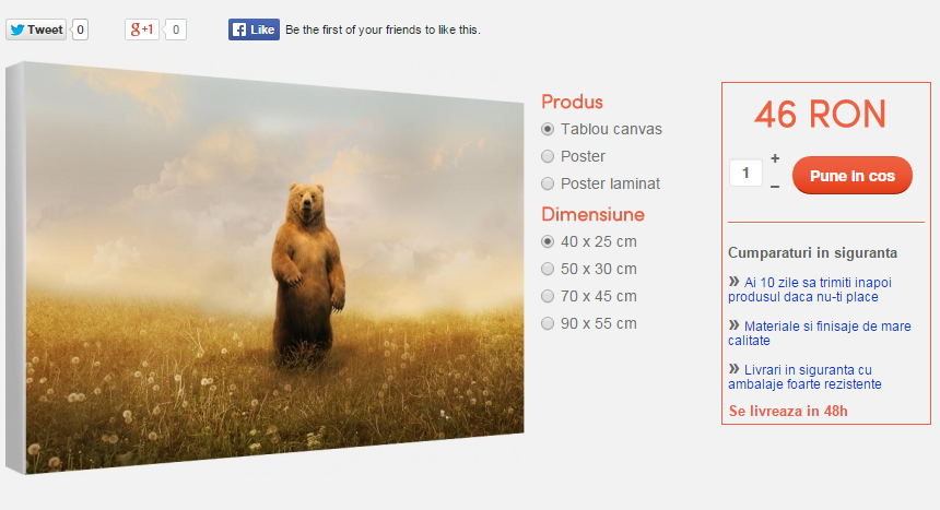

If you go to domain/anime and click on any product, between the picture and the add to cart product you will see all the options/variants of the product.
All the categories that you see on the left side menu work well except the abstract category.
I don't know what happened, everything was working ok. I just thought I'd do some work today on it and realised the Abstract category isn't working properly.

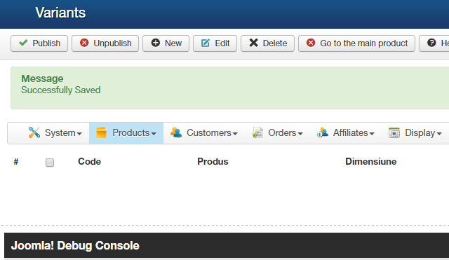

Also, I went to the backend and clicked on a product in the abstract category and then clicked on Manage Variants and a message appears:
Message
Successfully Saved
And then nothing else besides the backend hikashop menu bar. It's white under that bar.

Normal with variants:

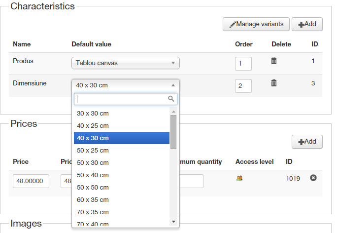

This is a screen shot of the Characteristics tab of the product:
And when I click on Manage Variants this is what appears
This kind of looks wierd to me. I can see the characteristics but when I click on Manage Variants that message of Succesfully saved appears and no variants. There must be some kind of mixup somewhere.

11 years 5 months ago #195838
If the variants have been deleted, they have been deleted. Otherwise, they would show on the variants listing of the product that is displayed when you click on the "manage variants" button.
If you have the "automatically generate variants" option of the HikaShop configuration activated, you can get the variants regenerated automatically. But that will still require reconfiguring the variants.
The only effective solution here would be to extract the hikashop_characteristic/hikashop_product/hikashop_variant tables from a backup from before they were deleted in order to get back the variants data.
