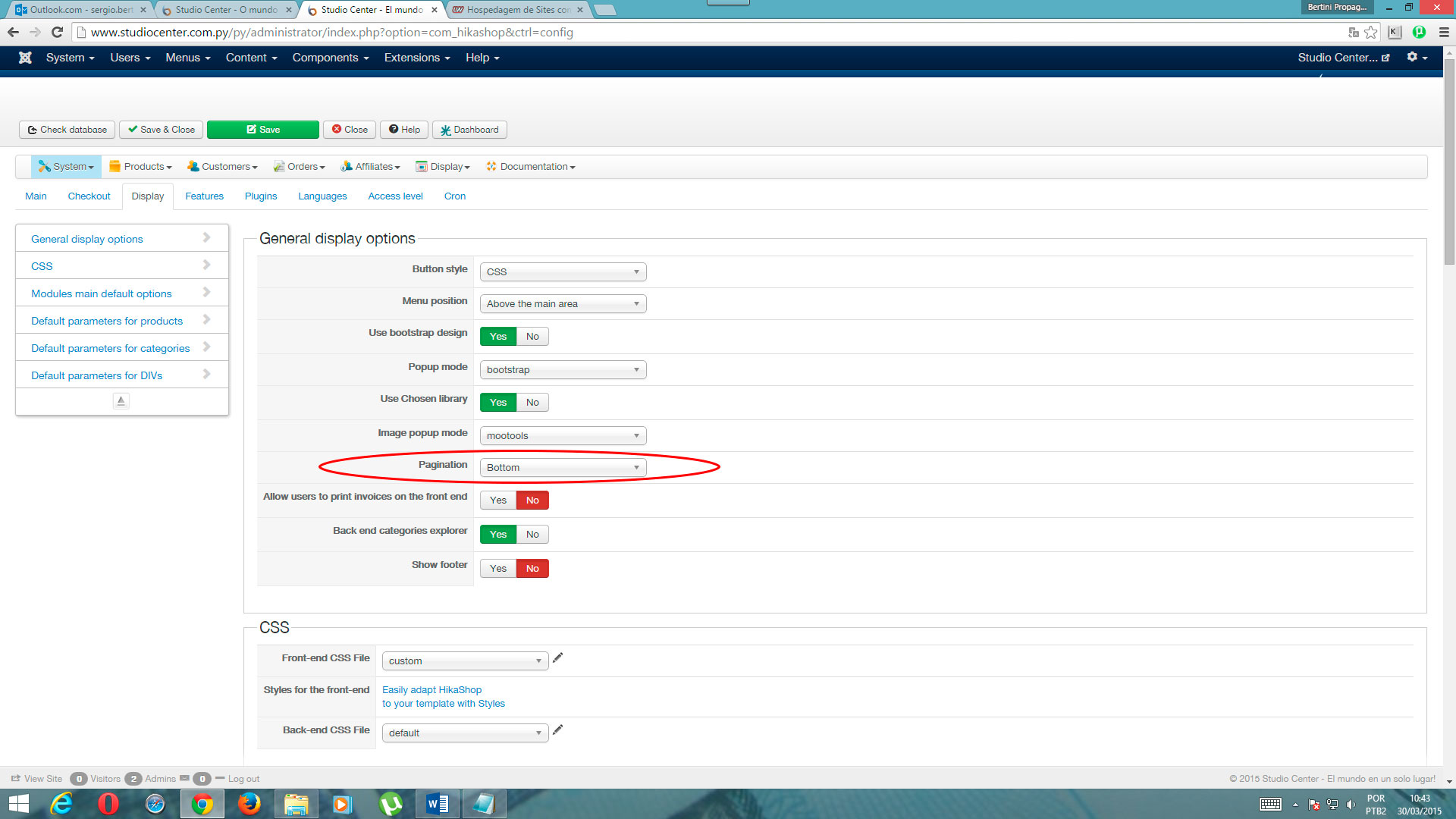

How do I enable paging in hikashop, at the bottom of the categories with product?
See website below, you see the products but can not go to page 2, 3 ... Why does not the pagination footer.
httpp://www.mateplas.com.br
11 years 5 months ago #195160
Please check the "Pagination" option in Configuration > Display > General.
  • Posts: 128
11 years 4 months ago #196683
I had already set up to display the "Pagination" in the page footer, but it is not displayed!
Help me!

11 years 4 months ago #196825
Your product listing module have the "random" setting activated.
When the listing is in "random", it's not possible to have a pagination because the products changed each time the page is displayed.
  • Posts: 128
11 years 4 months ago #196938
Tank's! Solved!
