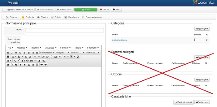

I would like to customize and modify the form administrator to add a product, or remove all the items that I need, for example: I do not have "options" and "related products" I want to remove these two parameters from the form in order not to view them more '.

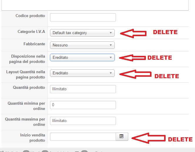

Good evening , unfortunately still are not satisfied with the result , I just can not figure out how to customize the page loading product ... in ' image fields that I would like to remove .

You actually don't even have to modify the code of the view if you want to hide these fields. Just add such CSS code in the "backend CSS file" of HikaShop under the CSS section of the Display tab of the Hikashop configuration and that will do it:
.hikashop_product_tax_id_row, .hikashop_product_manufacturer_id_row, .hikashop_product_layout_row, .hikashop_product_quantity_layout_row, .hikashop_product_sale_start_row{ display:none; }
Of course, you won't loose the change when you update HikaShop.

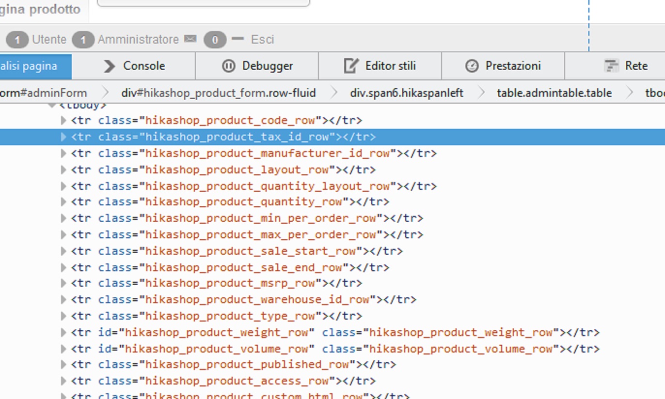

11 years 5 months ago #195950
Yes ; just analyze the page code thanks to the browser inspector (like explained in the tutorial page).

I'm sorry, the control with filezzilla it's ok, I can not go forward because in the file backend_default.css (/ media / com_hikashop / css) I can not find:
I do not understand where wrong ...
11 years 4 months ago #196195
You need to read more carefully :)
