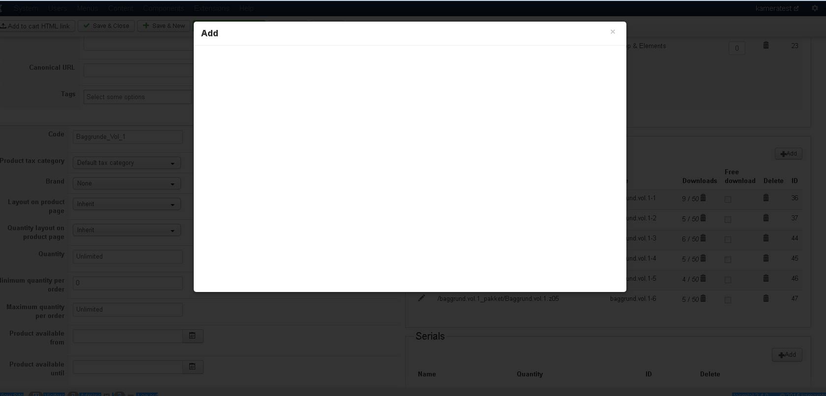

trying to attach files for download. Clicking ok just gives a white window box, and nothing happens..
Please advise and help
regards
Bison

I click on "Add" to select a file for download
I select the file and press "OK"
When doing so the the popup just turns white and nothing happens.
Just as the picture above.
Upload path is fine -
This error just happen with the upgrade to latest version
regards
Bison

Details:
trying to attach a file, allready uploaded to directory
Clicking "add"
popup opens
Set file mode to "Specify file location"
setting file path
clicking ok
popup box turns white and nothing happens
Configuration:
Allowed files zip,doc,docx,pdf,xls,txt,gz,gzip,rar,jpg,gif,tar.gz,xlsx,pps,csv,bmp,epg,ico,odg,odp,ods,odt,png,ppt,swf,xcf,wmv,avi,mkv,mp3,ogg,flac,wma,fla,flv,mp4,wav,aac,mov,epub,gsd
Upload secure folder
media/com_hikashop/upload/safe/
have tried both with ZIP files and RAR files
Bison

That's the path of your upload folder. What we wanted to know is an example of what you entered in the "path" field of the popup so that we could reproduce the problem.
As you didn't provide it yet, I went ahead and did a test with a random relative path test_hikashop.zip and was finally able to get the issue on your website.
A FTP access can be great when there is a problem that we are able to reproduce on your website but not on our end. So far, we were not able to see the problem on your website and not on our end either so a FTP access wouldn't have helped or made it faster. What we needed was a precise explanation of how to reproduce the problem.
So now that I knew how to reproduce the issue on your website, I went and tried to reproduce the issue on a test server on our end and found out that the issue was there too. So I actually made a patch and fixed the issue on our end and we generated a new build of the release with the patch included.
Now, you can download the install package via the menu My account>My subscriptions on our website and install it on yours and that will add the patch so you won't have the problem anymore.
