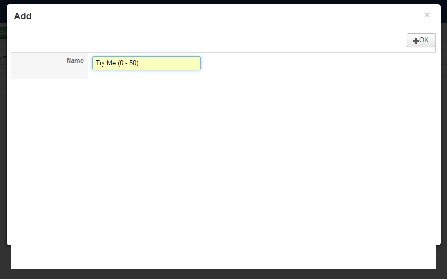

This is what the screen looks like when I create my first value:

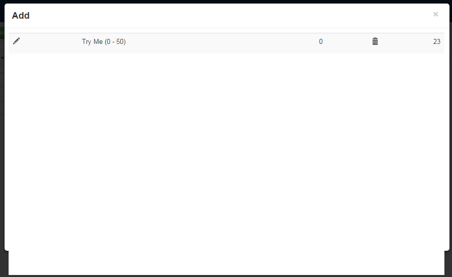

When I click OK to create the value, this is what the screen looks like:

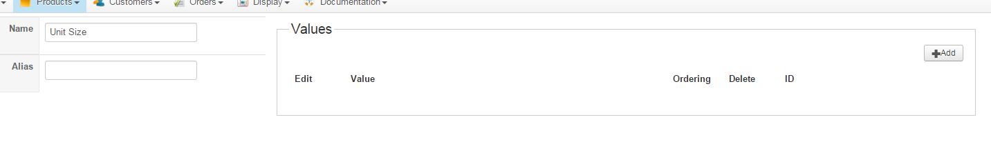

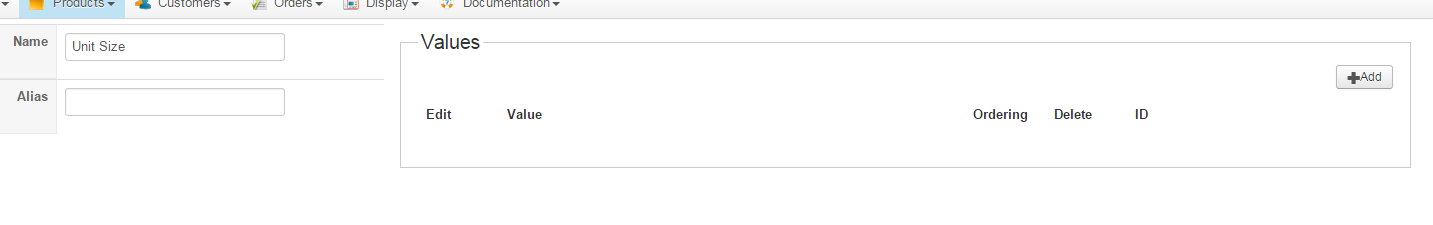

This is what the characteristic screen looks like after I close the previous screen. The value does not show!

This indicates that there is a javascript error on the page.
Looking at the popup in your screenshot, it would seem that you're using HikaShop 2.3.5 and not the 2.4.0 version as we fixed the popup inside area going outside the popup borders with the 2.4.0 version.
Could do download the 2.4.0 install package on our website and install it on yours again and see if that helps.
If not, please check the javascript error console of your browser while on that page. You should see an error message and that should help us understand why you have that error.
