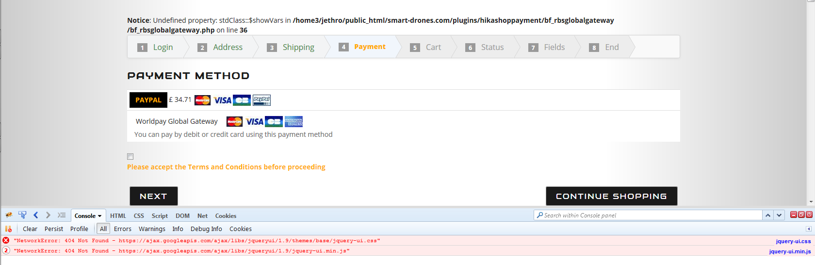

-- Error-message(debug-mod must be tuned on) -- : Notice: Undefined property: stdClass::$showVars in /home3/jethro/public_html/smart-drones.com/plugins/hikashoppayment/bf_rbsglobalgateway/bf_rbsglobalgateway.php on line 36
Hi everyone, I am getting some errors with the checkout pages on my website, I am not sure if it is to do with the template which is Bootstrap 3 based (Purity III from Joomlart)...
Here is a screenshot I get from the error reporting in J! and the Javascript error reporting in Firebug...
Here are snippets of the error codes I am getting:
From Joomla error reporting
From Firebug
"NetworkError: 404 Not Found - https://ajax.googleapis.com/ajax/libs/jqueryui/1.9/themes/base/jquery-ui.css"
jquery-ui.css
"NetworkError: 404 Not Found - https://ajax.googleapis.com/ajax/libs/jqueryui/1.9/jquery-ui.min.js"]
The page with the problem is in the checkout process on my website, so I am not sure how I can share that with you guys.
Could this be some sort of Mootools/JQuery conflict between Hikashop and Purity III?
Are there popup panels that should be displaying? I am not seeing anything, at the "end" page there is nothing.

The warning you get during the checkout is not really a problem. Just some debug information for the developer. You can turn off the "error reporting" option of the joomla configuration and you won't see it.
Normally, you should be redirected to Worldpay at the end of the checkout.
Please note however that this global gateway has been used much so maybe there is a bug. However, also note that I thought that WorldPay had restricted the use of that payment gateway and preferred instead the business gateway. Are you sure that it's not the business gateway that you want to setup on your shop ?
