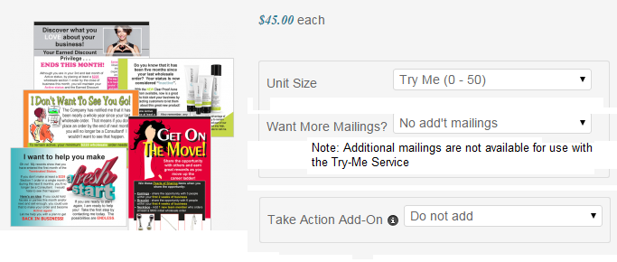

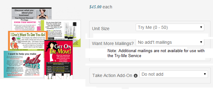

Another problem is that I have no way of letting customers know that the add more mailings field is ONLY for those choosing the unit size of 6 or more since characteristics don't have one of those information buttons available like the product option does.
Is there any way I can put some text after the unit size option to let them know that? See example below:

You can edit the file "show_block_charactersitic" via the menu Display>Views and add your text at the bottom of the file

11 years 4 months ago #199524
It will add that for every product.
If you want a different text for different products, you can instead create a custom product field via the menu Display>custom fields, and add such code in order to display it at the bottom of the show_block_characteristic view file:
<?php echo @$this->element->main->column_name; ?>
where column_name is the column name of your custom product field.
