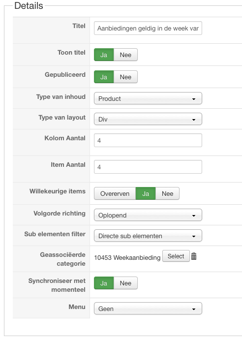

I have made a special category, “weekaanbiiedeng”, that is unpublished. ID 10453
There is a content module, ID 167. This module does what it does on “unassigned” pages.
No matter what I try in the settings. If I show the module on pages that link to a specific category… the “special product module” will NOT SHOW the special products but other products or NOT SHOW AT ALL.

That's because you've turned on the "synchronize with currently displayed content" option of the module.
Because of that, the current category will override the "associated category" setting of your module when possible (when you're on a page with a current category).

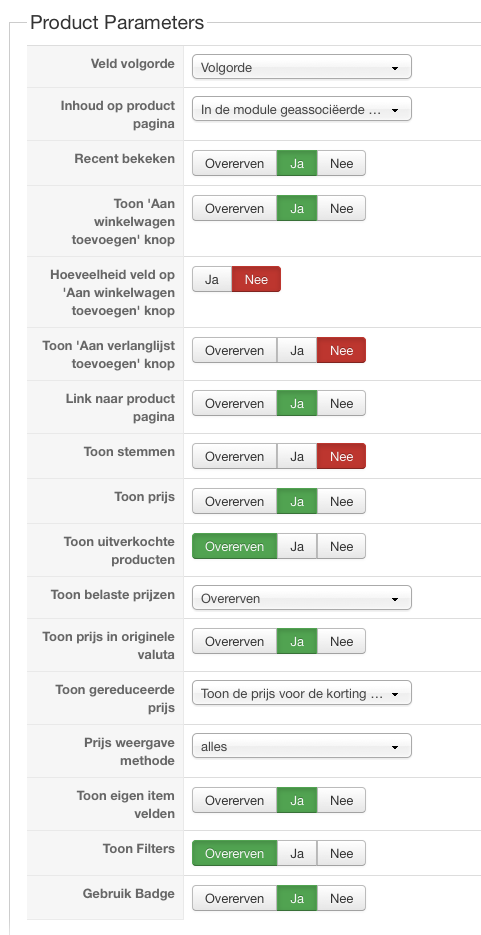

of course I tried all that! I have read guidelines and forum thouroughly. This was not the reason!
Your post however made me think and I saw the error:
The module settings overruled the details.
It was the "recent article setting"
After unchecking All is well!
THANKS for the trigger!
