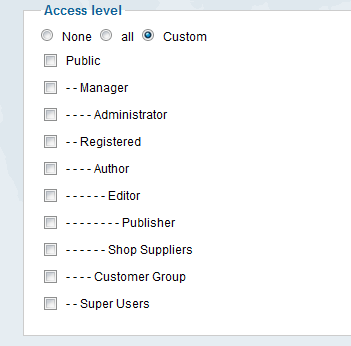

Hi Dear

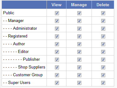

I need customize custom field Access level. when created a custom field we can set Access level and it's this is:
but I want customize it and use configuration mode for each custom field created. configuration Access level mode this is:
how can do it? thank you for your best support
Last edit: 11 years 3 months ago by kaya.

I want each custom field configuration page change the "Access level" options to this mode:
I want select who user can view or manage or delete a custom field in backe-end

Hi dear Nicolas
This method for config access options in config view
$acltable = hikashop_get('type.acltable');
now I want know which table in database this method save data?
  • Posts: 86077
  • Thank you received: 14185
11 years 3 months ago #201869
This method loads an instance of the class of the file administrator/components/com_hikashop/types/acltable.php
Then, this class has a method to display the ACL selector.
It doesn't save anything. The save is usually handled by the saveForm/save functions of the class file of the element you're editing.
So if you're saving a custom field, it's the file administrator/components/com_hikashop/classes/field.php where the saveForm function stores the ACLs displayed by the type.acltable
The following user(s) said Thank You: kaya
