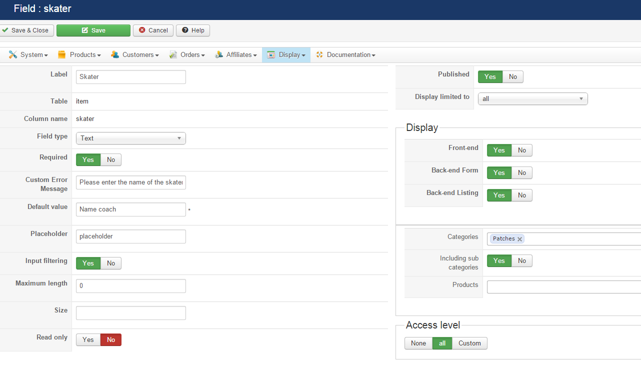

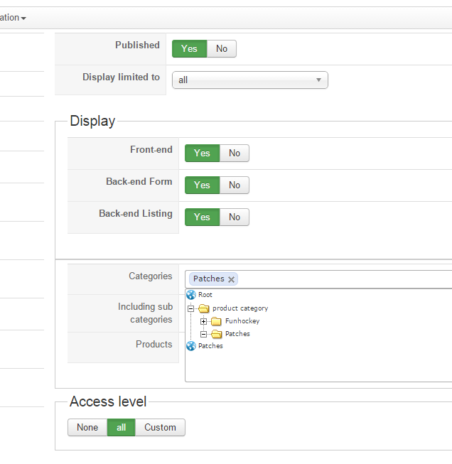

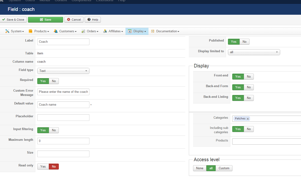

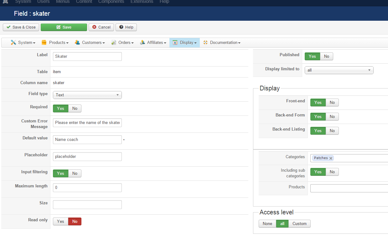

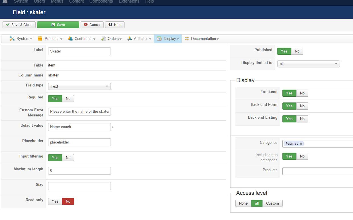

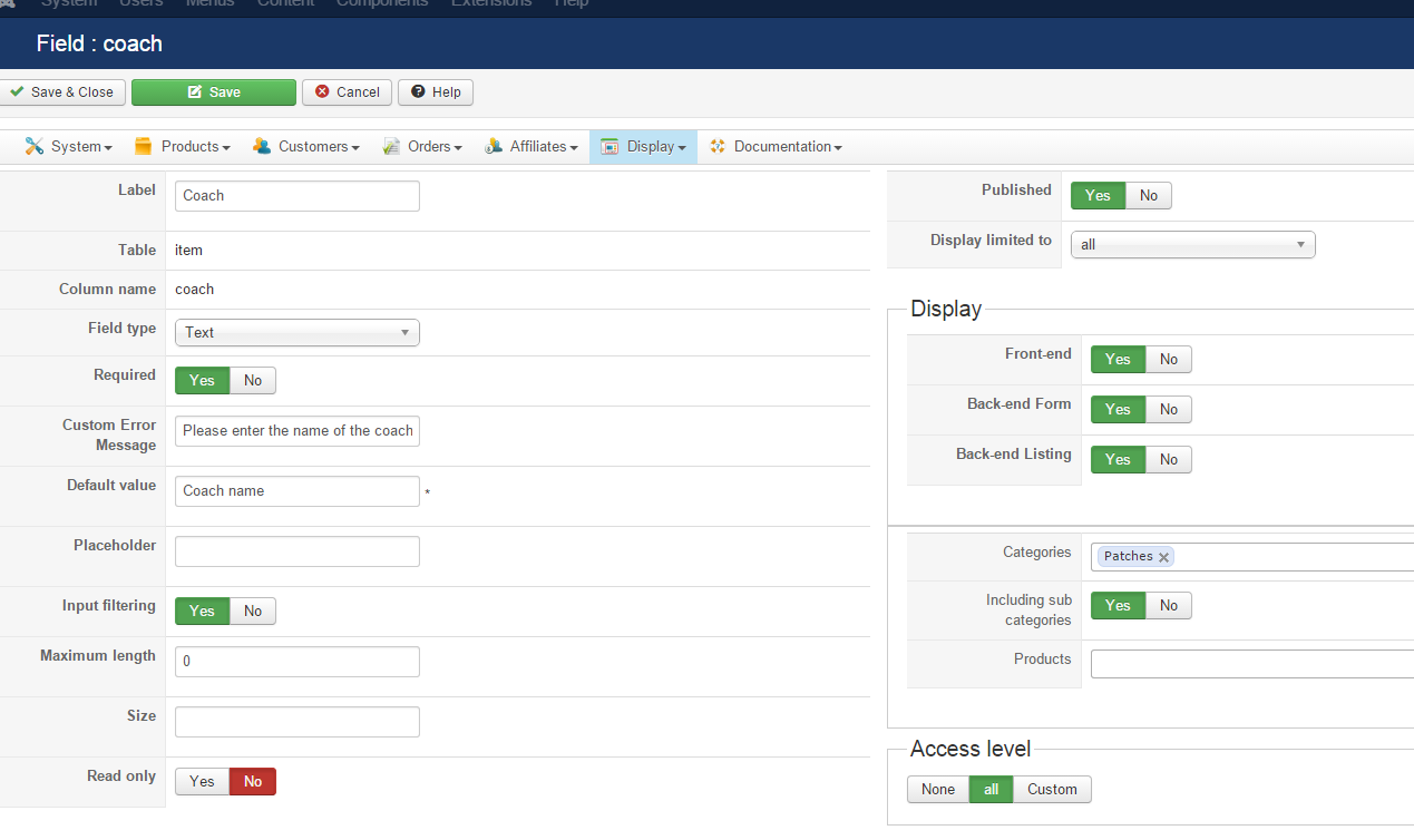

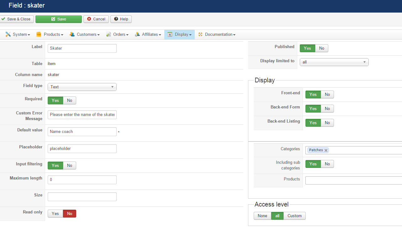

System > Config > Display > Default parameters for products > Display custom item fields = Yes
Display > Custom Fields > Item > see attachment
Any thoughts ?

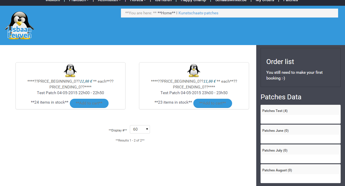

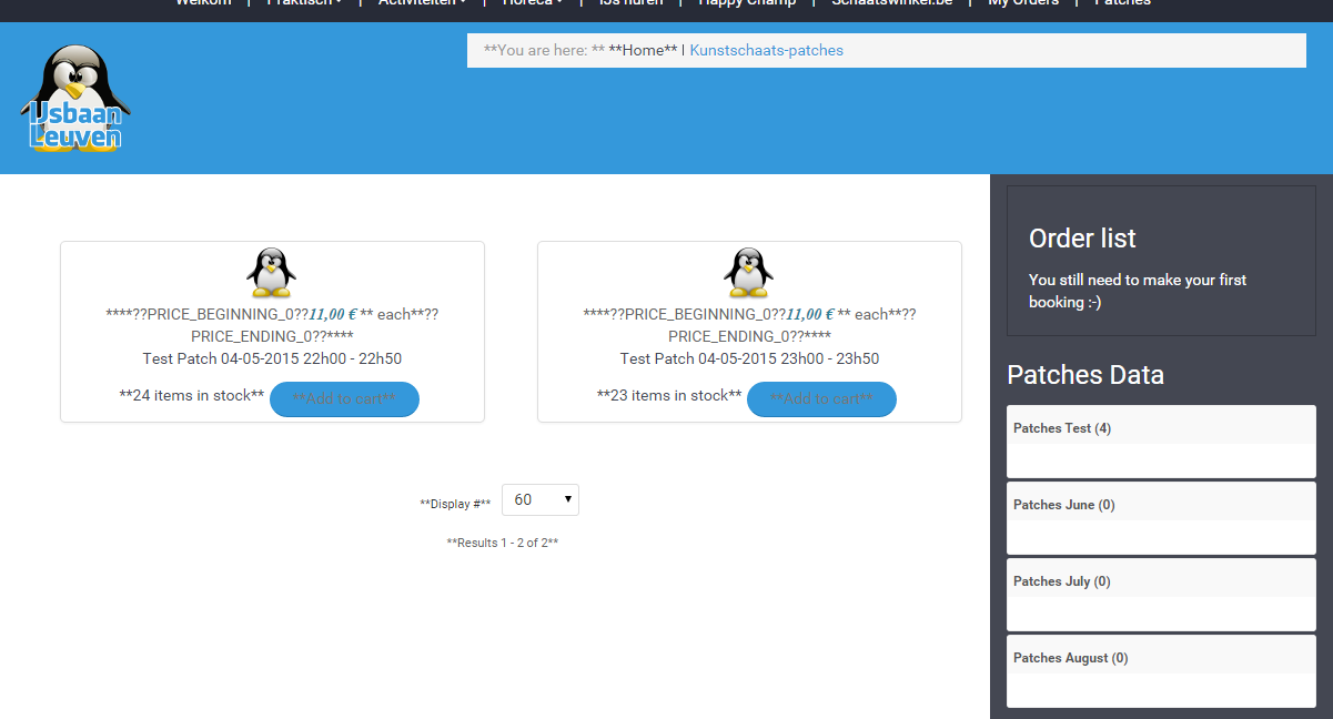

The fields are still not showing in the Front, see attached files for setting in the item fields : see attached files.
Config > Display > Default params products > Display Custom Fields = YES
It used to work but now is doesn't anymore.
All help will be gratefully accepted ..:-)
Joris

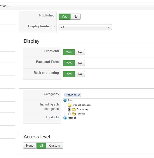

11 years 3 months ago #201351
1.
I just tested it on my end and it worked fine, in your case the "Paches" category seems to be applied to your custom item field.
2.
Are you sure that :
- Your product are on the "Patches" category
- You have set the "Display custom item fields" option of your product listing content menu to YES (via "Hikashop->Display->Views->Content menus").
The following user(s) said Thank You: ijsbaanleuven

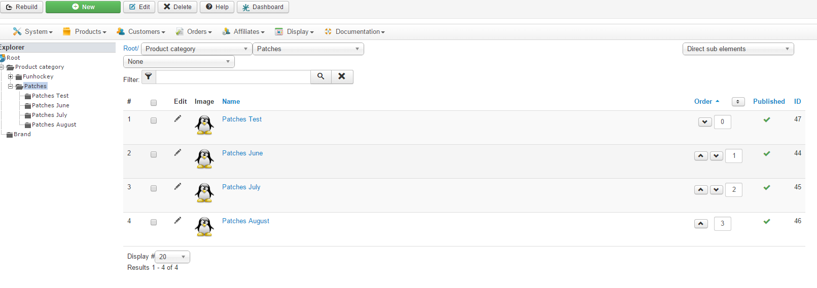

  • Posts: 72
11 years 3 months ago #201375
Mohamed,
Ok. Found the problem.

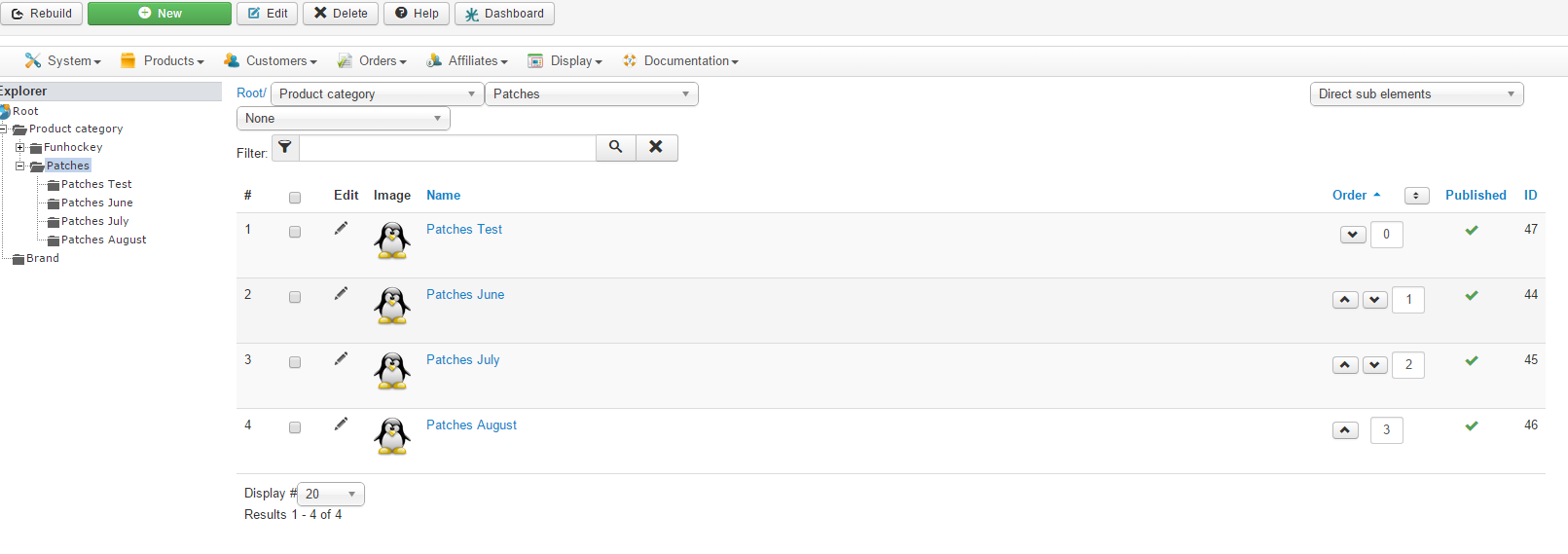

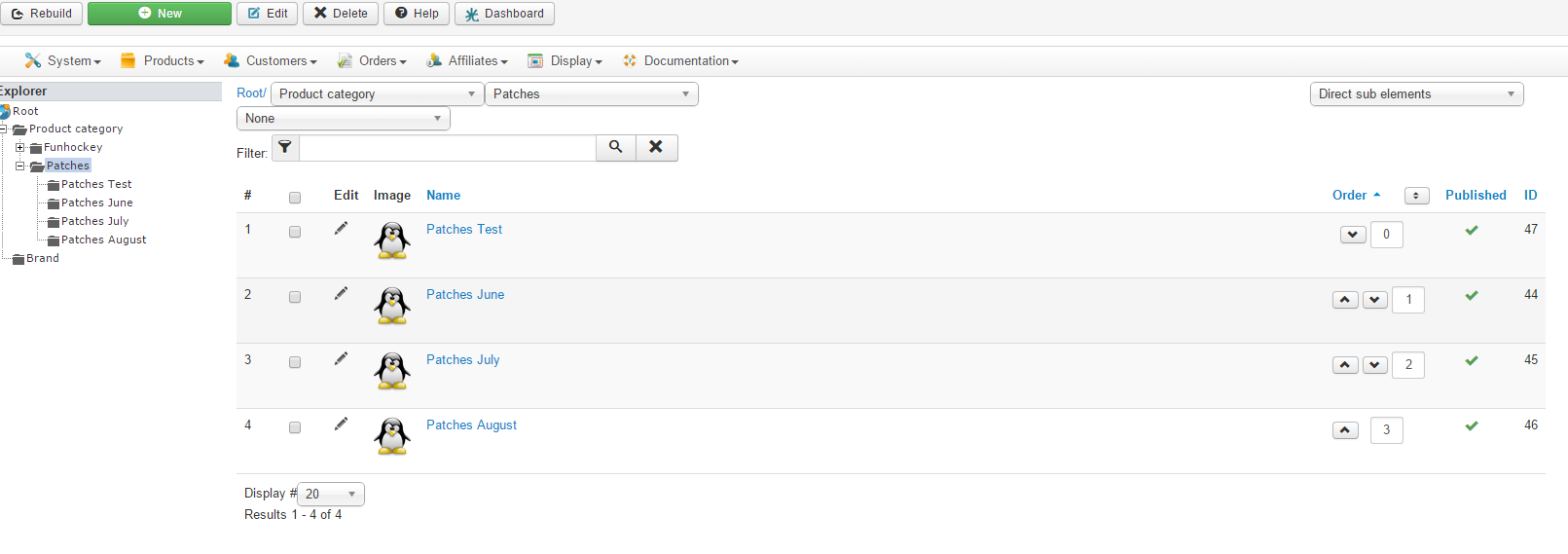

Problem is that I had created a test category to try stuff with.
This is a subcategorie of the folder Patches.
See image cat.png.
Problem seems to be with the display of the custom fields, where it does not show the subcategories of "patches". See attached file view.png.
I move the products from the test category to "June" and now it works again ...
Wierd ...
