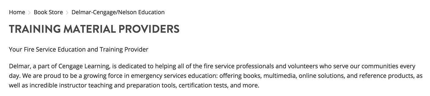

I am having issues with incorrect page titles. The page title set on the main category listing page is being used for each individual category page. For example, I have set the page heading for the main HikaShop menu item to "Training Material Providers". This works, but when I navigate to a single category page, instead of the category name being used as the page heading, the page heading from the main HikaShop menu item is being used. What do I need to do to fix this issue? Any help is appreciated. Thank you.

11 years 3 months ago #200865
I have made the configuration change, but the issue is still occurring. Cache has been cleared after changing the configuration. I have attached a screenshot that shows the issue. Any help is greatly appreciated. Thank you.

Caching is not enabled on the website right now because it is under development. The issue is not with the breadcrumbs module, the issue is with the HikaShop page titles. The breadcrumbs module displays the correct category name, but the page title is incorrect. "Training Material Providers" should be "Delmar-Cengage/Nelson Education". HikaShop is carrying the "Training Material Providers" title over from the main book store page to all of the category pages. Any suggestions? Thank you.
