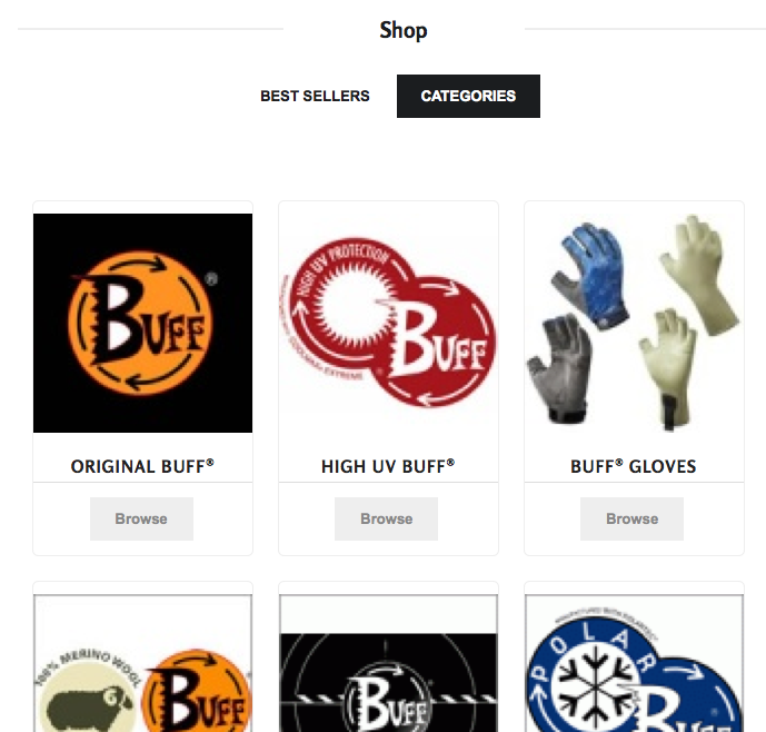

I am just setting up some modules and I have troubles getting it right. I assume that it is my understanding of the detailed settings for modules.
Here is my test server
cqh73.joomexp.com/gavick/

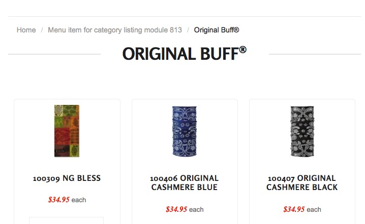

If you scroll down to the homepage you will see tabs with one saying Categories. This is a Hikashop module displaying categories. If I click on for example "Original Buff" I get screenshot 2. Instead of going to Home / Shop / Original Buff® (the menu I set up for every category) I get
Home / Menu item for category listing module 813 / Original Buff®
It's the same if you click on "Best Sellers". The product URL is different than if you go through the menu.
What do I have to do to get every category module to lead to one category Url and one product URL so that I don't have duplicate URL's for the same content?

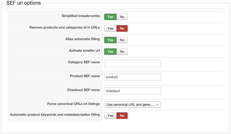

Now I know why I didn't find anything under modules. It's of course a SEF issue.
I have activated the option "Use canonical URL and generate if missing" but it doesn't do any filling. This creates 2 questions.
1. What do I have to do to get Hikashop to fill in the URL?
2. What does the structure of the URL in the canonical field look like? Is it the full url or just the relative part?

2. Also, a simple solution is to use the "Force canonical URL on listings" option of the HikaShop configuration to auto fill the canonical URLs of the products so that the same link would be used on all the listings, regardless of the "menu" setting.
3. The automatic filling will be done only when the system needs to generate the URL on the frontend. So as long as you don't display the products listing on the frontend, you won't see the canonical URL filled in the product.
4. It's the relative path of the URL which is put in the canonical URL field, but it can also accept the full path.

This one is weird too. If I enable "remove category and product ids from URLs" I get the message "Product not found" when clicking through to a product page. If I disable it everything works fine. These are my settings in the configuration. Would could I miss?

The module 813 is the one from which you came and the 880 is the one associated with the target menu item.
When you activate the "remove category and product ids from URLs" setting, the ids are removed in the URLs. However, the system still look for the ids in the URLs, for backward compatibility and in order for your google ranking to not go down temporarily. So if your products name start with a number, it will actually look for a product with that number as id and thus won't work properly. The solution in that case is to enter the alias you want for each product without having it starting with a number.
