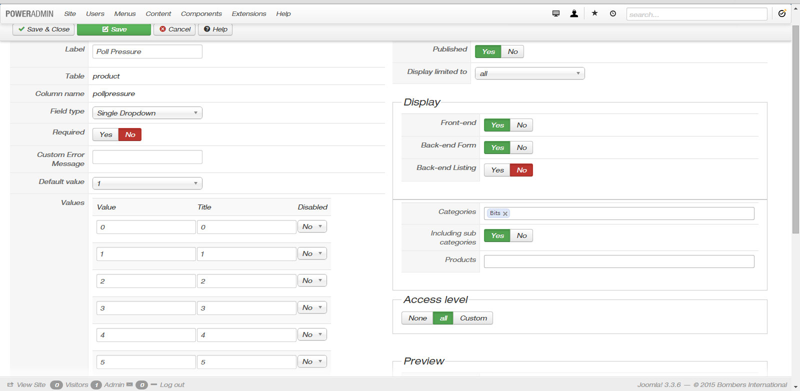

11 years 4 months ago #201748
Could you do a screenshot of the settings page of one of the custom fields on use so that we can see how you have it configured at the moment ?
  • Posts: 26
11 years 4 months ago #201751
Hi Nicolas
Please find attached the screengrab.

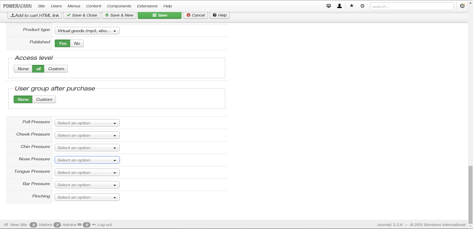

There seems to be an issue with the fix you suggested. When i am in the back end editing a product i cannot configure the drop downs so it displays the correct image. The dropdowns are grey-ed out, please see image attached.

11 years 3 months ago #203142
Please edit the file "administrator/components/com_hikashop/classes/field.php" and replace the functions "trans()" by:
	function trans($name) {
		//We use JText if there is only uppercase or underscore char
		$val = preg_replace('#[^a-z0-9]#i','_',strtoupper($name));
		//We use JText on backend only if there is no html tags in the translation
		if($app->isAdmin() && strcmp(JText::_($val), strip_tags(JText::_($val))) !== 0)
			$trans = $val;
		else
			$trans = JText::_($val);
		if($val == $trans)
			$trans = $name;
		return $trans;
  • Posts: 26

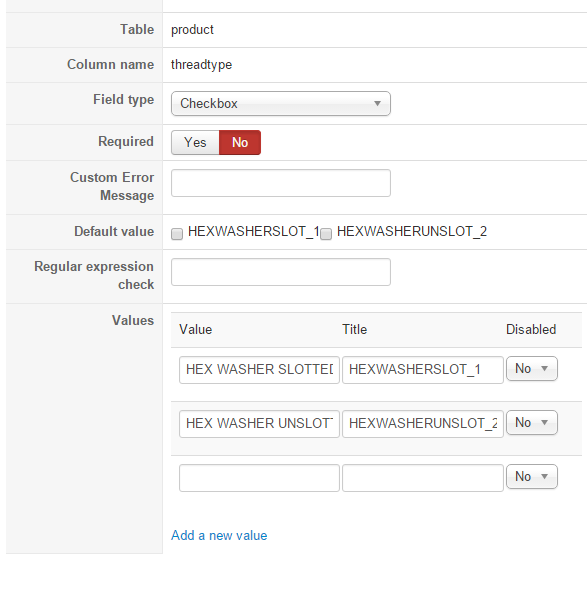

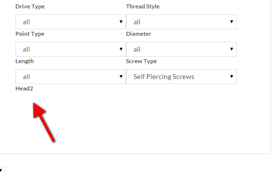

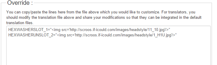

I tired this method you describe -- hoping that the images would show up in a filter for the custom field. But no joy -- get no images in the filter. Is there something I'm missing? the value keynames in the title. See attached.. and then I edited language file. But get nothing in the filter.

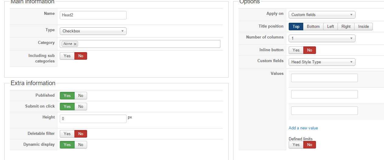

  • Posts: 86179
  • Thank you received: 14214
11 years 1 month ago #211429
The issue seems to come from the settings of the custom field, not the translation of the values.
Could you provide a screenshot of all the settings of your custom field ?
