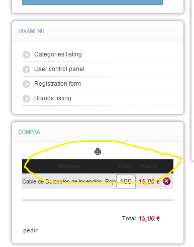

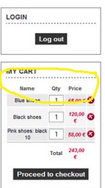

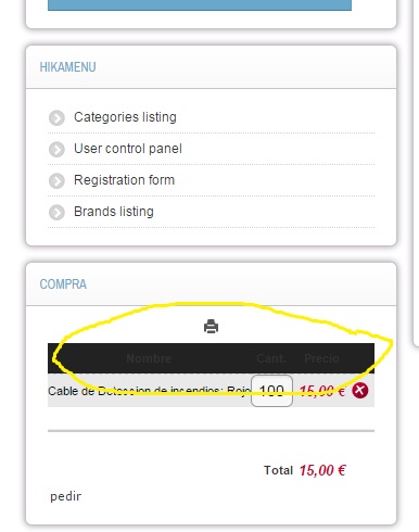

Hi. I just bought the style pack and install it, and I'm having loads of troubles with it. I think it may have some incompetences with my template, which is strange since it says that hikashop styles goes over template styles... I 'm attaching an example here. The line in the cart module, has a strange style (all black) in the line that shows what is quantity, price, etc. I attach a file of my template with the pink style on, with that line circled in yellow, and a photo of the example of how your style should look according to your page.
There's more examples of these fails, but I'll wait since there might be a global solution?
Thank you
11 years 3 months ago #201863
To fix it you'll just have to use some CSS code and change the background of the cart tab header : www.hikashop.com/support/documentation/1...the-display.html#css

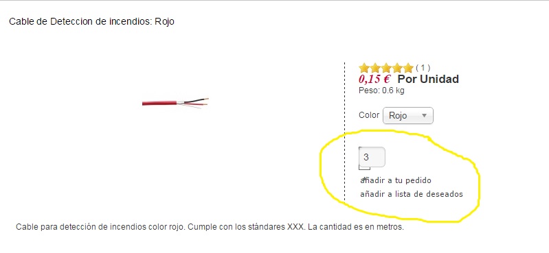

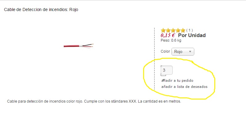

Thank you Mohamed, I could change that. Now a bigger problem. On the product / show_quantity module, it has a lot of problems. As you can see in the picture below, the square where you can put the quantity overlaps de +/- button, and also, the "+" of the "+ add product" overlaps itself... I've tried to find out how to solve this, but I 'm not capable of... The code of the module is as follows:

Where could I fix this? I can't find how to solve it. Thank you.
  • Posts: 129
11 years 3 months ago #202079
already solved it!
For those having the same trouble, you have to change the fields "Layout on product page" and "Quantity layout on product page" in the product edit page, and not in the main fields.
