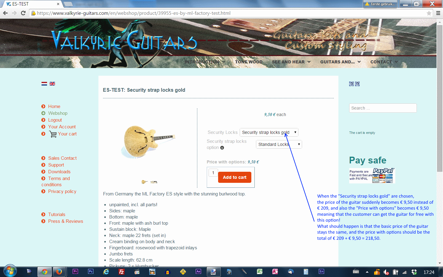

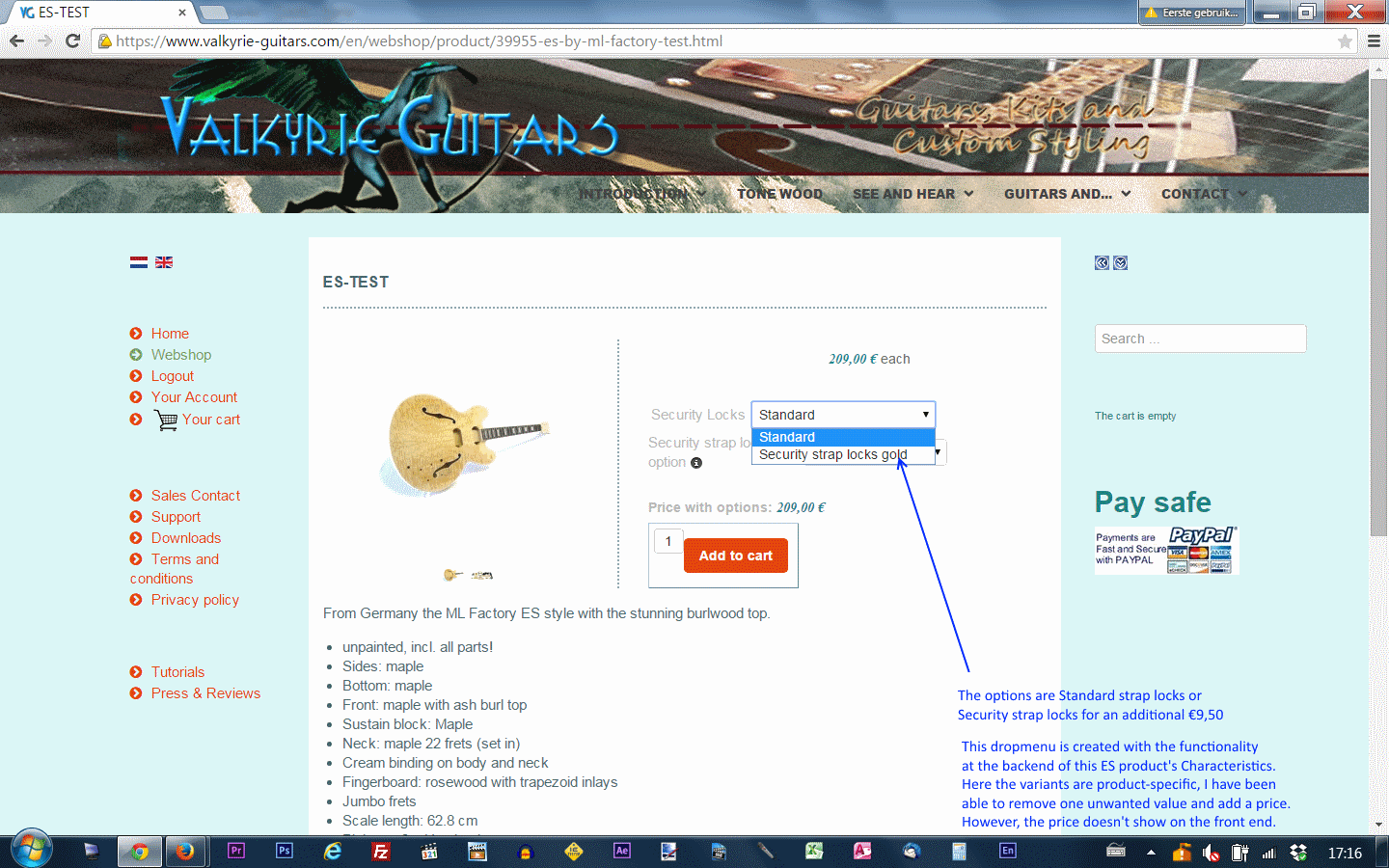

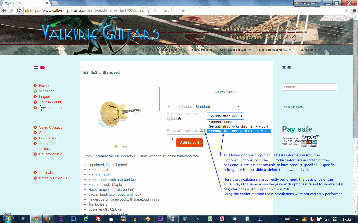

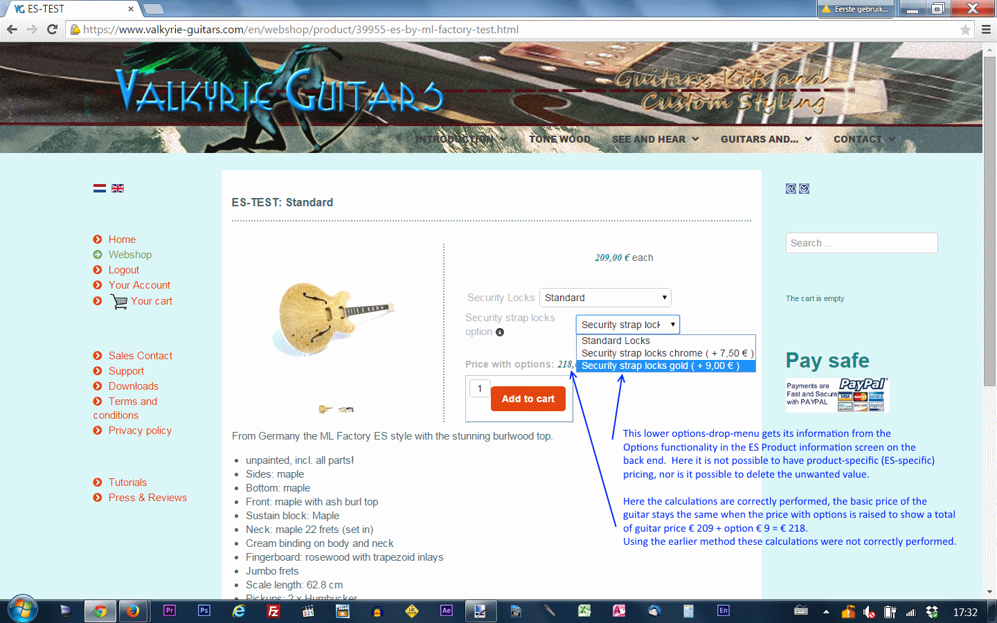

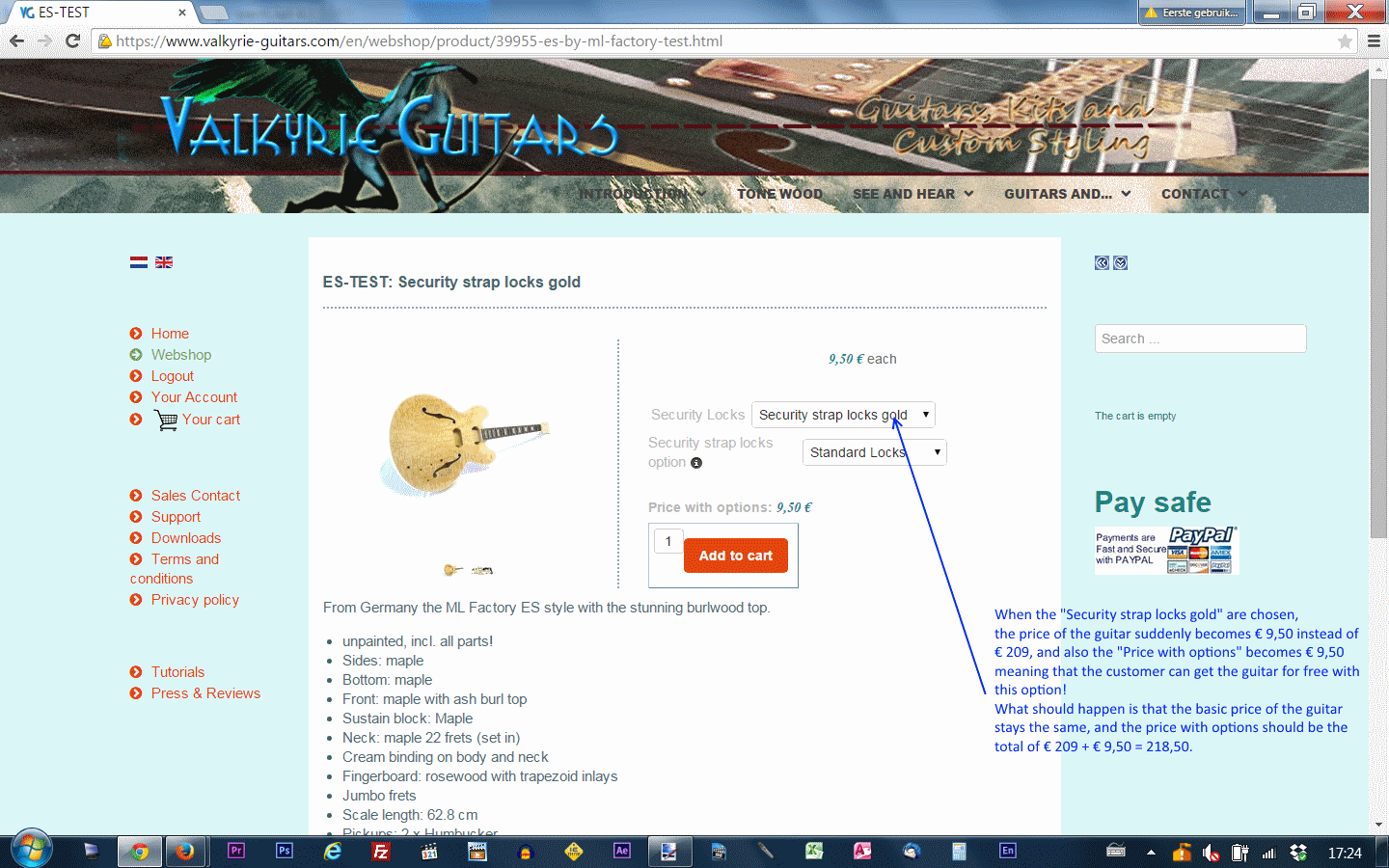

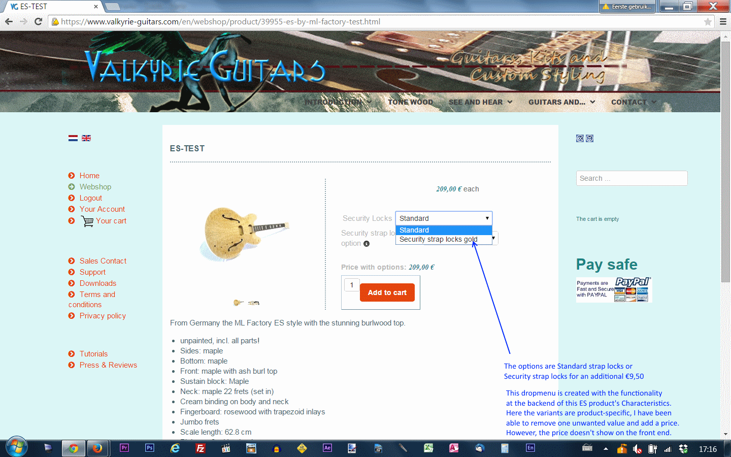

We are very pleased so far with Hikashop, it provides more and more possibilities. Currently we have a need to offer options with our products. This must be done in such a way that each product can have a different subset of values for a characteristic. Unwanted values need to be deleted. Also, the values can come with different product-specific pricing, depending on what product they are for.
Hikashop seems able to partly do this, there are two (partial) ways we have found. In the product attributes page:
1. Using the "Options" section: the standard values and pricing is used, all values are presented, but it is not possible to have other pricing or to delete unwanted values from the list.
2. Using the "Characteristics" section: here, after adding the characteristics, the values are created with a product-specific code. It is therefore possible to delete unwanted values. It is also possible to add other prices. However, the prices are not visible in the drop menu on the front end. And the calculations result in strange effects on the product page, wrong pricing for the main product, wrong calculation of total.

How can we achieve the best of these 2 world. Our products need:
A. Only the values relevant for the product should be visible.
B. The prices of the product-specific-values which can be selected should be visible in the drop menu.
C. The calculations should be correct and visible on the front end, with the price of the basic guitar remaining visible.

Characteristics can be used to handle products with variants. For example, shirts of different colors/sizes.
When you set the price of a variant of the product, you enter the price of that variant of the colors/sizes of the product.
So for example, you'll enter the price of the blue XL shirt, and another one for the red S shirt.
You won't enter the price of red, or blue, or S or XL.
So first, you don't see prices in the characteristic dropdown because it's not possible for the system to display one as you didn't set any for the characteristic value, only for the variants of the product.
And second, you don't see the price of the main product as the price of the variants override the price of the main product instead of adding up to it.
That's totally normal and the way it should be. It's just that it's not what you want to use for what you're trying to do.
What you want is to use options. If you need different prices/choices for different products, it will require that you create different options and add the corresponding one for each product. You can't have a global option to add to all the products in that case.
