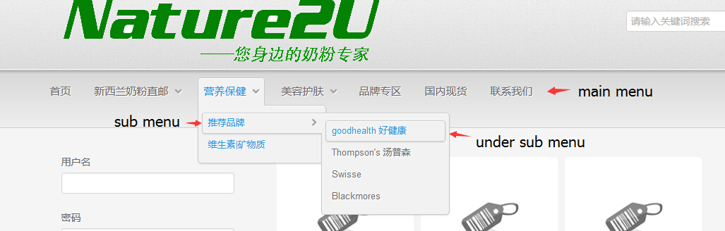

Hi there,
I have a few questions when I am using hikashop category and menu to list products.
1. Is it possible to show the navigation on product page ?
ex. You are here: homepage>main menu>sub menu>under sub menu, which means how we find the produsts and allow costomers to go back to one of the menu slection.

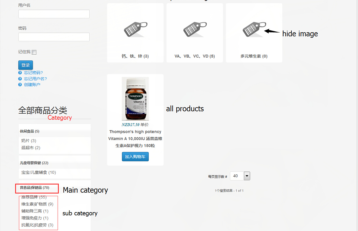

2. When I click the main category, it will display the sub categories, not the products, as attached. How could I make it show all the products on the same page under the sub categories display as well? One way I find was to list the product under both main category and sub categories, which is too complex.
3. How can I hide the image of the sub category?

11 years 2 months ago #203115
1. you have to enable the "breadcrumb" module and then play with the breadcrumb settings in HikaShop > Configuration > Features > SEF urls
2. The categories are displayed thanks to a menu, then a module is attached to this menu, you have to edit the settings of that module in order to set the value for the option "Sub elements filter" to "all sub elements". These settings can be found under the menu Display > Content menu, select the category listing menu, then scroll down to the associated module part.
3. You have to change the settings of the category listing menu this time, select "div" for the "type of layout" option and the value "title", for example, for the option "Type of item layout".
