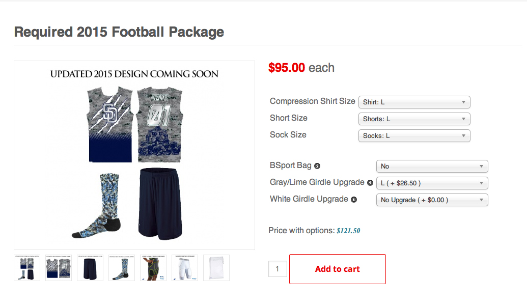

Outline:
I have a product that's a package set of 3 items together. This package has upgrade options to add 3 new upgraded products along with the order. I added these 3 new products as separate items, with only 2 products containing characteristics for sizes. ( small, med, large,etc. )
Because the 2 add-on products have characteristics assigned to them, there is not a default for "no" like there is when you add a product without characteristics. To by pass this issue, I added one more characteristic to each new upgradable product and set the name to "no upgrade" and the price at 0 for that particular characteristic. ( So shoppers do not have to add the product to the order if they do not wish since it's an upgrade. )
Issue:

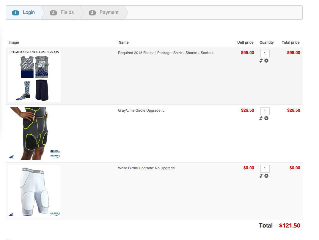

When a shopper adds the package to the cart when the upgrades are set to "no upgrade", the upgradable add-ons are added to the cart anyway, even though the price is set to 0.
Is there a way to keep these upgradable products from being added to the cart when the drop down box is set to "no upgrade" ( price 0 ) ? It would be a lot cleaner and less confusing for the customer.

11 years 2 months ago #204304
You could turn off the "display add to cart button for free products" setting of the HikaShop configuration.
But that will display an error message, so I don't recommend it.
Better than that would be to turn back on the "group options with products" setting of the HikaShop configuration so that the options get grouped together with the product for which they were added. It will be much more logical then, and that will also allow you to know which option is for which main product in the orders of your customers, which wouldn't be possible otherwise.

11 years 2 months ago #204381
That was it!
I just had to switch that setting on and everything fell into place.
