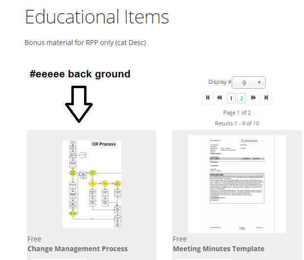

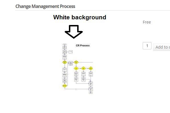

I did change the image to a PNG and that got rid of the white "fill" (thank you, that annoyed me too, but was not my question). I thought that maybe the image was taking up the entire grey box hence I could not "see" the color. But after changing it to a PNG there was no difference.
To make sure we are talking about same thing I have attached two screenshots (these are in Chrome, but IE and Firefox look the same) and there is no grey colored background behind the product view that I see.
Also, my default parameters for DIVs are set with a #eeeeee, but my understanding is that this does not control the color of anything directly, it only only affects the pre-population of the forms for DIVs. Is that correct?
Prod View (no grey)
Cat View (grey)

Hmm, read your posts again a few times, and I'm still not 100% sure I understand where you want grey background, if at all. Maybe it's me, sorry.
What seems most likely to me from what you're saying is you wanting to change the image background on the product page, e.g. here: initiativeready.com/index.php/home/free-...e-management-process
If that's true and you want it to be #eeeeee, too, then add the following lines to your custom CSS:
#hikashop_main_image {
  background: #eeeeee;
Of course, this will only be visible if you're using PNGs with transparent background, because it's for the background of the image only, nothing else.
If I got this wrong again, best please post another screenshot with the area you want to change surrounded by a red frame, and a brief but clear description of what you want it to be like.
I do not understand what you're trying to say in that last paragraph, but the "Parameters for DIVs" do control the appearance of those "boxes" in product listings, e.g. here: initiativeready.com/index.php/home/free-mnu
Only those boxes, nothing else and sure nothing on the product page, but what the parameters control, they do control "directly", indeed. ;)

The CSS change did what I want. I still need to change the rest of the images to be pngs, but reference product link I have above is now correct.
As for the last paragraph I see now that it does cascade down in the inheritance. I read something in the forum that made me think it did not. Sorry for the confusion.
