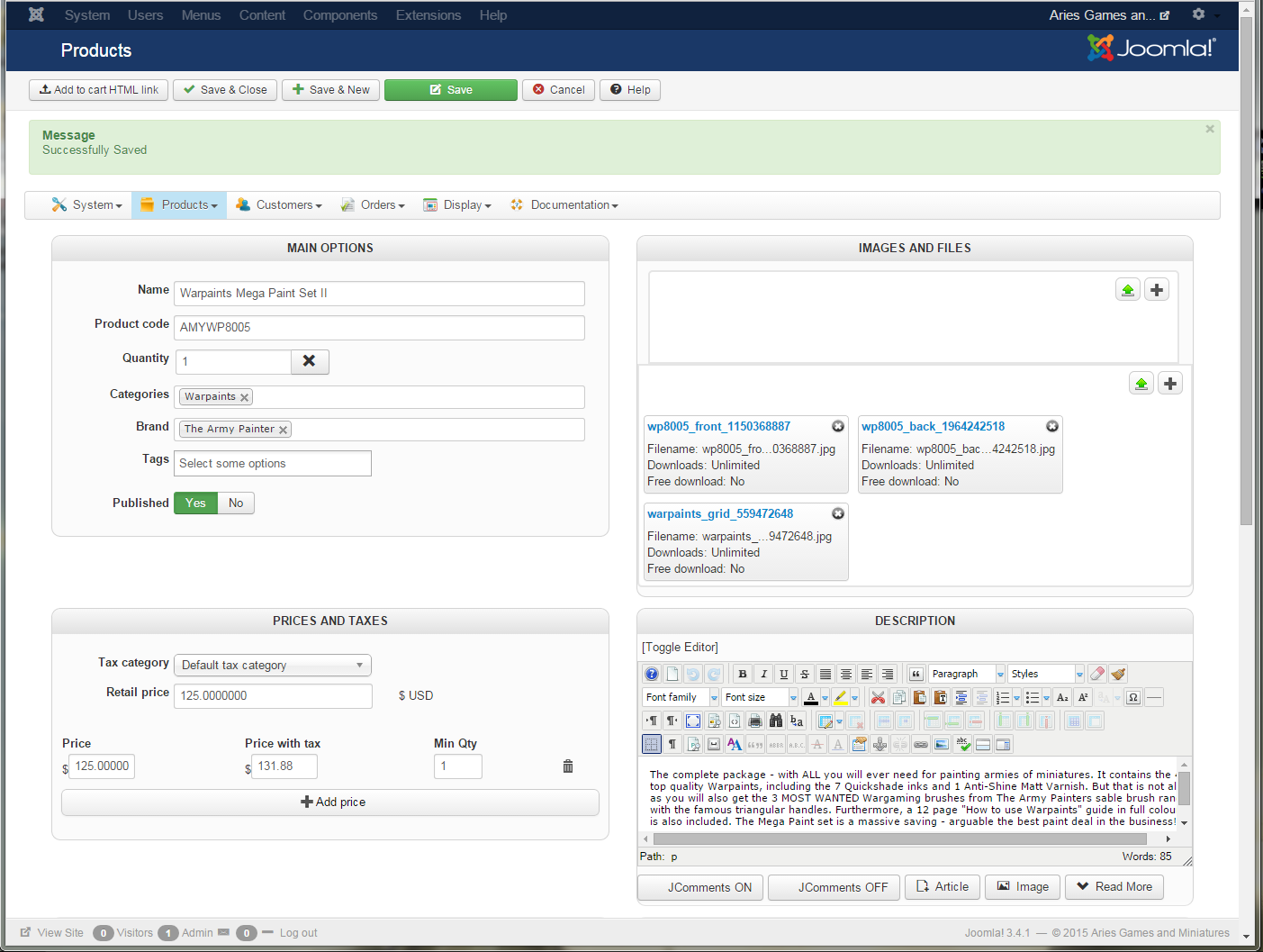

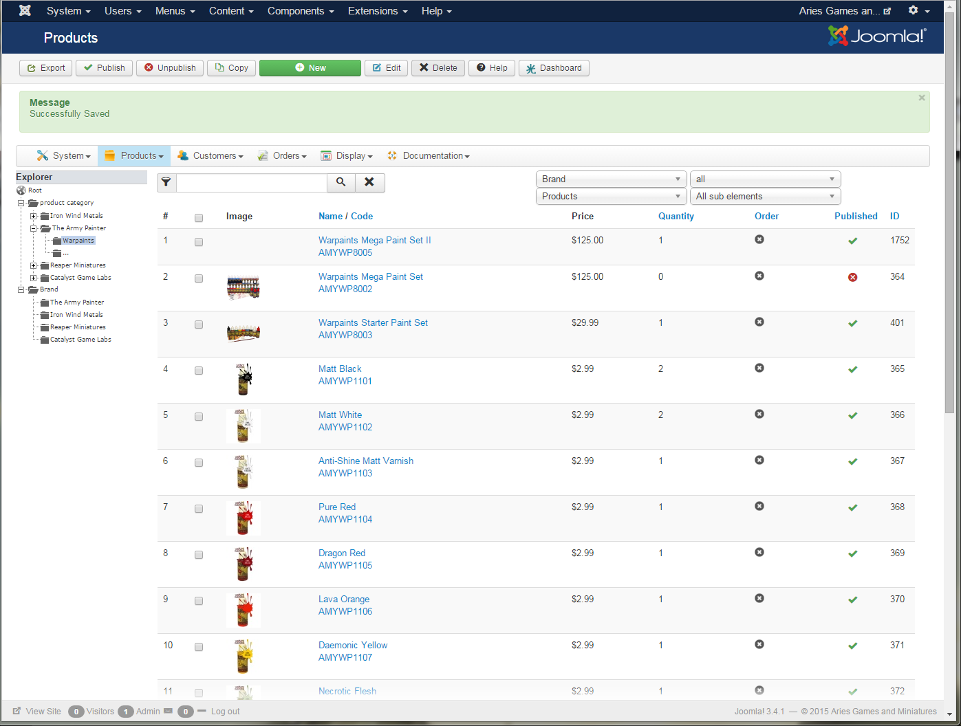

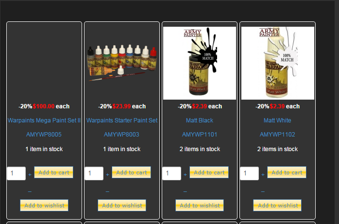

10 years 11 months ago #206109

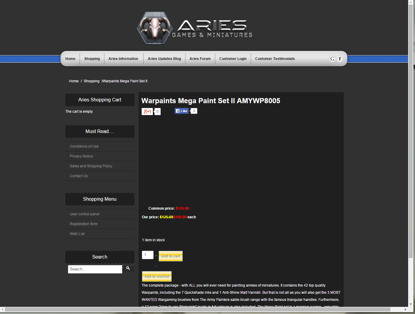

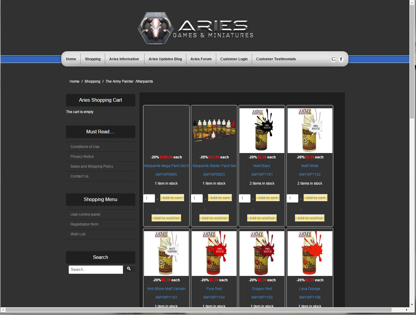

-- Joomla version -- : 3.4.1

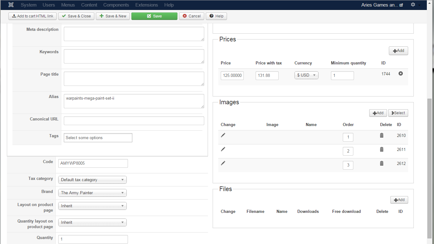

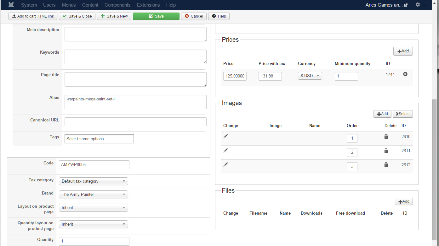

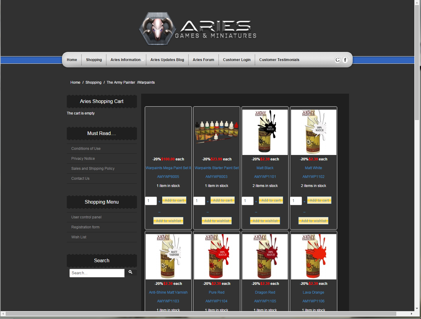

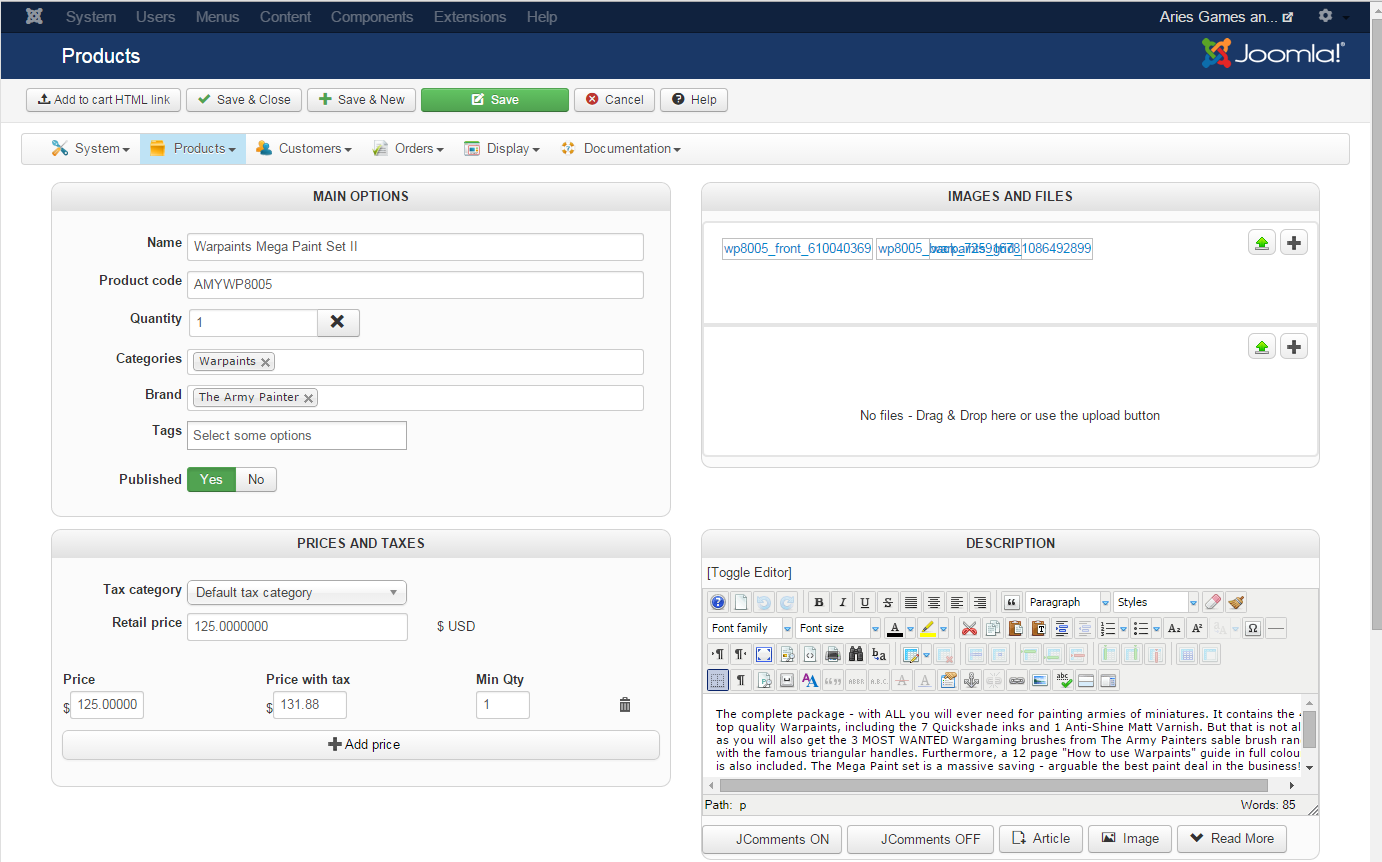

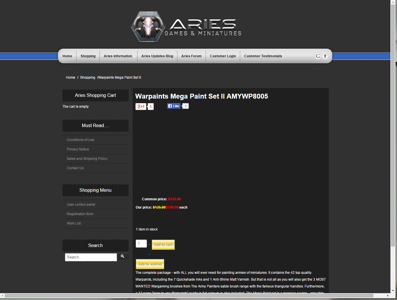

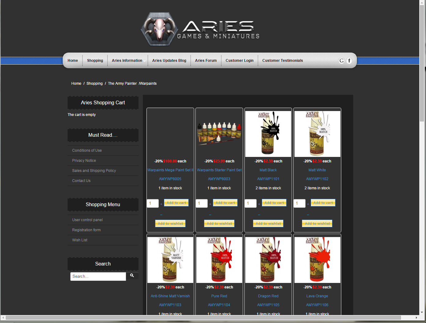

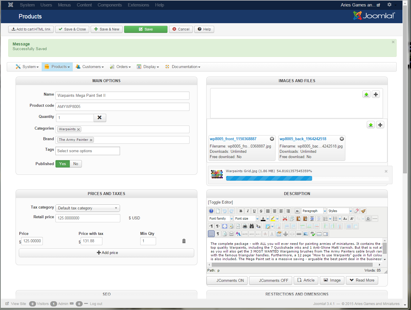

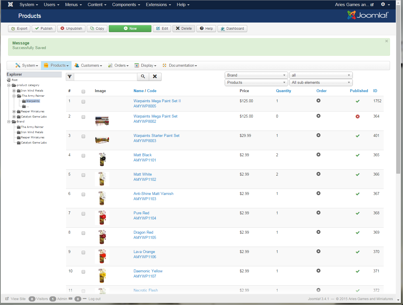

I just got some new stock in, I have added the appropriate images to the listing like I've always done...and now they will not display. Attached is a screen shot of the back end after saving the product, the store display, and the images themselves. Not sure what to do here, I've never had this problem before. When I added the images, I uploaded them directly from my computer, and they were showing when I hit "save & close"...now they don't show at all.

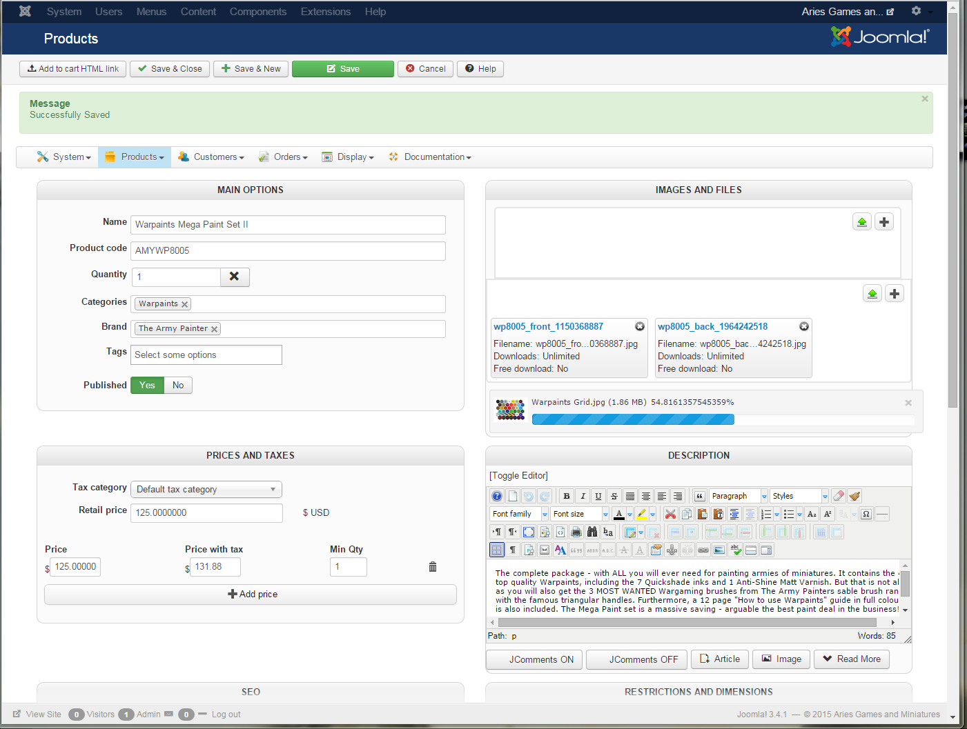

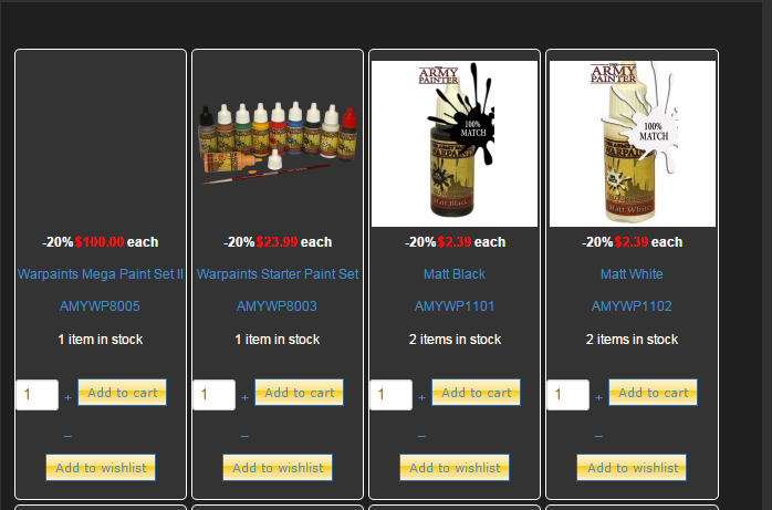

10 years 11 months ago #206400

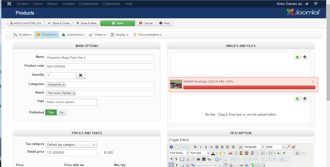

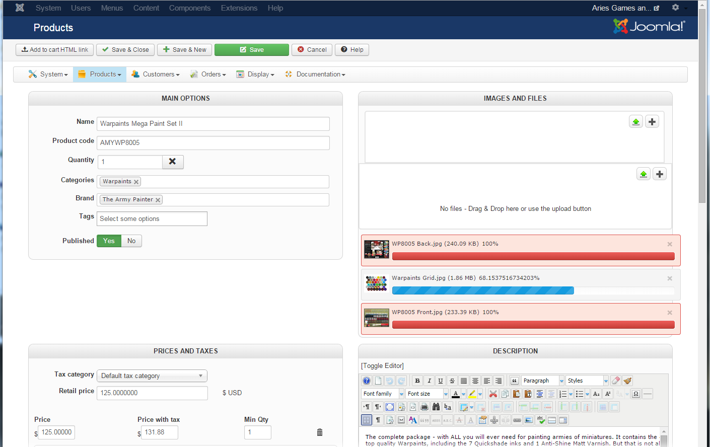

Xavier, just updated to 2.5.0...and still same problem...but congrats on the new layout! I like it...

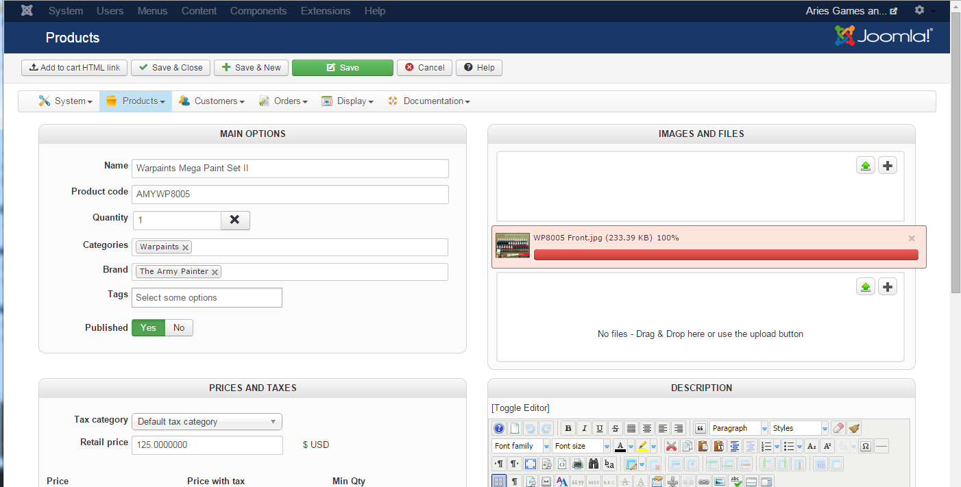

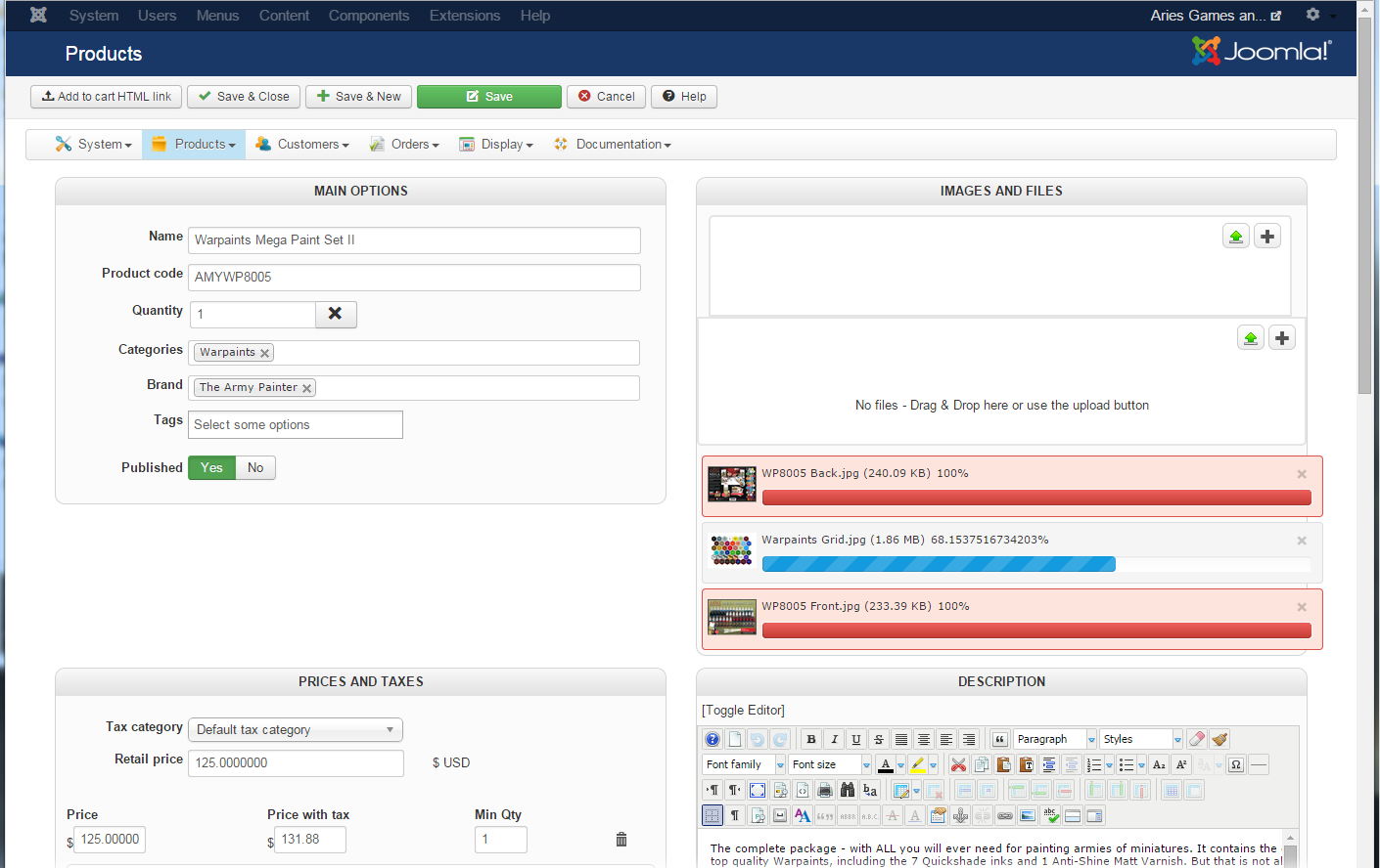

Please see the attached images, one was of the drag & drop upload of 3 images at the same time (took screen shot during 1 of the files still uploading). The other is using a single file in the direct upload selection. Both failed & do not display images on my site.
  • Posts: 85733
  • Thank you received: 14061
10 years 11 months ago #206403
This indicates that the system is not able to save the images in the upload folder.
Check the "upload folder" of the HikaShop configuration (by default it should be either media/com_hikashop/upload or images/com_hikashop/upload). Then, once you know the folder where the images are uploaded, please check with FTP and make sure that the system has the right to write in the folder.

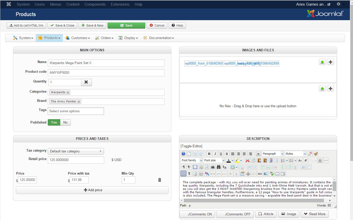

10 years 11 months ago #206439

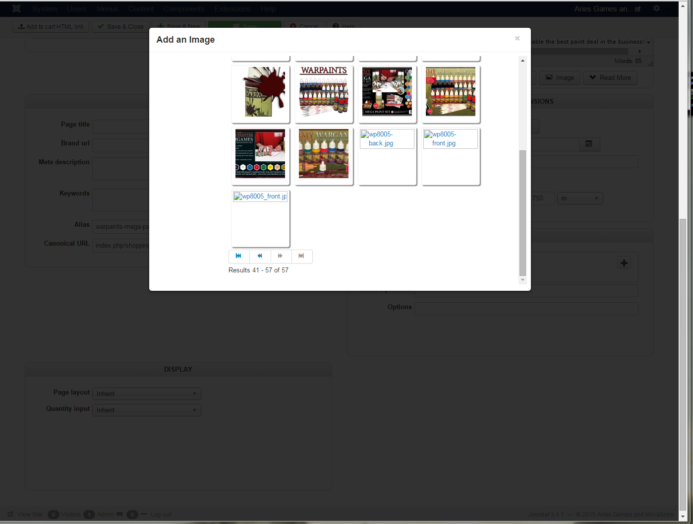

Just for the heck of it, I installed 2.5.0 again via a directory...everything installed fine.

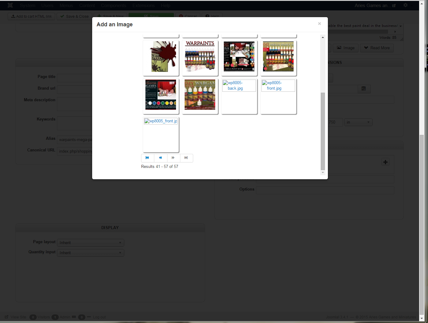

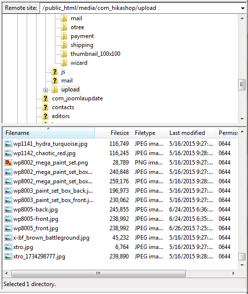

I tried uploading the images again...still not working. Please see attached images.

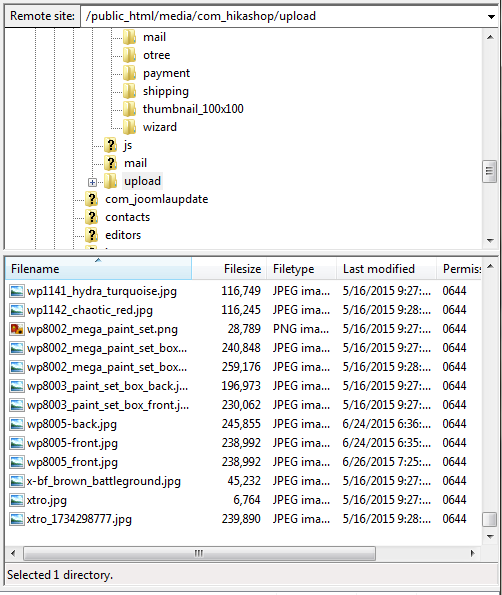

When I try "add an image" from the folder...it shows broken images.
Per the FTP client, they are physically there.

  • Posts: 85733
10 years 11 months ago #206540

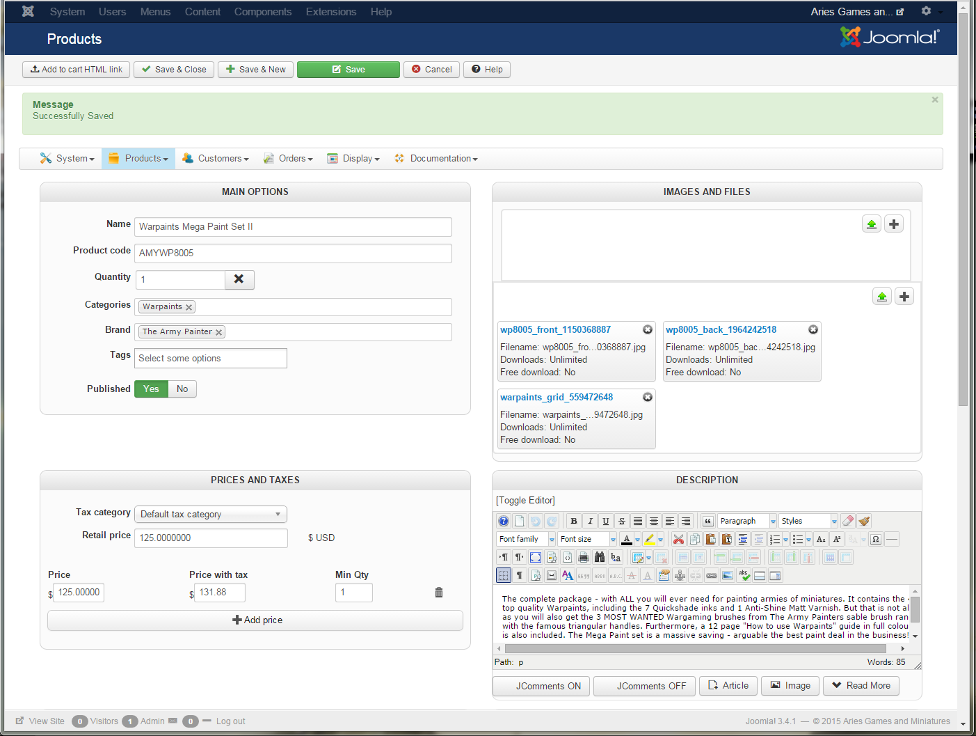

I've done a test with the product you mentioned on your backend and it's working just fine:
take.ms/7vaTH
It seems that you're mistaking the files area and the images area.
If you upload images as files, they are given to the customer after the purchase (like for ebooks, photos, or mp3 sales).
Last edit: 10 years 11 months ago by nicolas.
  • Posts: 713
  • Thank you received: 37
10 years 11 months ago #206542
Oh my gosh...I'm so sorry! I feel like such a moron now.
Thank you for looking into this.
  • Posts: 713
10 years 11 months ago #206543
Ok...I've got to be doing something wrong. I just uploaded using direct, drag & drop, and via FTP...and the images will not show. Please see attached.
It's almost like the link to the image is broken, but when I download them via FTP...they are fine. Is there some sort of size or file type requirement?
The images I am trying to load are also attached.
EDIT - Ok...I just tried changing the .jpg files to .png...and now they show fine.

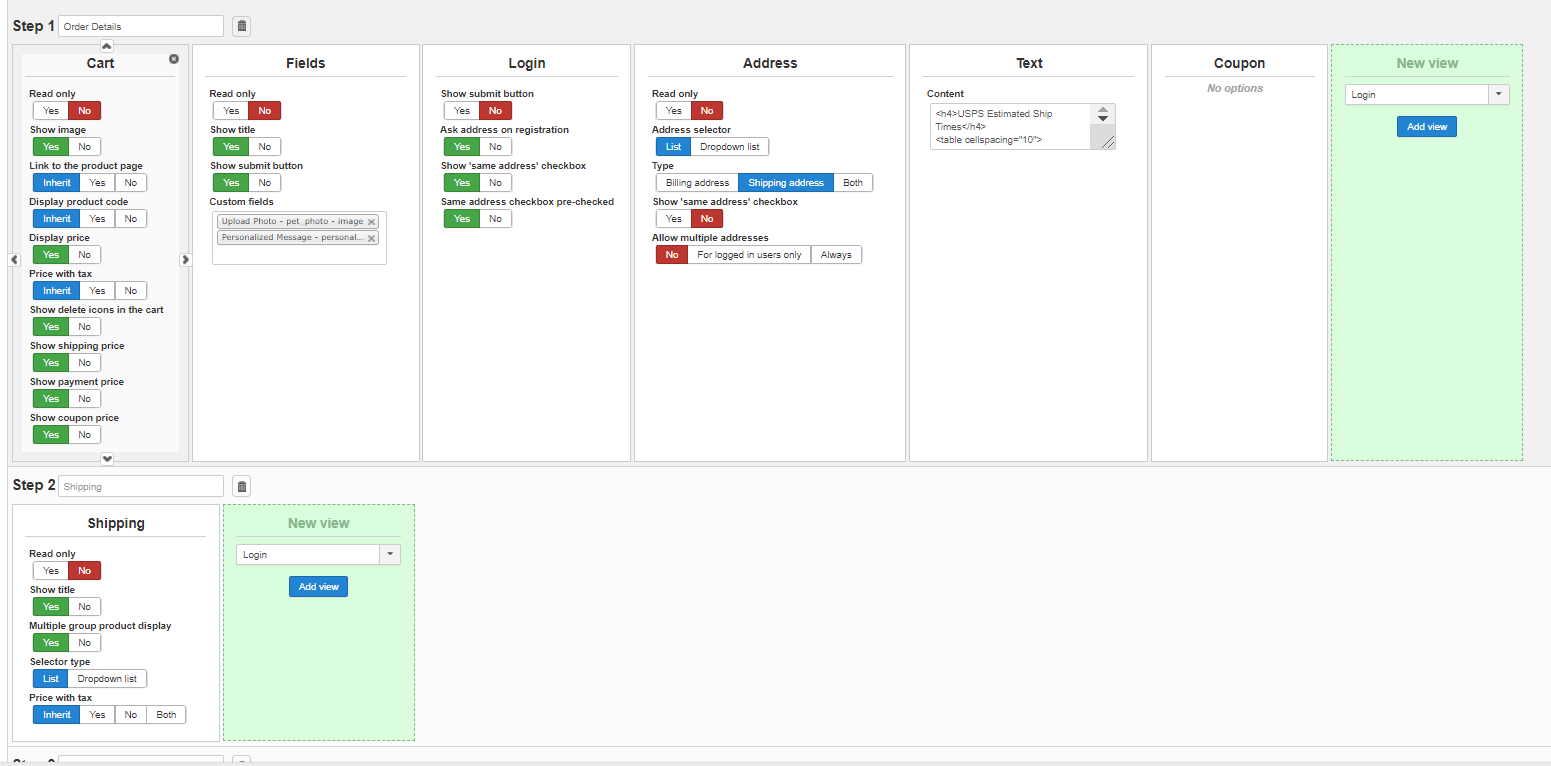

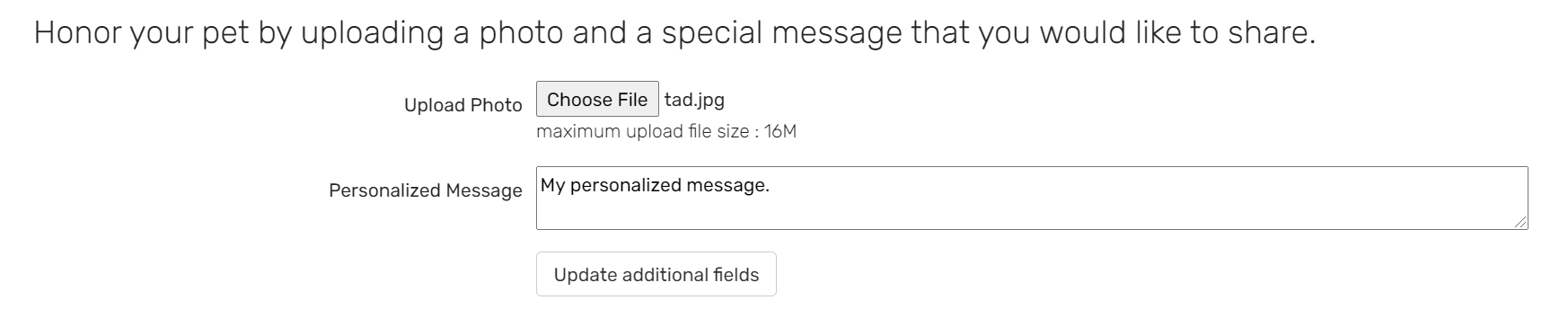

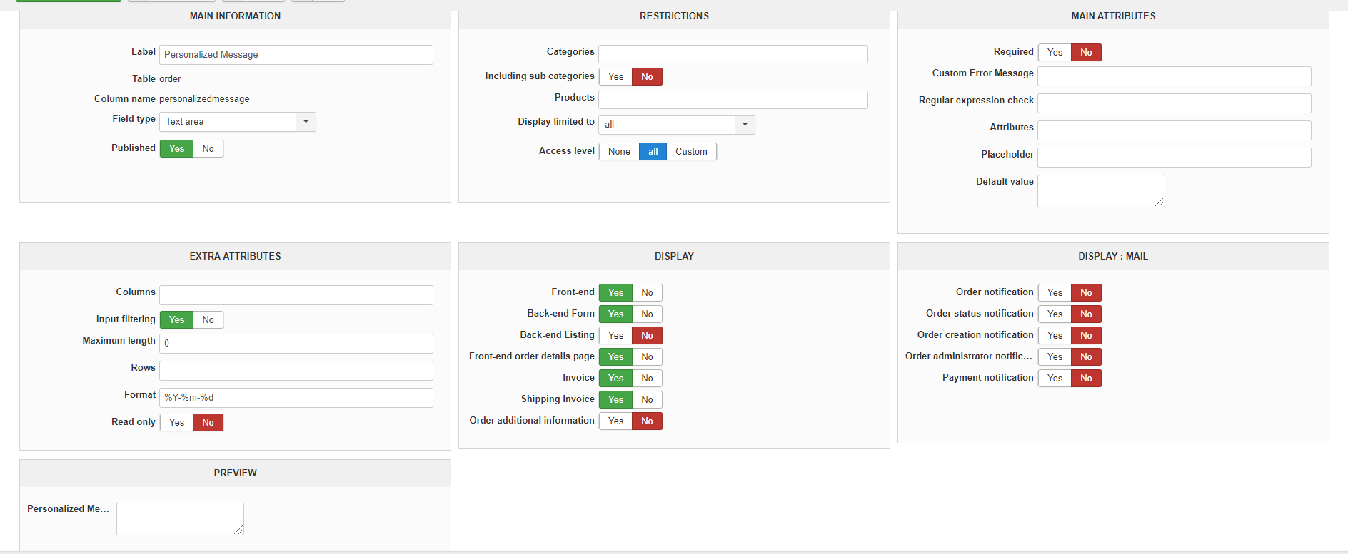

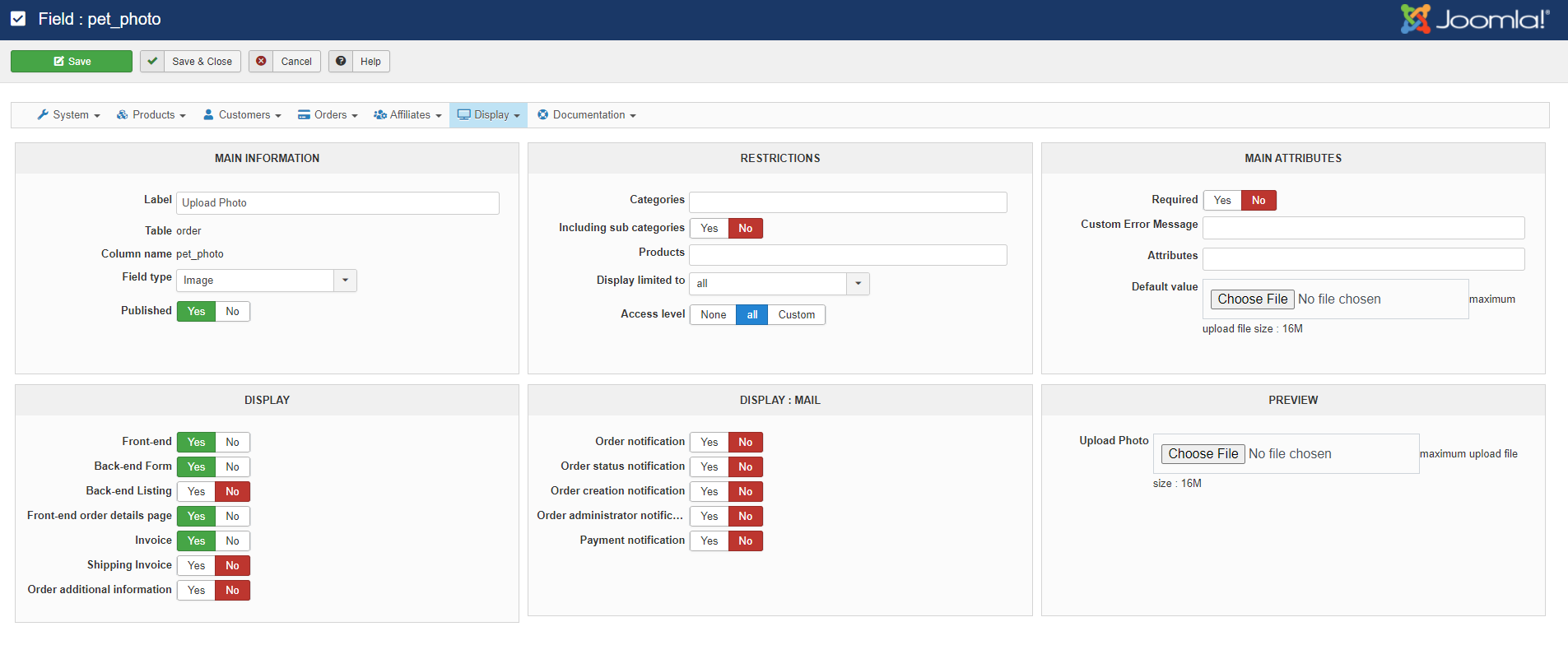

5 years 6 months ago #327559
We are using version: 4.40

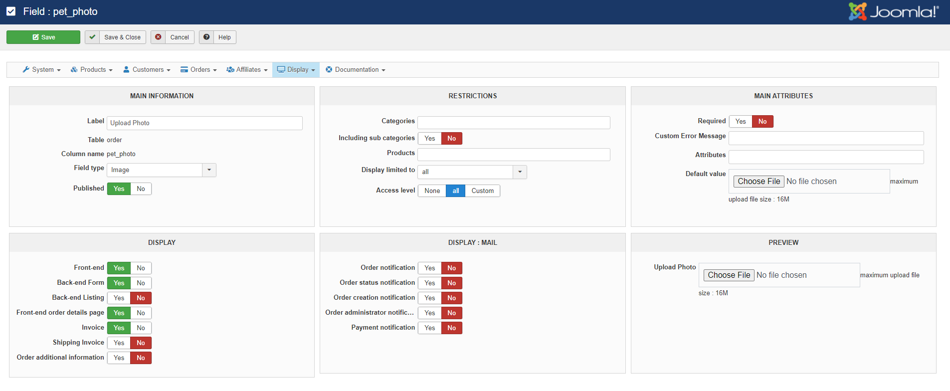

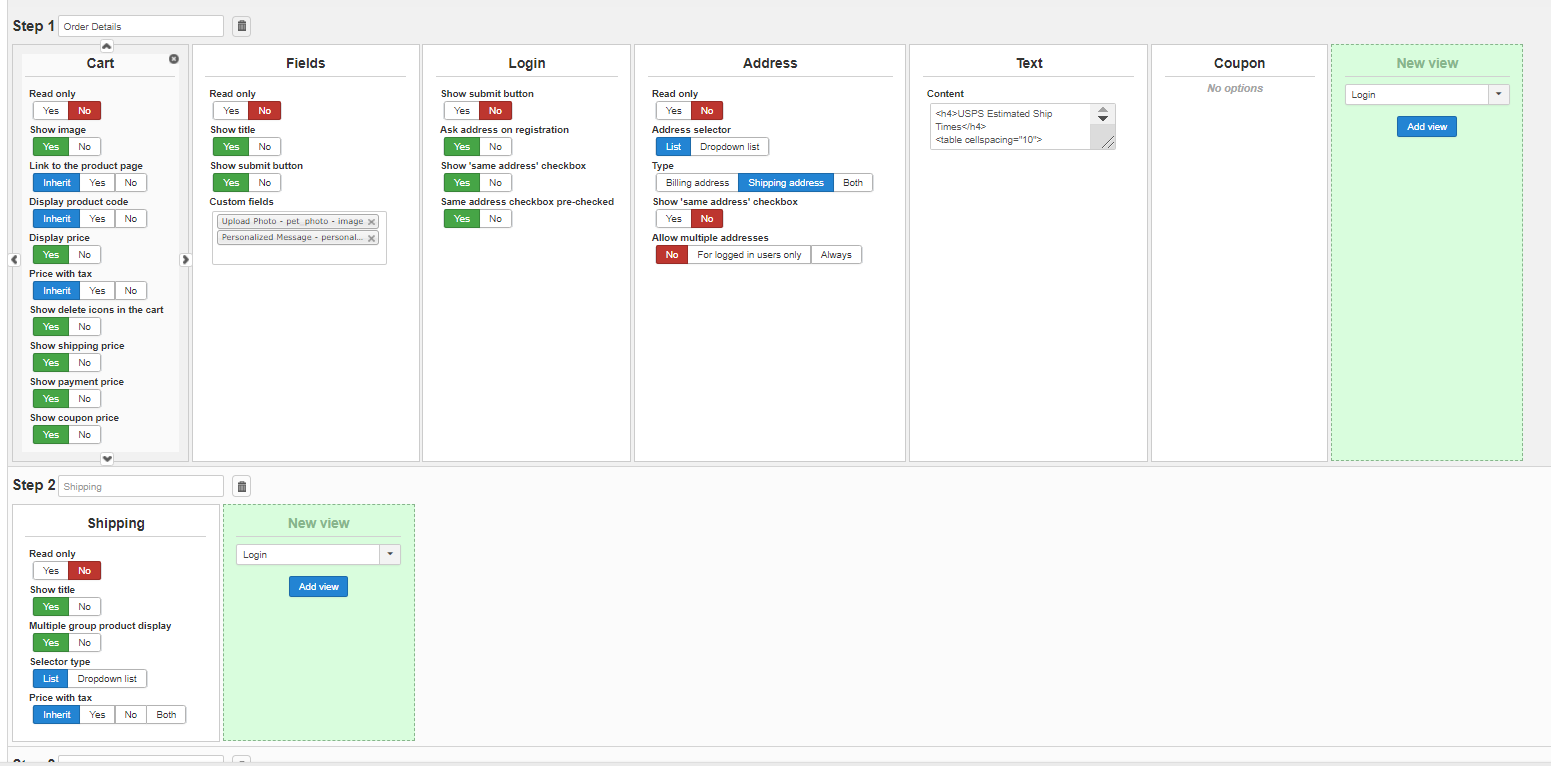

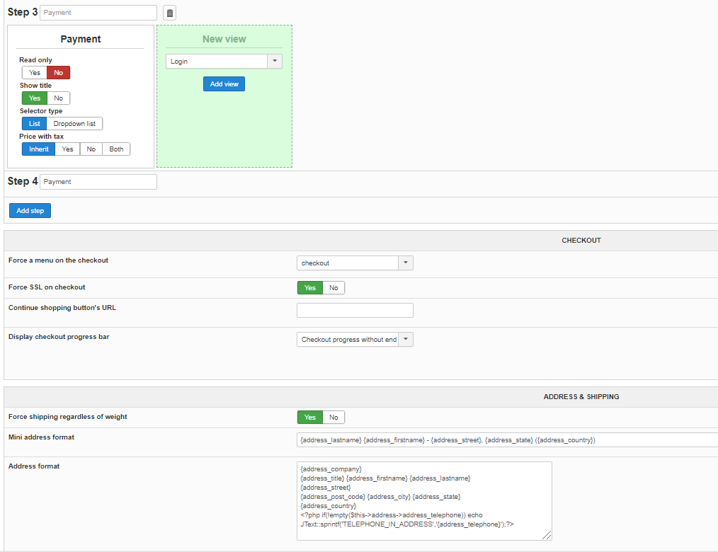

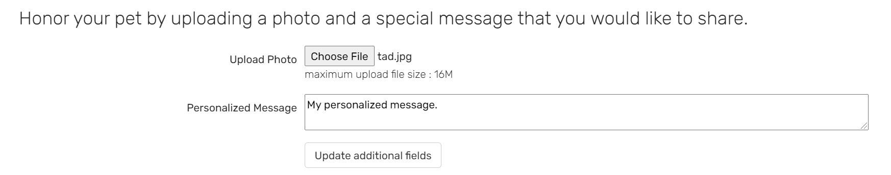

I'm having a similar issue during checkout. I have a custom field that is a file and I've allowed it to be displayed in the custom field settings. I've added the fields in the checkout workflow and enabled the update button. When I select a photo and click the update additional fields, the photo gets uploaded and I see it on the server: /media/com_hikashop/upload/safe
but the photo doesn't display and it blanks out the upload field. I just want the image to display so the customer can see what they are providing on the order.
Any help would be appreciated.

5 years 6 months ago #327570
Can you provide your relative screenshot (custom field & checkout workflow) in order to better understand the context, and an Url link (with the issue).
Awaiting your information in order to progress on your subject.
Last edit: 5 years 6 months ago by Philip.
  • Posts: 62
  • Thank you received: 4

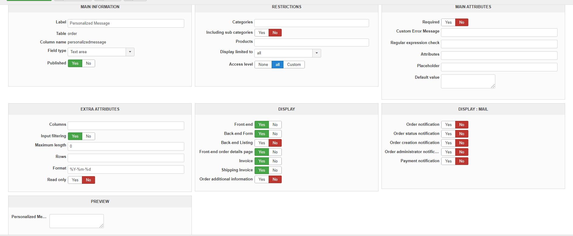

5 years 6 months ago #327583
URL Link for Checkout: griefpets.com/checkout
Perhaps I need to use the custom fields with the products when they add to cart instead of checkout?
I can upload photo and add custom message, but when I click "Update Additional Fields" it doesn't display the image and removes the upload image path. I'd like the customer to be able to see the image that they upload prior to completing the order.
Last edit: 5 years 6 months ago by tadosborn.
  • Posts: 62
5 years 6 months ago #327597
I got it figured out by using the entry custom field table and allowing it to display on the front end. It works exactly as I need now and displays the image after it is uploaded.
It would be nice to understand why the upload image doesn't seem to work if the custom image is on the order table and part of the checkout process.

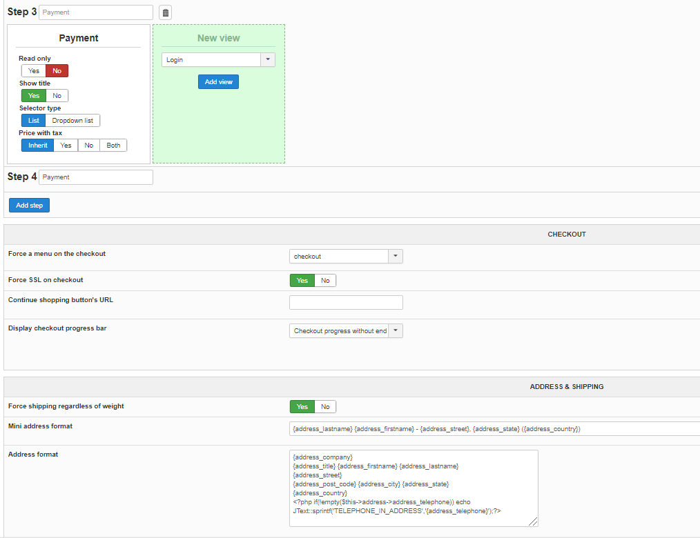

  • Posts: 85733
5 years 6 months ago #327595
Please use the "AJAX image" instead of "image" type and it should hopefully work better.
Also, note that you don't necessarily need the "update additional fields" button. In the "Fields" view of the checkout workflow", you can turn off the show submit button setting to hide it.
That way, the data of the custom fields will be sent to the server when you click on the "next" or "finish" button at the bottom of the page.
