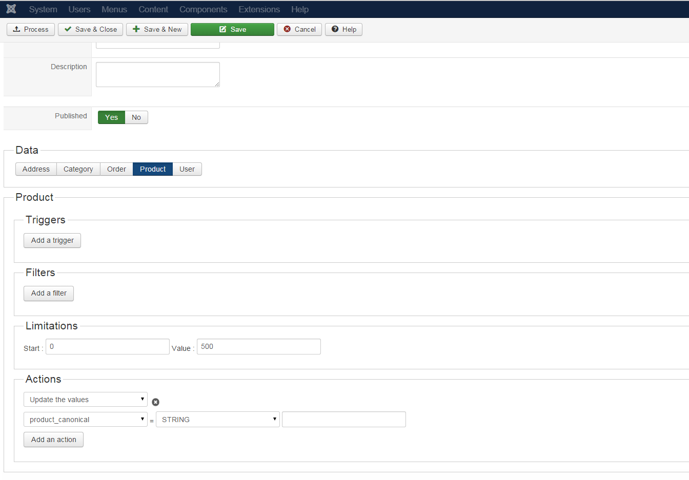

This is configuration of mass action:
I'd like to empty all canonical URLs and then to set the "force canonical URLs on listing" in "use canonical URL and generate it if missing" but I'd want to avoid correct them one by one by hand :( :(
  • Posts: 92
10 years 4 months ago #240673
I'm really stupid :oops: :oops:
I just realized my blunder: I did not change value in "limitations" and mass action just deleted first 500.
Thanks and sorry
