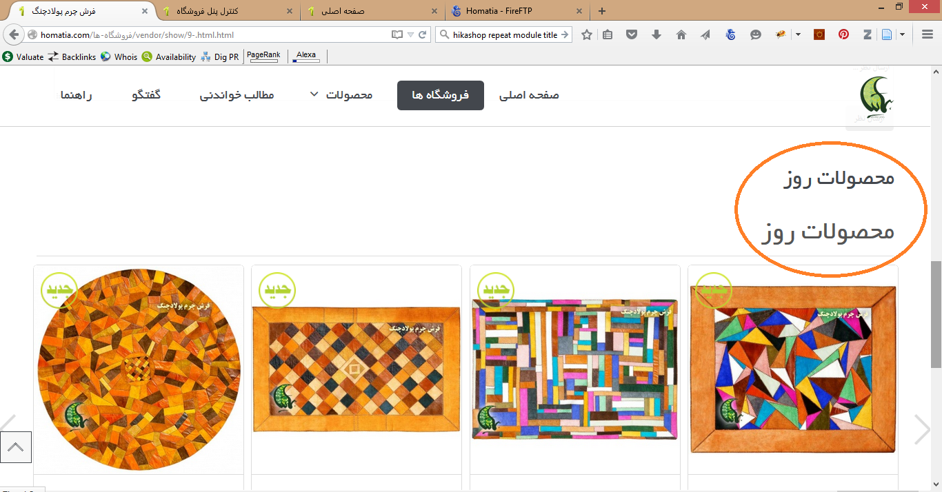

-- Joomla version -- : 3.4.3
In Vendor Page, hikashop modules' titles display twice. See the attchement.
I don't have this problem in any other pages. I even don't have this problem with other modules (non-hikashop) in Vendor Page.
Why this happened? How can I solve it?

10 years 11 months ago #208827
It would seem to come from a customization of the view files of the "product" view, not something in standard in HikaShop.
The simplest will be to add such CSS on your website:
#hikashop_module_140 h2{ display:none; }

10 years 11 months ago #209006
Thanks Nicolas.
Your CSS suggestion solved the problem.
