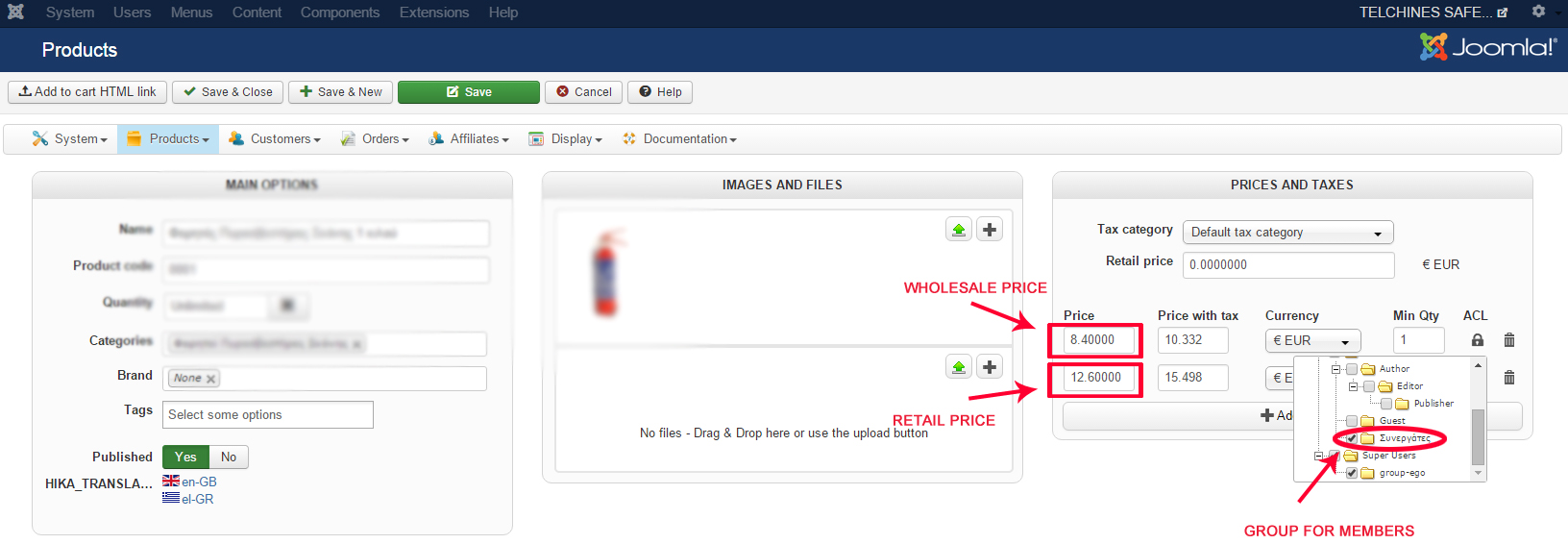

1)First, how can i display two prices of a product? I don't want to use retail price field because the user doesn't have the option to add to cart a product with the retail price.
I have two kinds of users: simple customers and members.
So i want the members to be able to see and purchase products with both prices, but the simple logged or not logged users can see and purchase only with the retail price, the wholesale price will not be visible to a simple user.

Thanks Nicolas, but i have already done that!
1)I have set the acl of each price, I have also set the price display method to "all" but i still see no second price.

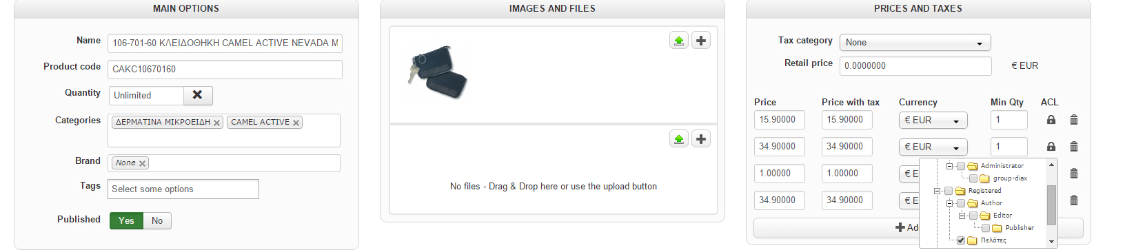

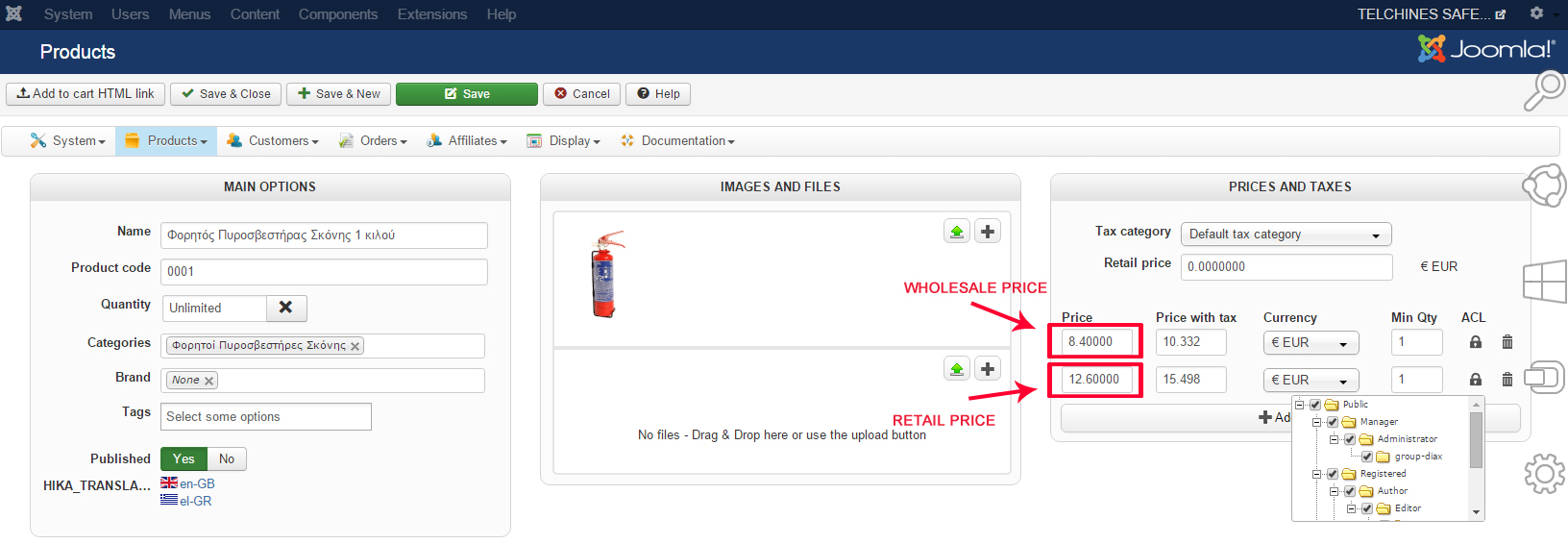

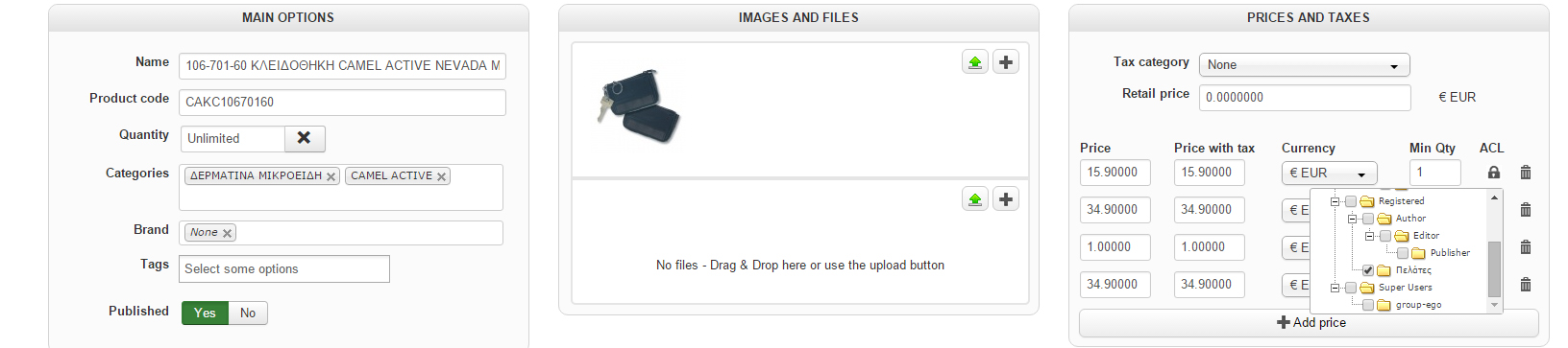

Hello Nicolas, here are the screenshots of the prices ACL.
