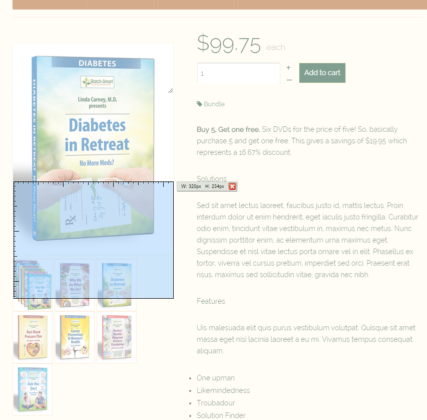

I am wondering if you know if the seven small preview images on this page just below the product page image have their size determined in HikaShop or within the template. I have been trying to find a setting. I would like to increase the size of the seven small images to that three of the images would end up lining up with the left and right edge of the larger image.
I am attaching an image here with you can see that the main product image is 320 pixels wide. I would like the width of the three columns total to also equal 320 pixels. I am wondering how I might get control of this?
Here is the page: www.veggievore.com/dvd/six-dvd-bundle
I actually believe that I can do it with a css fix but am wondering if there is a configuration option instead?

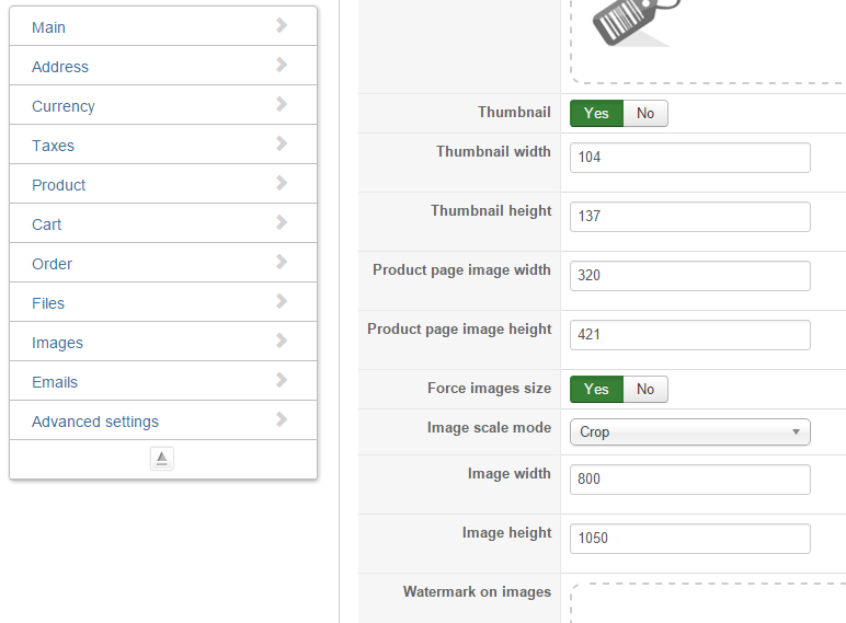

Thank you very much for the reply. My template provider believes these settings are with HikaShop and not the template. I have changed the width and height of the thumbnails in the System->Configuration->Main->Images section as you suggested.
I have set the Thumbnail width to be 104 pixels and the Thumbnail height to be 137 pixels.
But, the images being served are much larger. I reduced the size of the images via the Product page image width settings and now the images are not quite as big but for some reason the settings for Thumbnail width and Thumbnail height seem to not be working. Those images are the same actual size as the product page images but are displaying within a different grid size.
I have attached an image of my settings.

It seems Xavier didn't understand that you were talking about the thumbnails of the images of the product on the product page.
These are indeed only controlled with CSS.
They are indeed the same size as the main image display on the page. That allows for an instantaneous refresh of the main image display when you hover on them (instead of having to wait for the bigger image to load).
