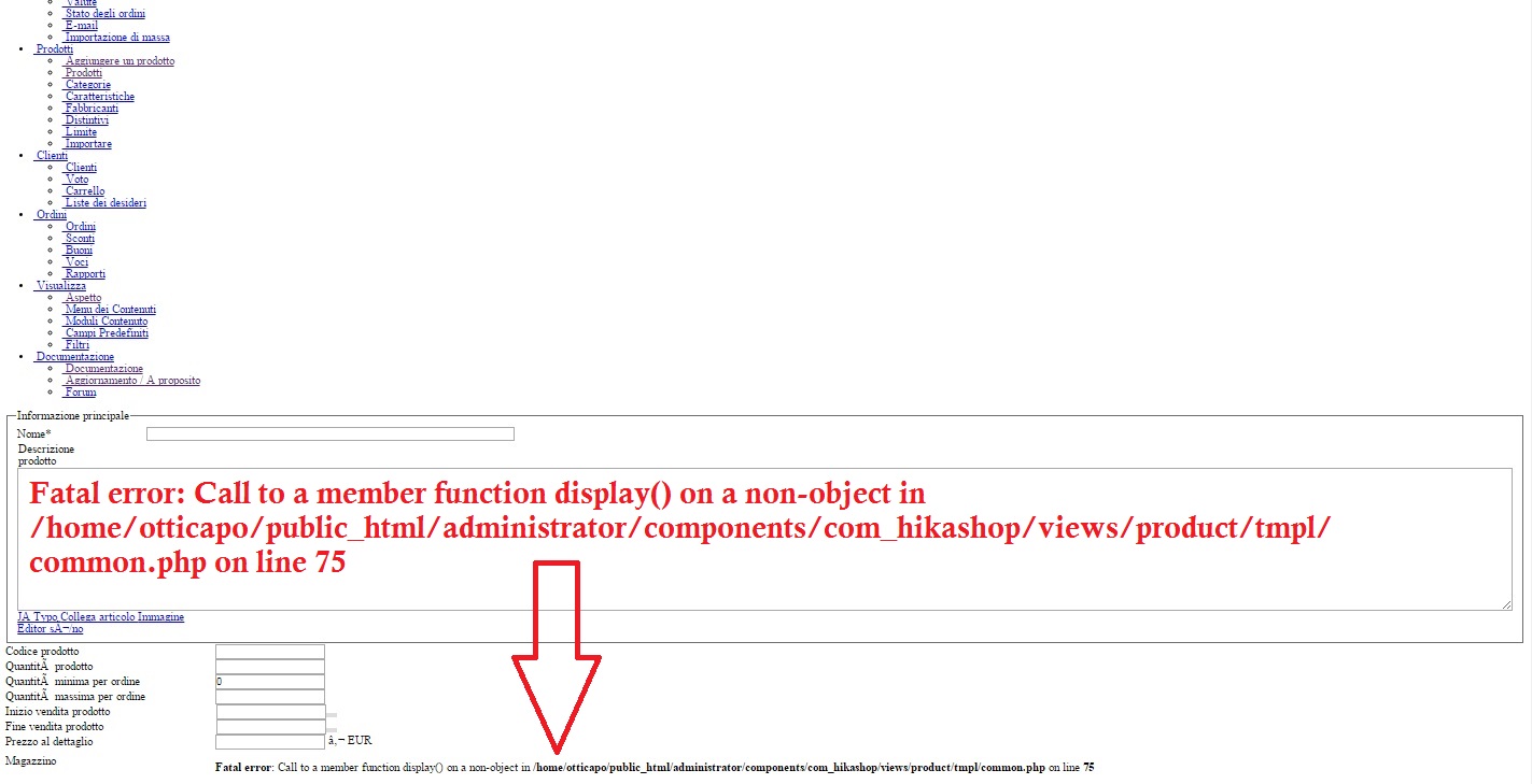

-- Joomla version -- : 3.4.3
-- Error-message(debug-mod must be tuned on) -- : Fatal error: Call to a member function display() on a non-object in /home/otticapo/public_html/administrator/components/com_hikashop/views/product/tmpl/common.php on line 75
sorry for my bad English
the website and the component works fine
the administrative works fine
the administrative side component does not give me no problem, except when I want to add a new product, the form opens as the image and gives me the following error: Fatal error: Call to a member function display () on a non-object in /home/XXXX/public_html/administrator/components/com_hikashop/views/product/tmpl/common.php on line 75
so far I have done the following:
I changed template
I disabled the latest components installed
I reinstalled the current version of hikashop
but not 'change anything, I always error and I do not know how to fix, I do not understand how to fix it. Thanks for your kind availability

I think that you should have some override for the backend product edition because you should see that view anymore in HikaShop 2.5.0

I tried to:
- Overwrite template entirely administrative isis
- I have no customization

problem solved!!! :)
isis - product - form ... previously modified and now restored. :blush:
