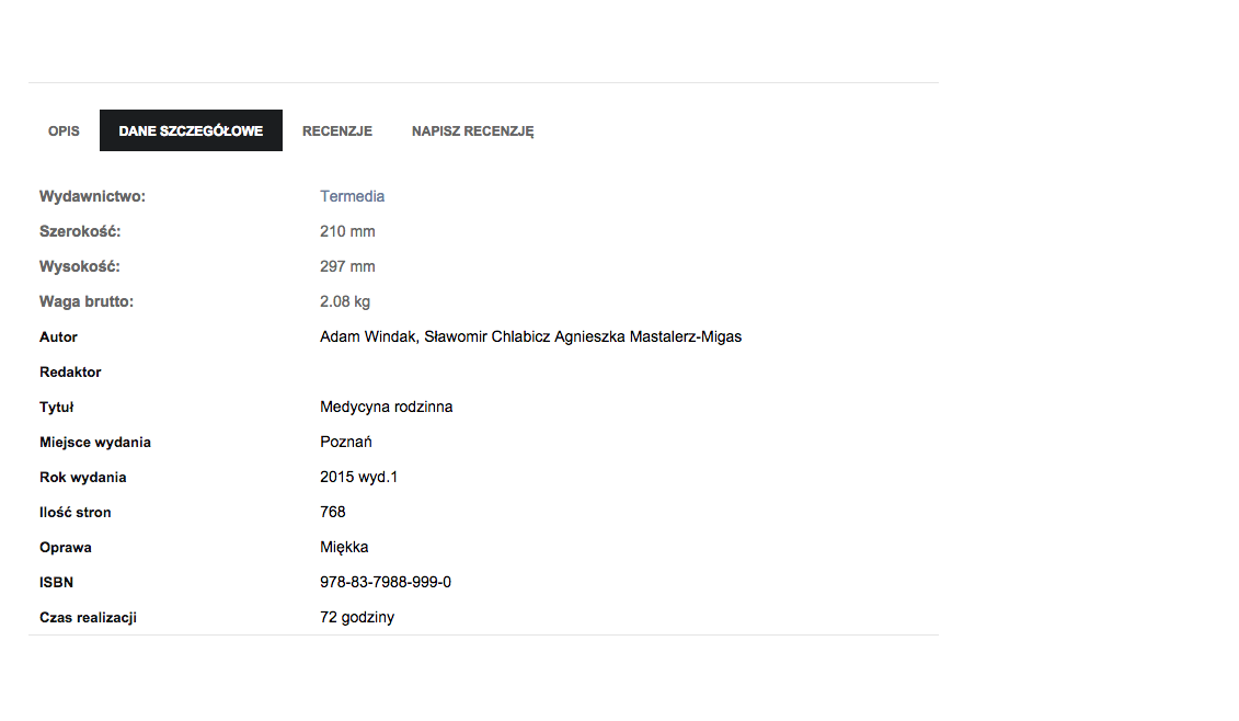

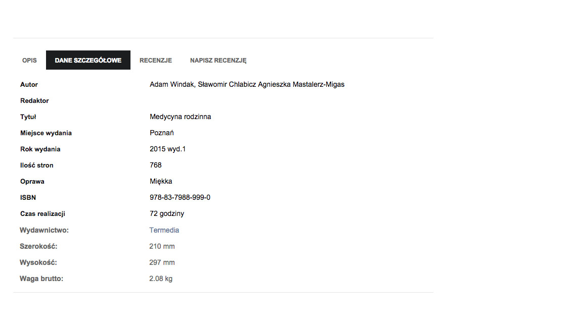

How to change the existing order of fields in the data sheet.
It is the weight, width, length, height, manufacturer
And it should be: the producer, width, length, height, weight
Then how to change the information block
Is: a block with dimensions, then a block of the user fields
And it should be: a block of fields username, then the block with dimensions

  • Posts: 194
  • Thank you received: 15
10 years 10 months ago #209928
Thank you for your answer,
I read this guide, there is no solution to the problem, which I have tried to describe :(
10 years 10 months ago #209945
You have to edit the view "product / show_block_dimensions" to change the order of the dimensions and the manufacturer.
Then to display the custom fields before the dimensions, in the view "product / show_default" move the block
	<?php
		//LAYOUT show_block_dimensions
		$this->setLayout('show_block_dimensions');
		echo $this->loadTemplate();
	?><br /
After:
	if (!$this->params->get('catalogue') && ($this->config->get('display_add_to_cart_for_free_products') || ($this->config->get('display_add_to_wishlist_for_free_products', 1) && hikashop_level(1) && $this->params->get('add_to_wishlist') && $config->get('enable_wishlist', 1)) || !empty($this->element->prices))) {
		if (!empty ($this->itemFields)) {
			$form = ',\'hikashop_product_form\'';
			if ($this->config->get('redirect_url_after_add_cart', 'stay_if_cart') == 'ask_user') {
				<input type="hidden" name="popup" value="1"/>
			<?php
			//LAYOUT show_block_custom_item
			$this->setLayout('show_block_custom_item');

How to move blocks of information about dimensions and block the user from fields?
10 years 10 months ago #210134
Please illustrate what you need with a screenshot, because a solution was given in one of my previous posts but it seems to not be what you are looking for ;)
  • Posts: 194
10 years 10 months ago #210245
Thanks for your response
Previous Your suggestions were unsuccessful.
This is the product page now:
And so it should look like.
I would add that it is a template Gavick-and Storefront ;)
  • Posts: 85788
  • Thank you received: 14079
10 years 10 months ago #210250
You 're apparently using the "tabular" layout of the product page and thus, instead of editing the file "show_default", you need to edit the file "show_tabular" and do the same changes there.
Then it will work.
