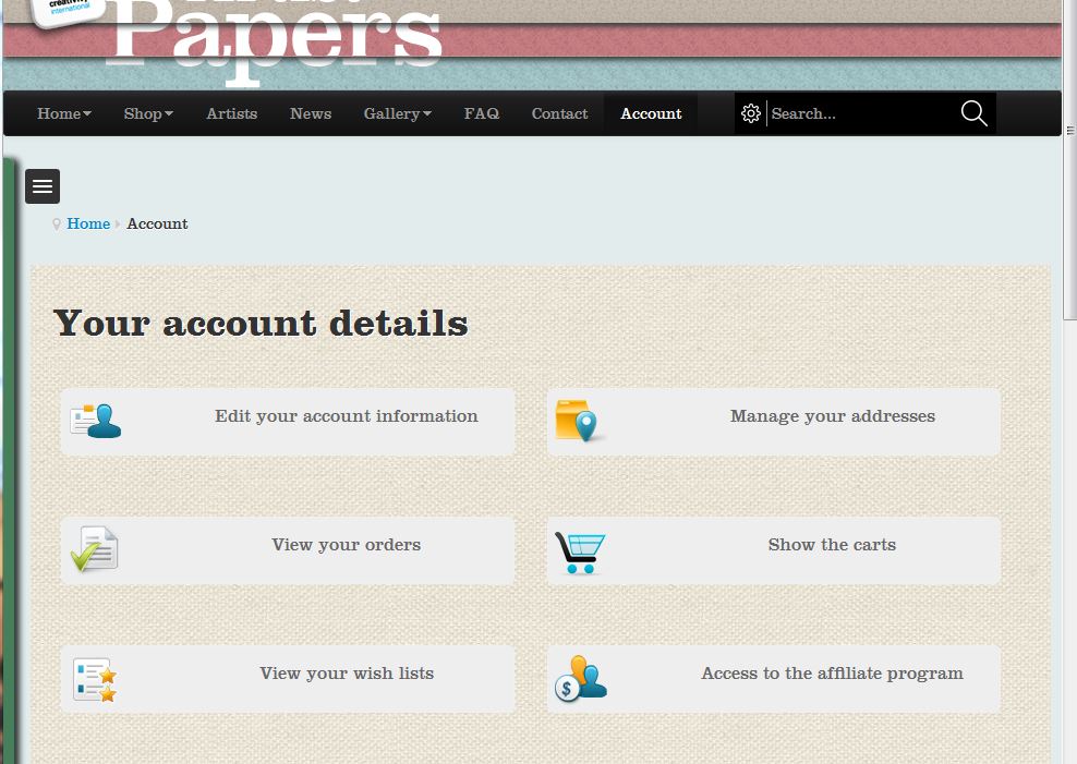

10 years 9 months ago #214151
I have discovered that this new router.php breaks access to my affiliate control panel.
I have configured access to the hikashop user panel under a menu item called "Account". With the old router.php clicking on the "Access to the affiliate program" button brings up the affiliate settings page wiith a url of account/affiliate .. so far so good.
If I put in the new router.php the weirdness I reported earlier is fixed but I now get a 403 error trying to access the affiliate panel.
Ian

  • Posts: 250
  • Thank you received: 7
10 years 9 months ago #214204
I am accessing from the "Account" page URL www.artistpapers.co.uk/account
With both routers the URL for the "Access to the Affiliate program" option is www.artistpapers.co.uk/account/affiliate which is what I would expect.
With the original router this link works, with the modified router I get a 403 error.
Thanks,

  • Posts: 250
10 years 9 months ago #214300
Brilliant, thank you Nicolas that seems to have fixed it.
That code occurs in two places and I have replaced both occurrences, I assume that's correct.
