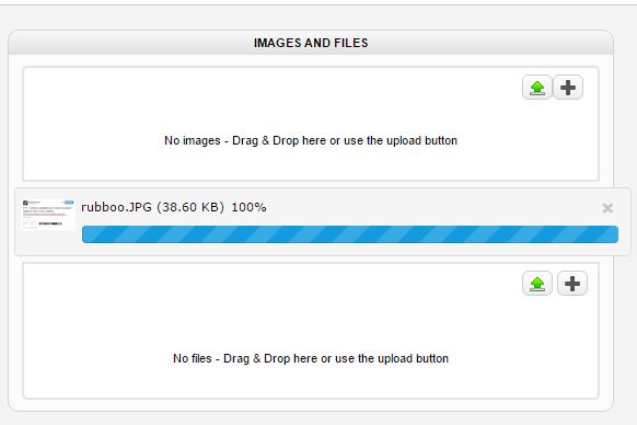

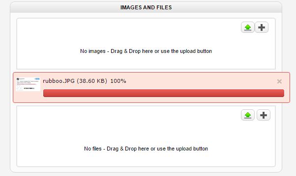

hola amigo, tengo problemas para cargar la imagen del producto, aparece cargando pero no carga nada, ya asigne permisos 777 a las carpetas de upload y thumbnails, tengo joomla 2.5, algun consejo adicional para resolver este problema?
Hello hikashop friends, I have trouble charging the product image, shown loading and show a little image but not save and display anything, I check and assign permissions 777 to folders "upload" and "thumbnails", I have joomla 2.5, some advice to solve this problem?

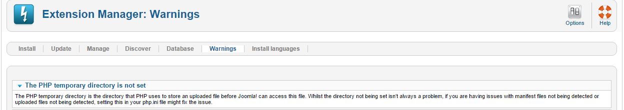

I try to fix php warning but I can fix, I create the file php.ini with the next line:
upload_tmp_dir = /usr/local/pem/vhosts/163706/webspace/httpdocs/wilsoftapp.com/tmp

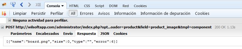

I haver the next error in console mode when I upload the image:
opload.js?v=250 (línea 250)
[{"name":"board.png","size":0,"type":"","error":6}]
POST http://wilsoftapp.com/administrator/index.php?opt...oader=product&field=product_image&tmpl=component

The return gave an error with the error code "6".
According to the PHP documentation ( php.net/manual/en/features.file-upload.errors.php )
UPLOAD_ERR_NO_TMP_DIR
Value: 6; Missing a temporary folder. Introduced in PHP 5.0.3.
So your tmp folder is not configured properly.
