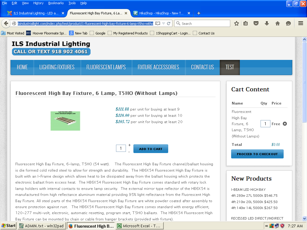

when i input a price range "Min Qty" eg: 9 , its charging 0 unless they select 9, not what I am wanting.
i want it to charge the set price for 1-9 items,
then a set price for 10-19 items
ilsindustriallight.com/index.php/test/pr...p-t5ho-without-lamps

Regarding your screenshot, your configuration is incorrect ; the min quantity is the minimum quantity needed to unlock the price.
So please provide a screenshot of your product price configuration.

Seems you've set your pricing wrong, starting with $111.88 for minimum 9 units. Instead you should make that $111.88 for minimum 1 unit. The rest looks ok in your screenshot.
