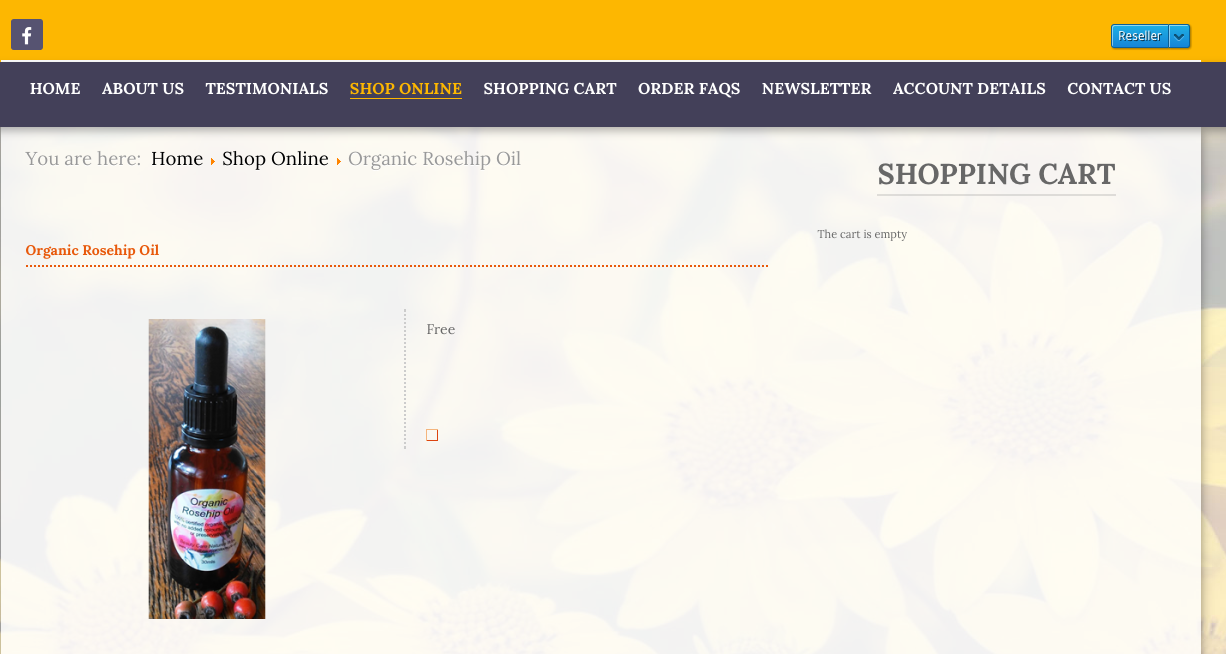

I have set up an ACL group called RESELLER and have also added in special pricing on each product. In the ACL list for that pricing only the RESELLER group is selected.
When someone who is in the ACL group RESELLER logs in to the front end the price on the products is now shown as "FREE". The RESELLER price is not shown and there is a check box where the pricing should be.

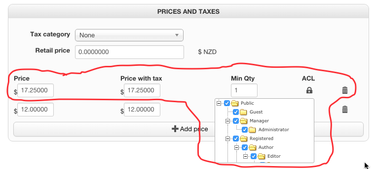

On the main price, the ACL group RESELLER is unchecked.

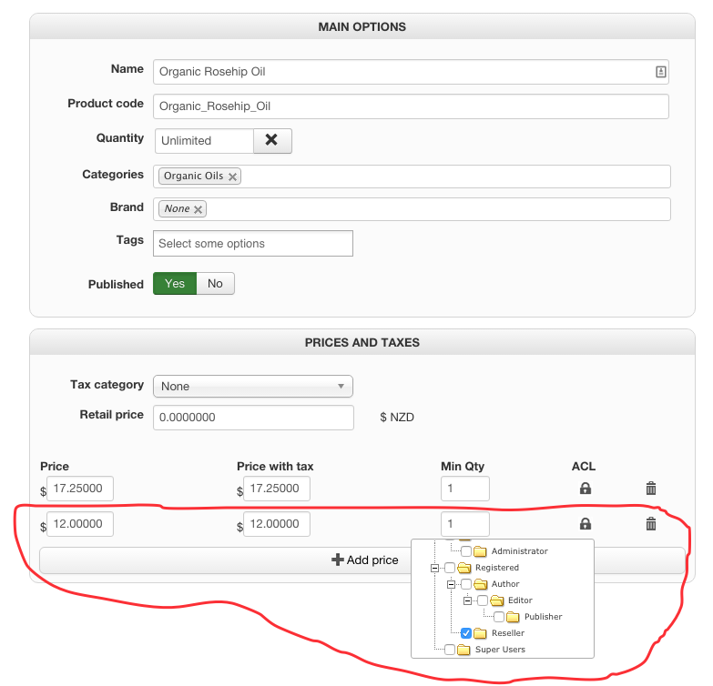

On the 2nd price, the ACL group RESELLER is checked and all others unchecked.

Could you provide a screenshot of the settings of that product and of the prices "ACL" for each price so that we can better understand the situation ?

Since you are a PUBLIC you are seeing the correct PUBLIC price.
Here is the ACL for the first price. This is PUBLIC and is working.
Here is the ACL for the RESELLER price. This is NOT showing to anyone in the RESELLER ACL group.

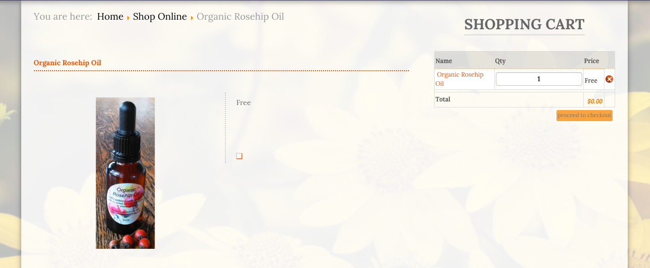

When a RESELLER logs in, this is what they see. Please note the user in the top right.

Please download again the latest version install package on our website and install it on yours. That should add a patch in order to fix that issue with the configuration of the prices ACL not adding the correct data in the database (so you'll have to reconfigure the prices ACL and save the product to see the change)

Thank you.
The ACL prices are working now.
