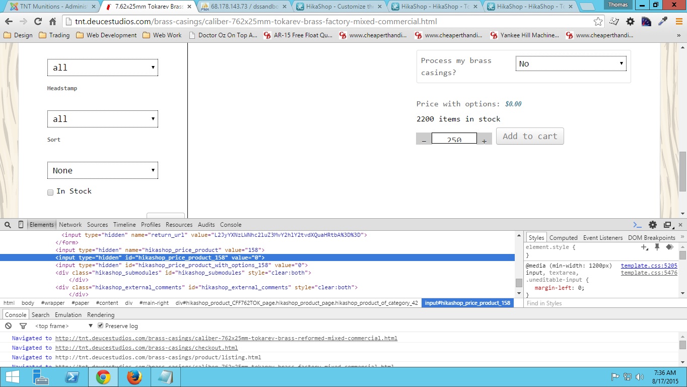

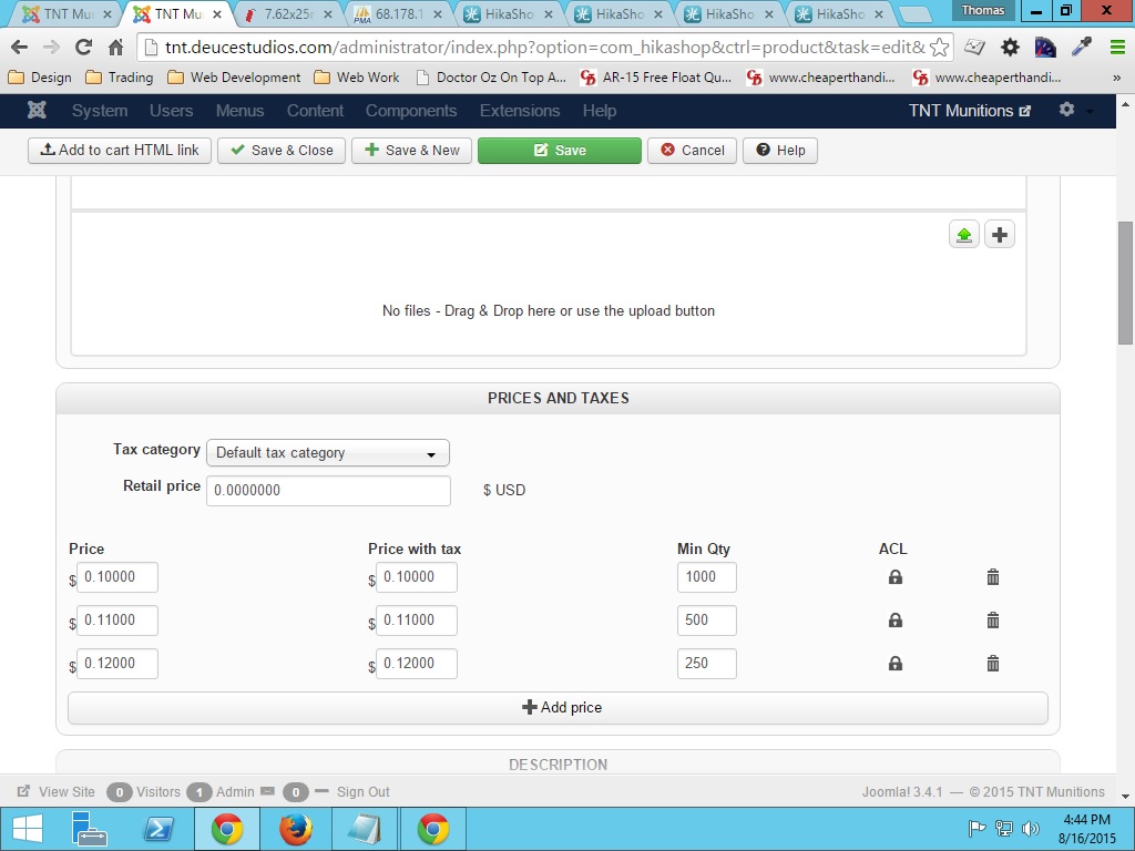

I have created a product that has multiple prices based on quantity (see attached screenshot). I have found a way to display the prices based on the minimum quantities instead of per unit by editing Hikashop->Display->Views->product/listing_price.php where it has:

So, am I correct in assuming that at this time a customer cannot see the total price of the quantity and options they have selected for a product before adding it to the cart? If so, what does the javascript function "hikashopChangeOption()" do?
edit: I just did some digging and I noticed that the input id="hikashop_price_product_158" value="0" (see attached screenshot).
I think this may be part of the problem because I would think the value should = 0.12. Am I wrong?
Last edit: 11 years 4 weeks ago by deuce4884. Reason: noticed something in code

  • Posts: 128
11 years 4 weeks ago #211764
The hikshopChangeOption function is not summing correctly for the product in question and I believe it is because of what I mentioned above.
For some reason the appropriate unit price is not in that input's value. Sorry to be such a bother but I really need to figure out a way to make this work and update based on quantity and option. Your help is greatly appreciated.

As I said, the system uses the unit price. As you didn't enter any on your product, you get that result.
Add a new price line with a min qty of 1 in your product and you'll see that the system will take it.
If you want to change the code there to use another price_min_quantity, you can do it, but again, the system isn't made to update the base price when you change the quantity of the product, so even though it might be a bit better it won't be perfect on your website with the way your products are configured.
