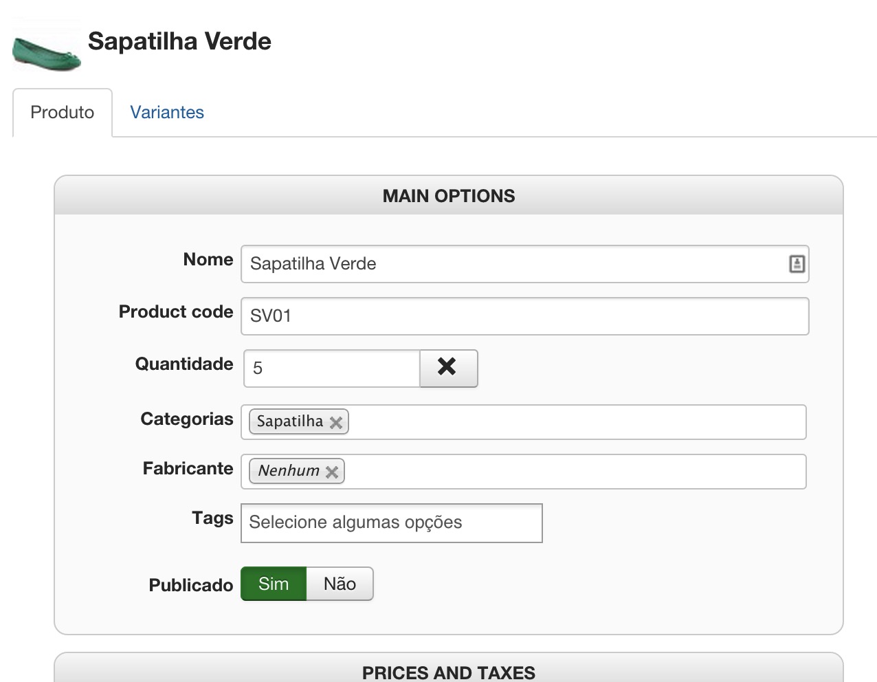

but button notify when is available is set for all product, other product don’t have option to buy.
Can you give me more information about the issue that you are having and about how you configured your product and its variants through some screenshots for example ?

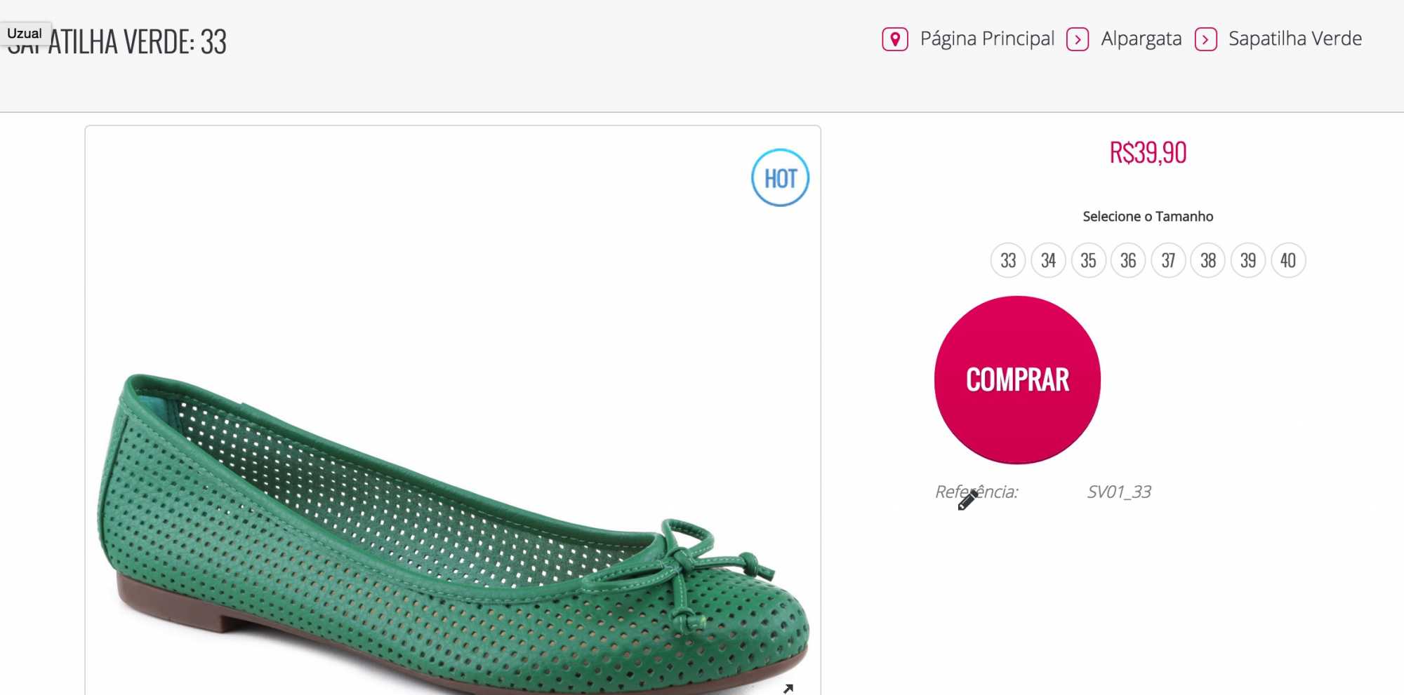

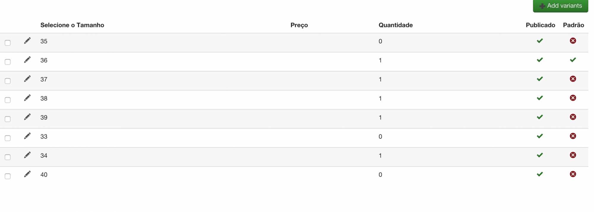

  • Posts: 28
10 years 11 months ago #212625
Have a look this image
Size 33 is out but button not change to notify me.
