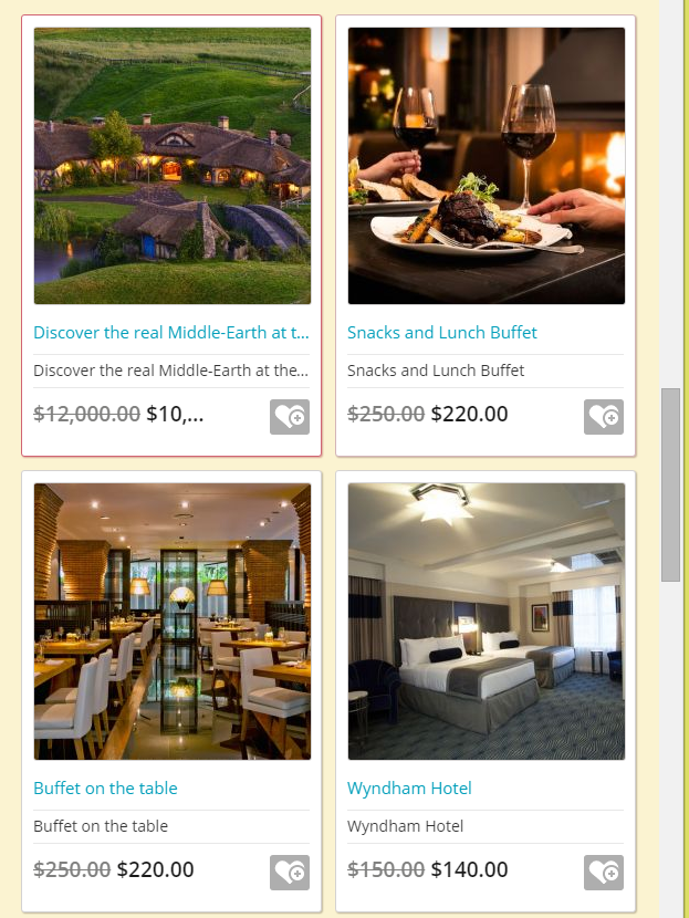

Hi, sorry my english please, i have the next problems:
1- When creating products and display in 2+ blocks layout and the page becomes smaller, all info and image becomes really small (like trying to make the hole module responsive) so finally producs remain into 2+ colums but cant be seen well, if the product boxes were responsive they should stay one on top of the other when resizing and just resize images a bit, and not resize the hole module, what can i do?

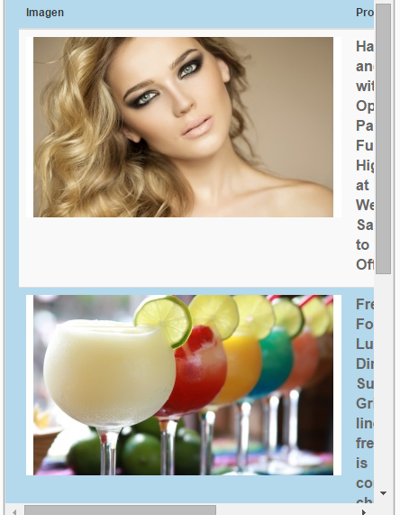

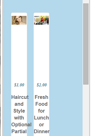

2 -When creating products and display in tables layout i get opposite problem: the image isnt responsive, so the name of the product cant be seen because while the page becomes smaller the image doesnt resize.

1. It depends on your template and its CSS. Eventually you get a better result when changing the HikaShop setting for "Use Bootstrap design": www.hikashop.com/support/documentation/i...html#display_general
If that doesn't improve things, you might need to add custom CSS with media queries.
2. HTML tables are not responsive, indeed, at least not easily. You could eventually improve things - again - with custom CSS and media queries, but it will never be fully "responsive" when using a table.

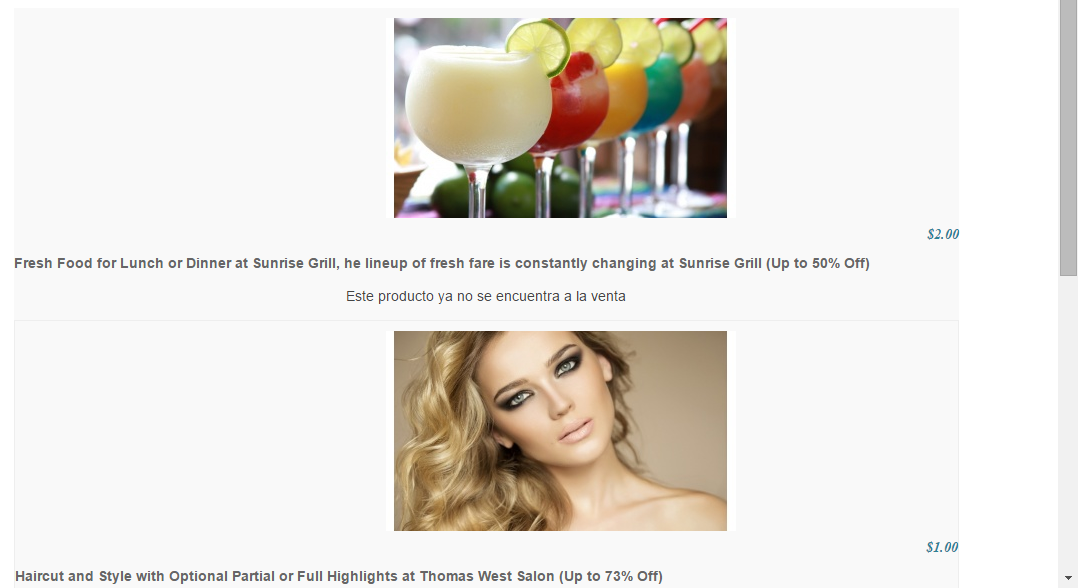

Adding the products into an html module isnt working right, the products looks not centered, wide insted of boxes style, the text all over the place, i added a picture...this is the code suggested: {product}1|name|picture|cart|link|pricedis2|pricetax1{/product}

Regarding the product content tag, it doesn't handle multiple columns. If you want a products listing with multiple columns, then that's not what you want to use. Instead, you'll want to setup a products listing module and use the extension Modules anywhere in order to add the tag displaying the module where you want.

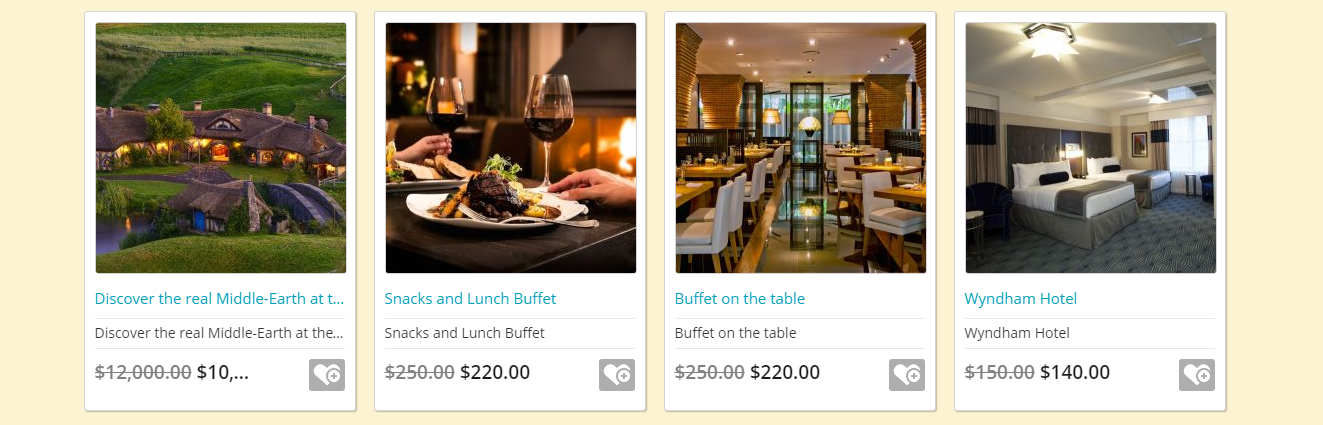

Hi, added an attachment of the exactly design i need, boxes of products that responsively change from a row of 4 in widescreen to a row of 2 in medium screen and a sinlge row for cellphone screen, please help with detailed steps, since im not an expert in html or php, also i need a before price and after with a line crossed like in the attachment.
