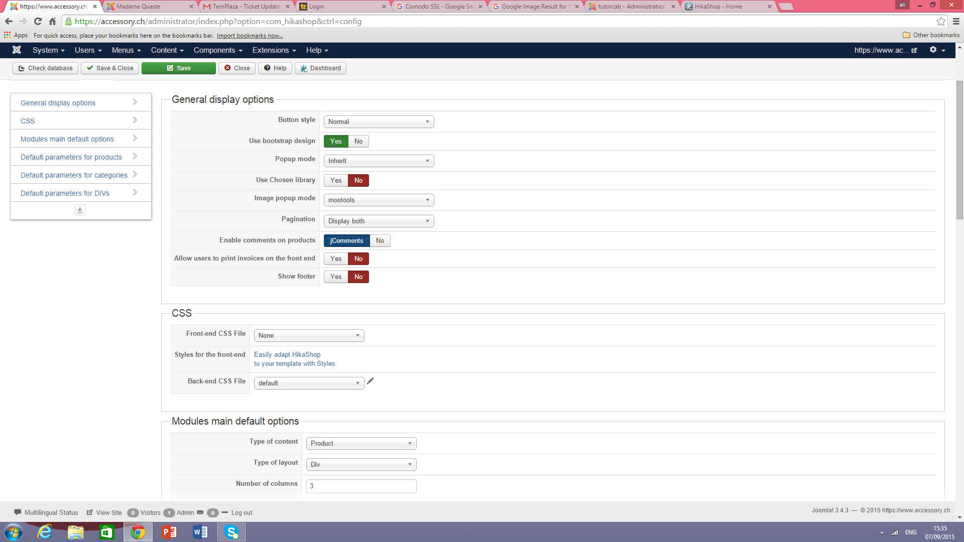

I created a custom field, (table: product, field type: WYSIWYG)
and, I clicked the jcommentson button.
In the hikashop configuration, (under display) i enabled the jcomments as well.
However, when I go to the product page a strage thing happens.
I can see the j comments while the brower is loading the page. But when the page is all loaded, i can not see jcomments anymore.
How can i solve this problem?
You can see the phenomena under this link:
accessory.ch/index.php?option=com_hikash...e&Itemid=616&lang=en
Here is the snapshot of the configuration page for jcomments
Best
Ali
