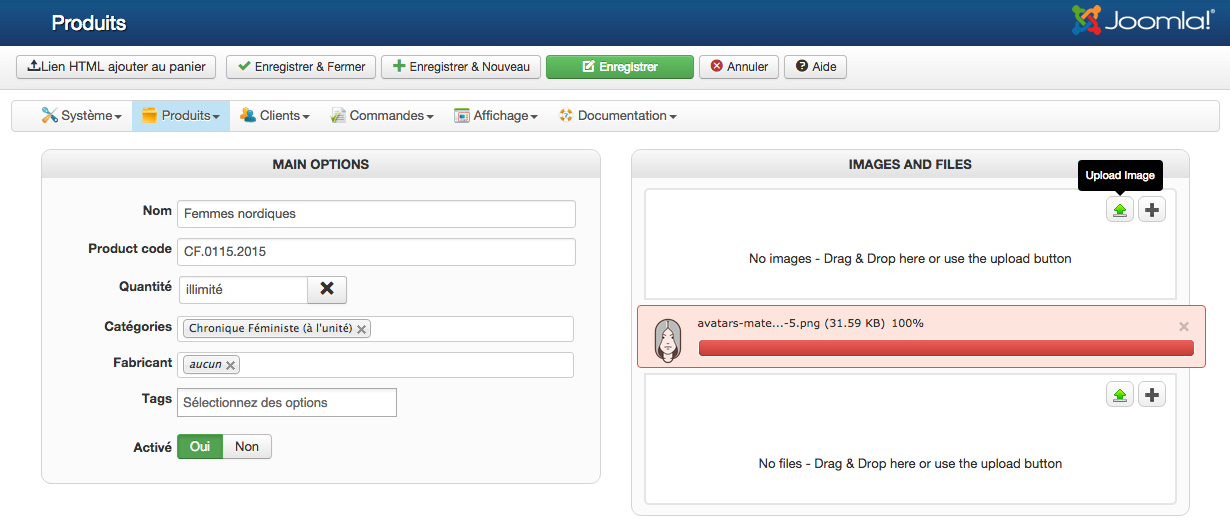

As you can see on the image of my screen : impossible to upload or drag&drop a product image.
The statut bar stay red and nothing happens.
This problem appears since I update Hikashop to the last version.
I have no problem if I choose an image which is already on the server ("add file" option).
I have no problem for category image.
Thanks a lot for your help
Céline

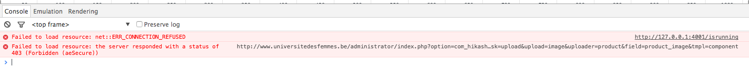

I'm having the same problem, here is the error message I see in my console. I cannot upload from the front end or the administrator portal:

I recreated my problem (uploading new image to my product) and the error message in the browser inspector is :
- Failed to load resource: the server responded with a status of 403 (Forbidden (aeSecure))
Could you please consider that Aesecure (a secure and optimisation application www.aesecure.com/en/ ) was already installed on my server before I upgrade to HikaShop 2.5 and I had no problem to upload images.
Thanks for your help.
Céline
10 years 10 months ago #217632
Well, even if you had no issue with HikaShop 2.5 and aeSecure (I don't know which version) ; now it looks like there is an issue between these two.
And we can't say why aeSecure is now blocking the uploads in HikaShop 2.6.
