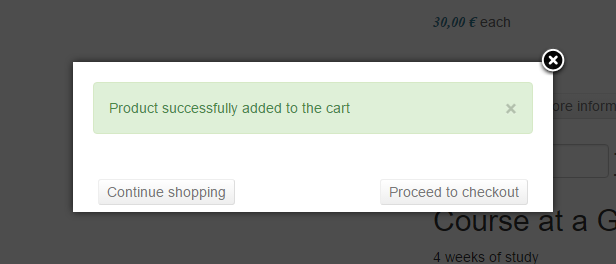

10 years 11 months ago #214414
Thank you, i have displayed the modal now but i have another problem.

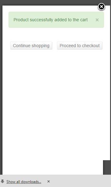

When I add a product in the cart, the popup modal that appears is as shown in Sreenshot_1, which is fine. However in a smaller screen ( like mobile ) the popup modal looks like in Screenshot_2.
Is there a way to fix the modal's height and make it responsive?
10 years 11 months ago #214494
Using some CSS code like media queries will probably help you to solve it, here is a thread where you'll find an example :
You can do the modifications in the frontend css file via the menu Configuration > Display > CSS
Use the @media tags to change the width of the columns when the width of the page is less than xx.
ex:
@media (max-width: 767px) {
.hikashop_products .row-fluid .span4 { width: 49% !important;}
Here is some documentation about the layout customization:
