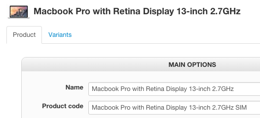

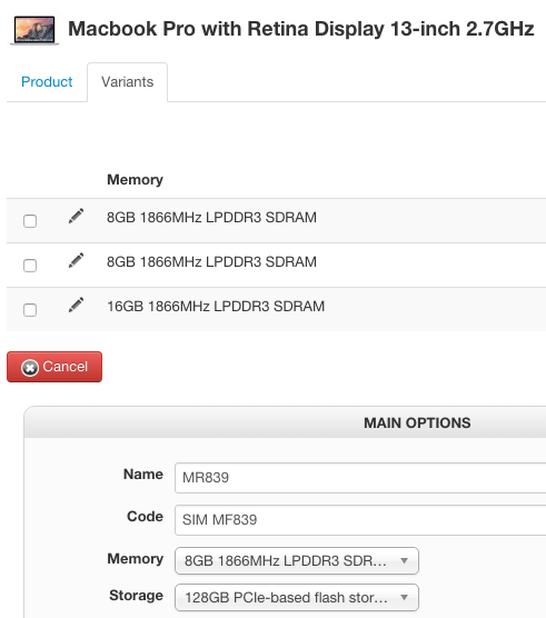

-- PHP version -- : 5.6.9
I have characteristics enabled on this product.
Both the Price as well as the Product Code works and the price change is reflected straight away on the page when I select the different characteristics on the website. I have also tested on custom fields and description, they also will change if i switch on the live site.
However, the Product Name doesn't change at all.
Appreciate your help. Thank you.
Below is the setup:
Variant 1:
