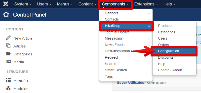

1° Go to the Components -> HikaShop -> Configuration

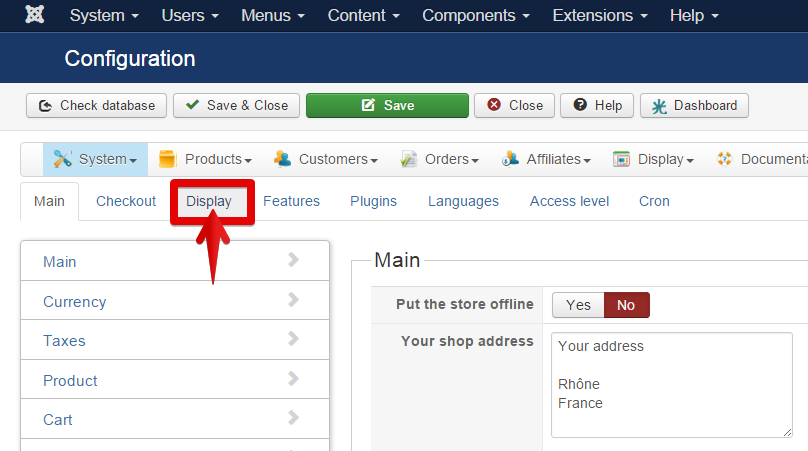

2° Click on "Display" tab

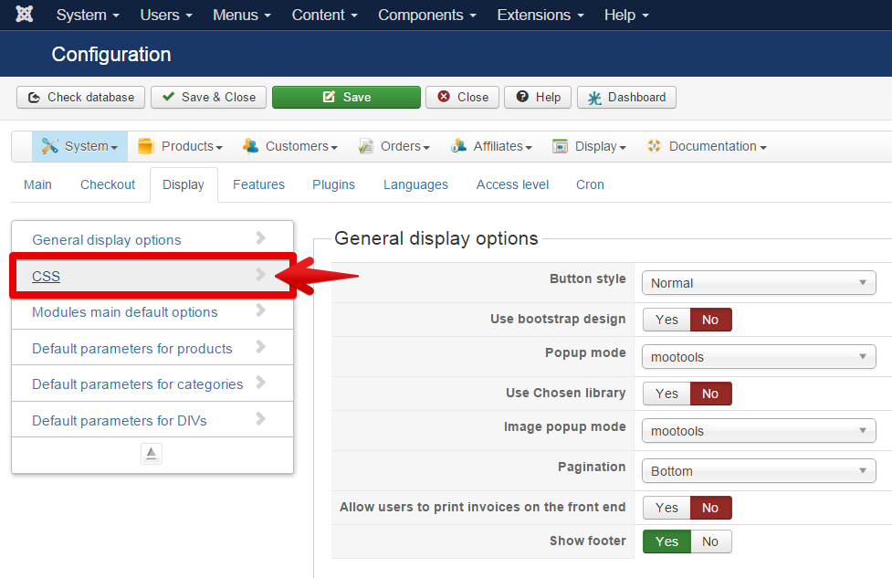

3° Click on CSS

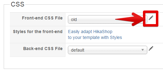

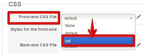

4° Here, on Front-end CSS File you must have selected "old" BUT if not, select it!
5° Click on the little pen/ "edit" icon

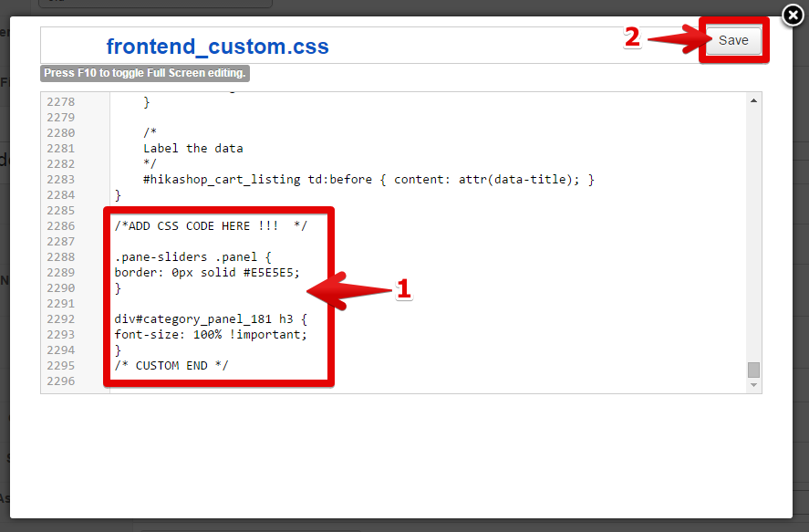

6° Copy & Paste this code :
/*ADD CSS CODE HERE !!! */
.pane-sliders .panel {
border: 0px solid #E5E5E5;
div#category_panel_181 h3 {
font-size: 100% !important;
/* CUSTOM END */
AND don't forget to save !!!
