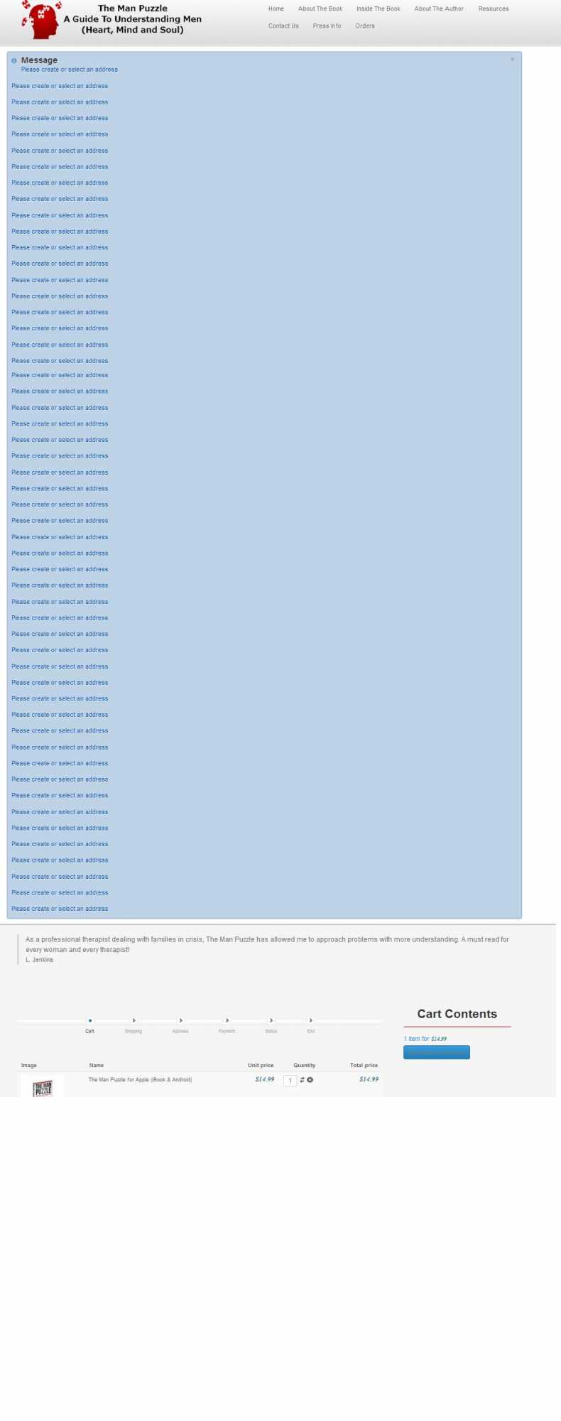

The category is now published, the products are listing but there is still one problem that prevents anyone from completing the checkout process: As per the attached file, the user is being asked to enter a shipping address.

1. Shipping is required during the checkout if:
- you have set a weight in your products, or if you have the "force shipping regardless of weight" setting of the HikaShop configuration turned on
- and you have the "shipping" view added in the "checkout workflow" setting of the HikaShop configuration.
2. I never said that 2.6.0 was the latest stable version. 2.6.0 is the latest version. 2.5.0 is the latest stable version. We just released the 2.6.0 and thus the 2.6.0 update is not activated yet if you have the 2.5.0. So either you'll have to wait that we activate it, or you can download the install package via the menu My account>My subscriptions on our website and install it on yours in order to proceed to the update manually.

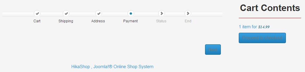

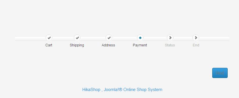

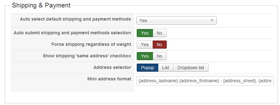

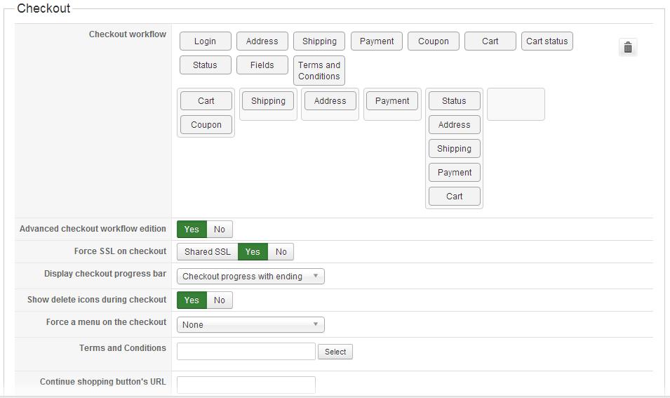

1) I did have "force shipping regardless of weight" turned on. Turned it off. (see attached images) Things went south very quickly after that... south pole, nuclear bomb south.

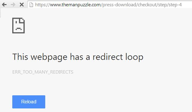

Essentially you click through to payment with no screens or prompts, click on next from the payment step (3) and then you get a timeout and an error that says "too many redirects" (see attached). When I use the browser history to go back to the start of the checkout cart, there is a screen full of HikaShop messages (see attached).

Please open new threads for new questions, unrelated to the current thread.
Your issue seems to come from your check workflow. You've removed the login view while still keeping the address view in your checkout workflow. It not something possible. Normally, you should get a warning about when you save the configuration and our documentation about that option explains it as well.
