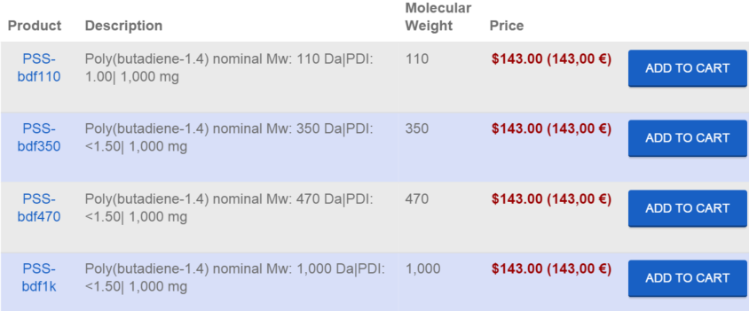

I have international customers and my cart is not displaying Euros correctly. I can view USD as I should when in the USA. I connect to a German web proxy and the currency does not display Euro. See the screenshot attached from the German proxy.

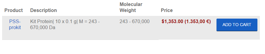

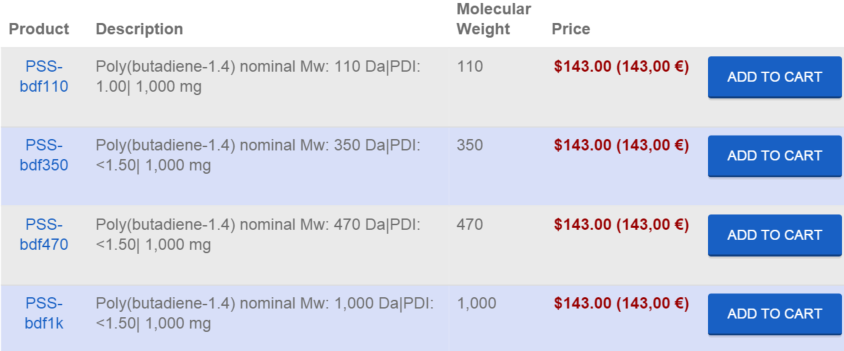

I just checked again from a German proxy and it is showing the USD prices but with the Euro symbols. See screenshot attached. It's important to realize that the USD and Euro prices is the same in the screenshot, those should be different values.
Also, I can not find "show original price" in the product detail page or in the main configuration. Am I looking in the wrong spots?
If you are in France and it seems to be working, can you send over a screen shot so I can see?

The fact that you see the same amount for both currencies simply mean that you've configured a rate of 1 in your currencies. Go in the menu System>Currencies and click on the "update rates" button in order to get the rates of the currencies.
The exact name of the option is "Show price in original currency". You can find it in the "Default parameters for products" section of the Display tab of the HikaShop configuration. And similarly in your modules/menus settings.
I went to check your website again and now I see the prices in $ only. So it seems that something changed again on your website.
