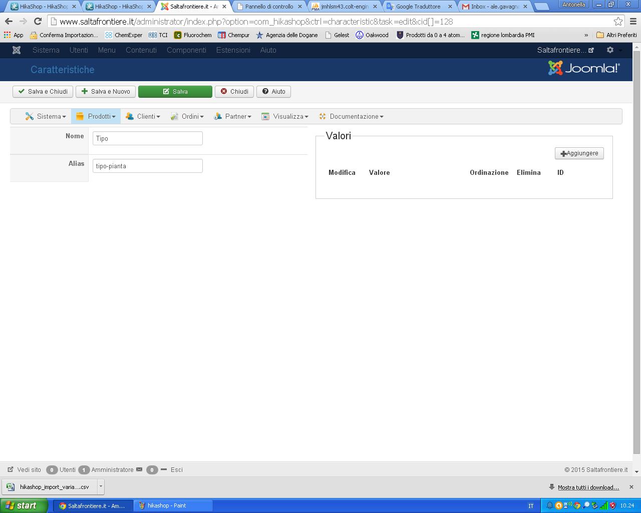

I can't insert values in the characteristics.

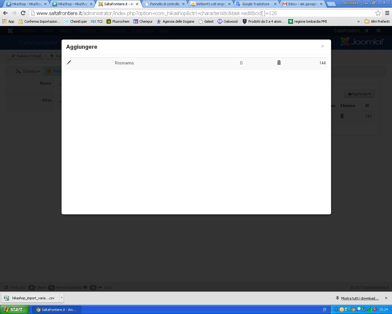

I press add, fill out the field, press ok and it remains on the value page like you can see in the attached hikashop.jpg. The Only option left is pressing x but like this it doesn't add any values like in the attached hikashop01.jpg

Well that's normal in that case. HikaShop 2.3.0 is not compatible with Joomla 3.4.4.
If you update Joomla but not the extensions, it's normal that the extensions start to break at some point.
That's because we need to adapt our code to the modifications Joomla does with the new versions.
So the solution is simple. Update your HikaShop and it will work.
