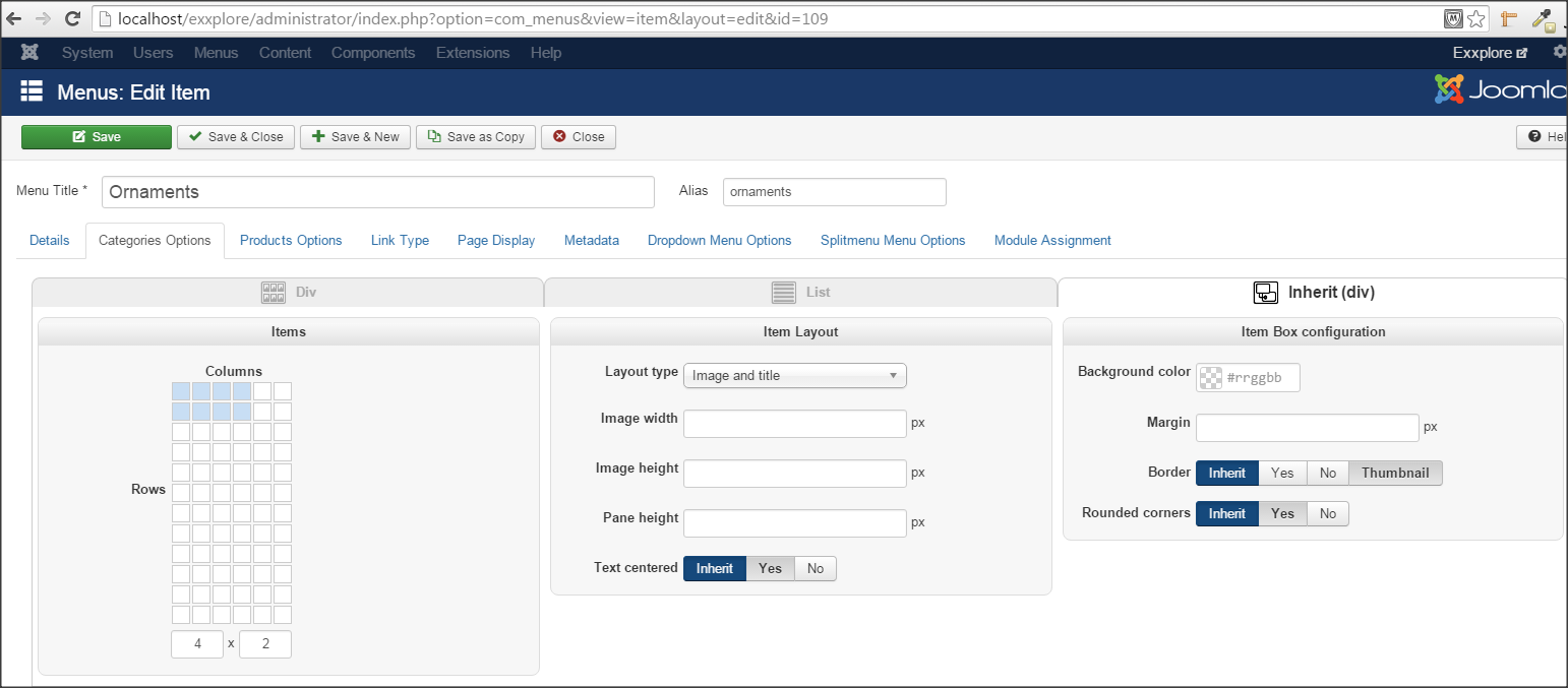

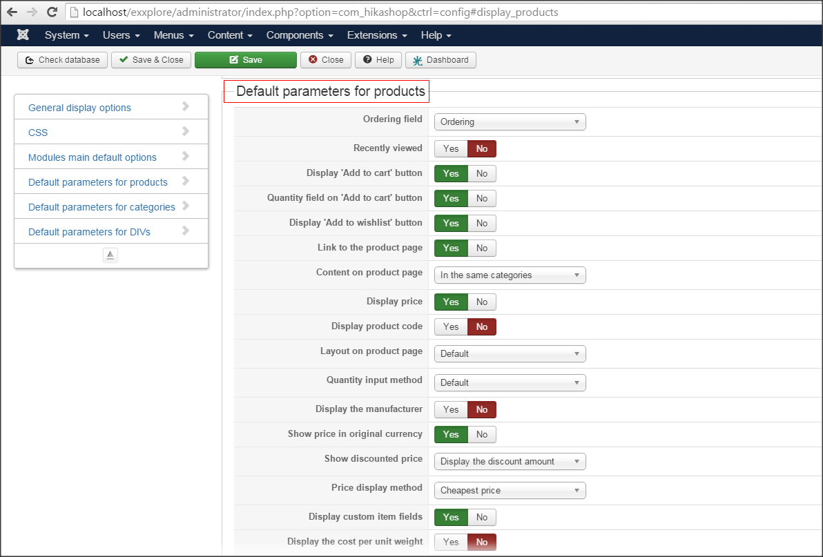

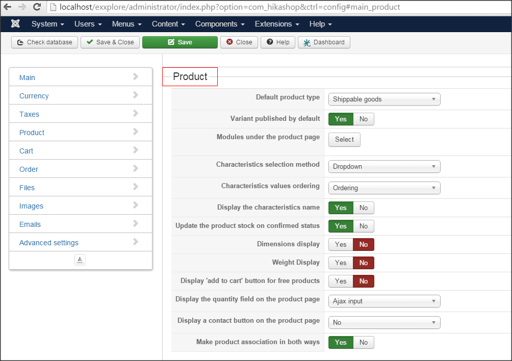

I created a menu of type "Category Listing" to display Category A. All seems to be fine, except I can not configure the product display. For example, I do not want to display "Add to Cart" Button.
I am attaching screen shots of all the relevant configuration. Please let me how to configure the product.

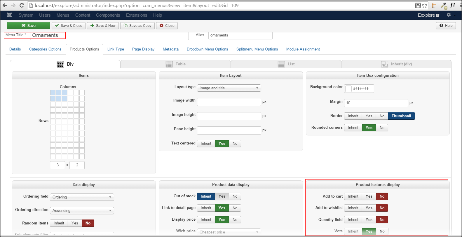

I can see the product settings on your last screenshot for your menu item. And you already have the "add to cart" setting turned off for your menu item, so you shouldn't see the add to cart button on the products listing of your menu item.

I forgot to add another screen shot. The issue is that the "Add to Cart" is showing up even though it is turned -off.
