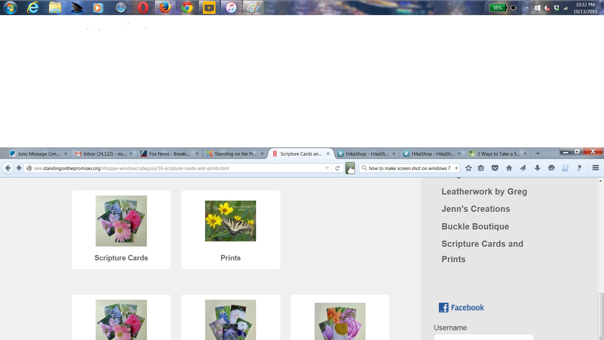

I have another situation I cannot figure out. I found something similar in the forum and upgraded Hikashop from 2.5.0 to 2.6.0, but I still have products in one subcategory that are showing up on the product category listing of the main category rather than in the subcategory.
I have other subcategories that have their products in the right place. I have searched in vain for what I have not done the same way, but I cannot find it.

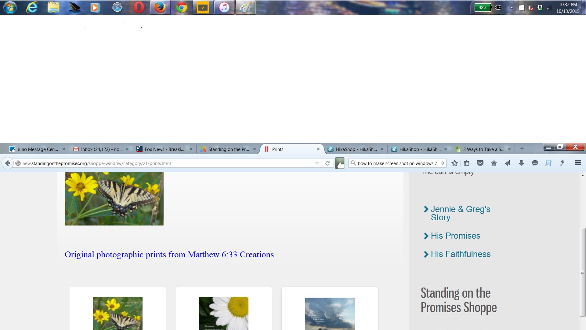

Two screenshots attached ... first screen shot: the three products need to show up when clicking 'Scripture Cards' rather than here with both subcategories. Second screen shot is what I want ... subcategory with products.

I suppose that the problem is that you have the "sub element filter" setting of the "product options" tab of your menu item set to "all sub elements" instead of "direct sub elements". So please check on that via the Joomla menu manager.

Thank you, Nicolas. When I checked, the 'direct sub elements' was already clicked. I did finally find the solution to the original question, I saw that I had the wrong category listed for the products in question. Duh :( :oops: I thought I had checked that area several times. I'm sorry.
