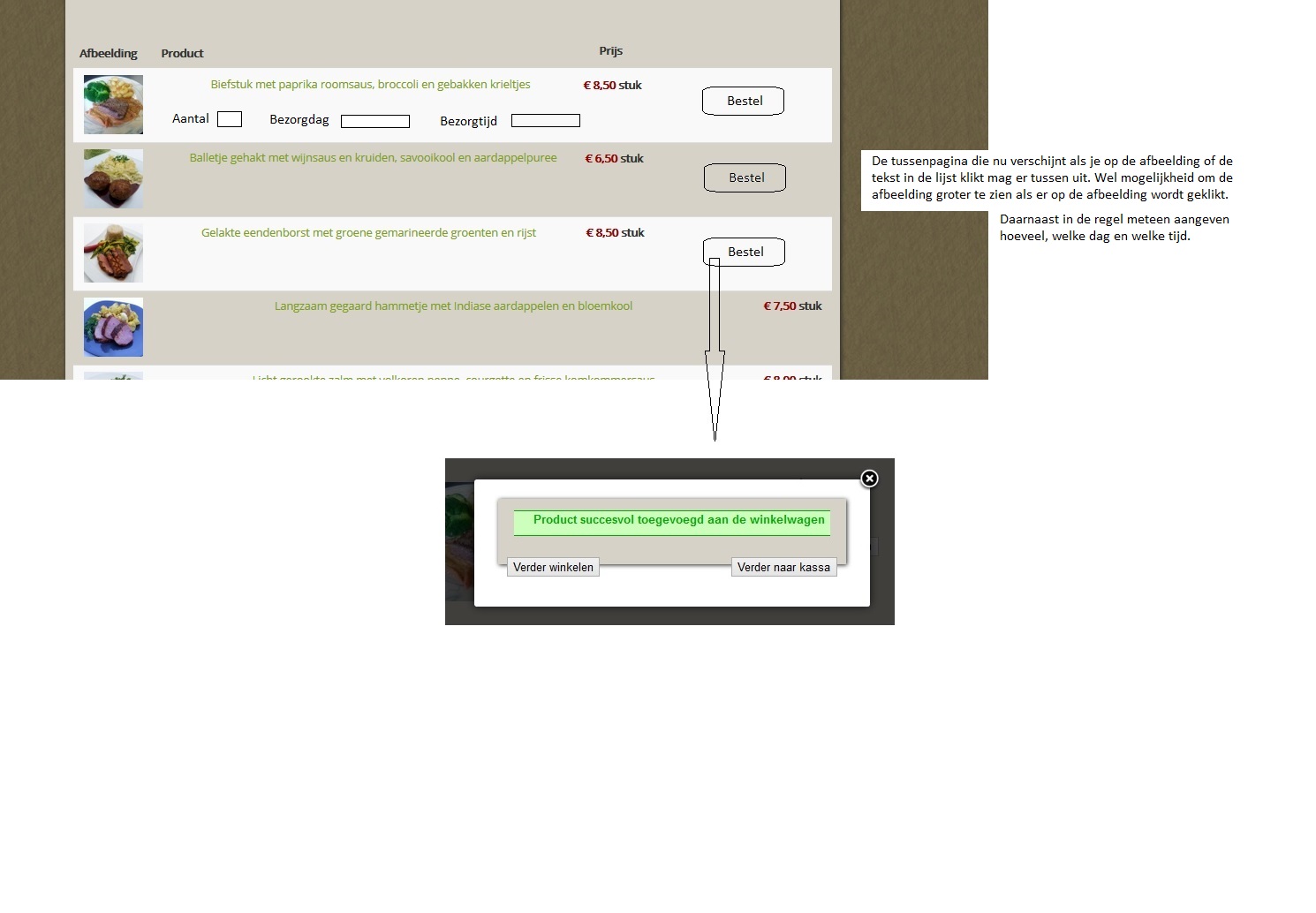

I would like to do something special on this page:
Below every product i would like to have a couple of options.
1. "Day of delivery" (drop down menu where you can select a day)
2. "Volume" (filled in a number)
3. "Time of delivery (select two times)
(please look at the attached file above)
How can i setup this on my website without any popups?
My second question is about the picture what you can see at the products. I would like to have a bigger picture when you go over the image with you're mouse cursor. How can i setup that ?
Thanks for you're support ...
  • Posts: 86075
  • Thank you received: 14184
10 years 9 months ago #218540
1. You can create custom fields of the table "item" for that via the menu Display>Custom fields, but only with the Business edition.
2. Change the "after a product is added to the cart" setting of the HikaShop configuration.
3. You'll find several thread about that:
www.hikashop.com/forum/4-how-to/49351-sh...-on-mouse-hover.html
www.hikashop.com/forum/4-how-to/42708-mo...-product-images.html
