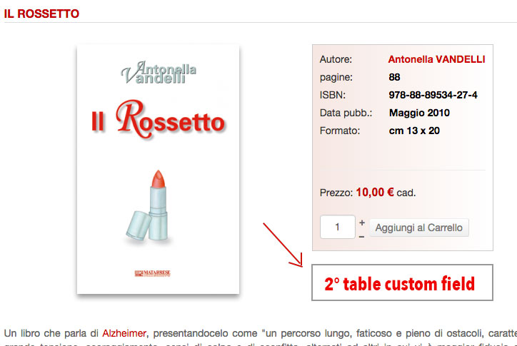

I wish to add a second table with other custom field after the "add to cart" button, out of the first right table.
Any help would be appreciated.
Thank you

I read the page indicated and I think that makes my case show_bolck_product_files, because I want to show a link of the book in ebook format to download, but if I add a custom field appears inside the tablella right, I want to appear to outside and under the right table.

So you want to modify that file and remove the display of the ones you don't want inside that area.
And then, you want to modify the file show_default to add the display of these fields there, before the bottom part of the layout.

For example, suppose that the field that you want to display separately is called "test", you could add the line:
if($fieldName == 'test') continue;
after the line:
foreach ($this->itemFields as $fieldName => $oneExtraField) {
in show_block_custom_item in order to skip the display of that field in show_block_custom_item.
And then you could copy past the code of that file in show_default and change the line:
to:
if($fieldName != 'test') continue;
That's what I wanted to say in my previous message so as you can see, it's not really complex to do if you know a bit of programming.

In the panel to create custom fields I mentioned a text area "ebooks", then: label and column name is "ebooks", now if I enter the code
if($fieldName == 'ebooks') continue;
after
to skip the field, this does not work, the field remains visible.

Are you sure that you are editing the view at the correct place in the correct template ?
The custom fields are of the "item" type ? If it is "product" so the view to edit is "product / show_block_custom_main".
