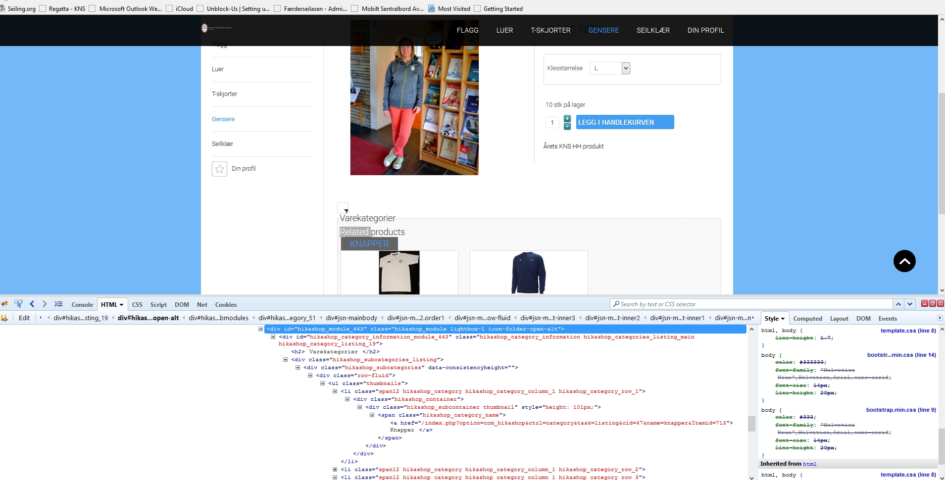

Category listing showing on top of related product
  • Posts: 4
10 years 8 months ago #222196
-- url of the page with the problem -- : www.kongelignorskseilforening.no/index.p...ttegenser&Itemid=772
-- Joomla version -- : 3.4.5
-- PHP version -- : 5.6.13
-- Browser(s) name and version -- : Chrome/Firefox
As you see from the picture there is a modul_443 making the Category listing showing on top of related products. Probably a problem from 2.5.0 to 2.6.0 update... All the associated modules is deleted and my last 2.6.0 update was done yesterday.
  • Posts: 86075
  • Thank you received: 14184
10 years 8 months ago #222247
It's not related to the update.
It's just that you have these two modules published in the "modules under the product page" setting of the HikaShop configuration.
  • Posts: 4
10 years 8 months ago #222424
"Modules main default options" or "Default parameters for products" you mean? I have changed the "content on product page " to related. Under "modues main.." there is no solution NOT to remove Associated category..
  • Posts: 86075
10 years 8 months ago #222465
No, you're not looking at the correct setting. "Modules main default options" is something else.
The name of the setting is "modules under the product page". You'll find it in the "Product" section of the "main" tab of the HikaShop configuration.
