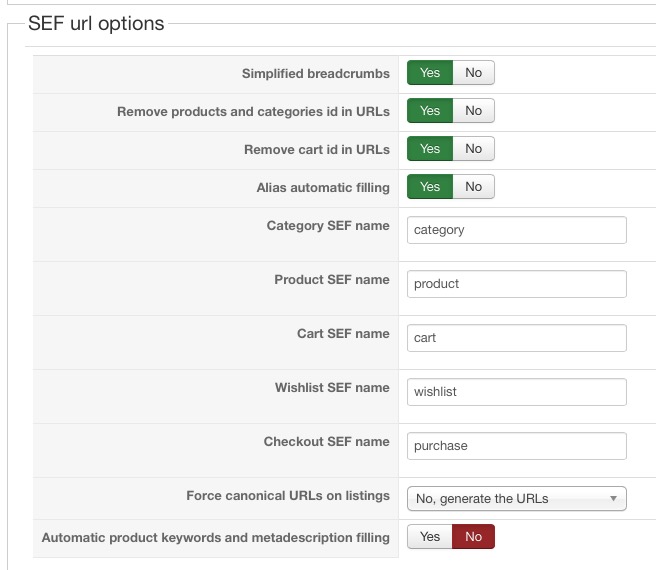

  • Posts: 82
10 years 8 months ago #222861
I have tried that but it didn't solve the issue.
Here is the screenshot:

  • Posts: 86075
  • Thank you received: 14184
10 years 8 months ago #223120
The problem is with the "Checkout SEF name" setting.
The popup notice still tries to use the "checkout" controller even though you changed it.
I think that it could be liked to a customization but hard to say what.
Put back "checkout" in that setting and that should fix the problem.
  • Posts: 82
10 years 8 months ago #223162
I changed the Checkout SEF name setting to what you see in the screenshot, in an effort to make it work, because the original "checkout" name had the exact same issue giving the 404 error on the add to cart popup.
