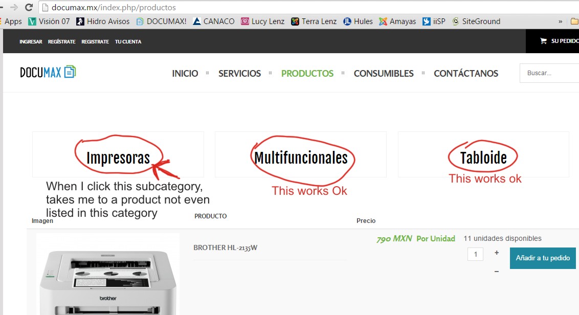

On my main category products there are 3 subcategories, each category has diferent products, but when I do click in one of these subcategories it display a product that belong to a different category.
I noticed that the URL address shows something that is not right to me. Let me share these:
documax.mx/index.php/productos/category/13-multifuncionales This link works ok
documax.mx/index.php/productos/category/14-tabloide This link works ok
documax.mx/index.php/productos/tabloide In this link there is not a category, skips into a product A product that is not even in that category
I double check that the "data display" has the right category.
Any help will be very appreciated
