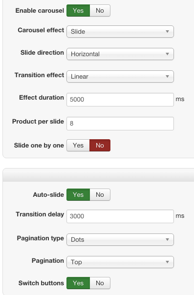

I configure a content hikashop module with the carousel.
But the slide is not working.

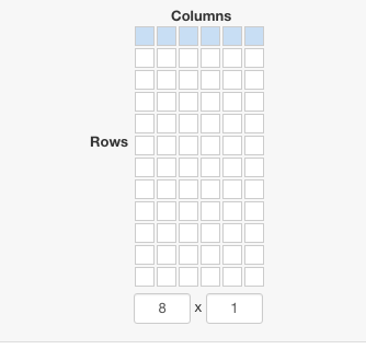

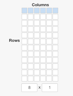

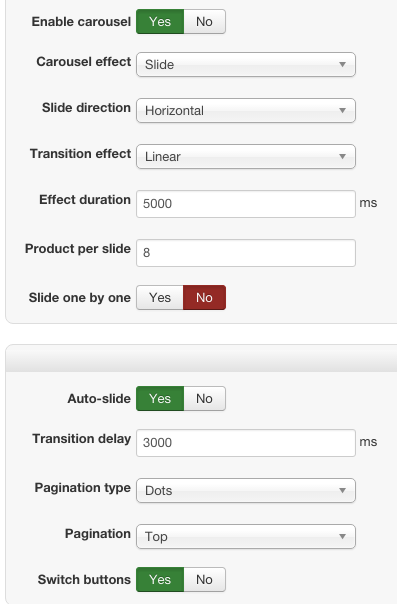

For example I create this module "PRODUCTOS PARA BAJAR DE PESO" in home page.
The category that I'm using have over 20 products. I set the products per slide to 8
but the slide do not run and if I click the arrow do not scroll.
I attach print screens of my configurations.
Any idea?
Thanks,
Jose
  • Posts: 86058
  • Thank you received: 14184
10 years 8 months ago #224015
The problem is that you have configured the "product per slide" setting with the same number than the total number of products to be displayed by the module. Reduce the number in the "product per slide" setting, or increase the total number of products on a row and that should work fine.

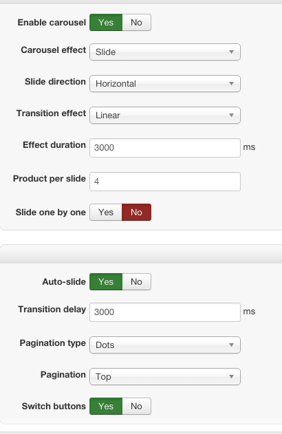

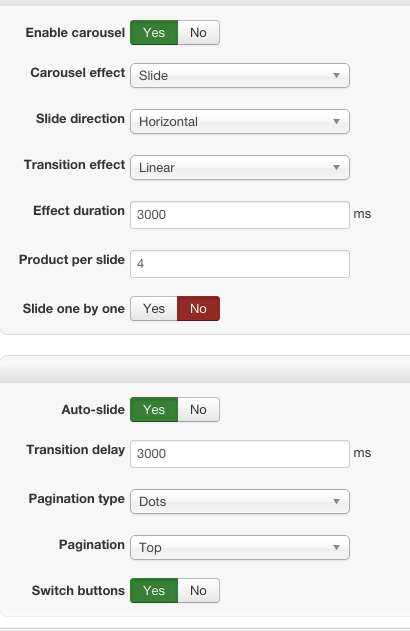

10 years 8 months ago #224041
Hi, Could you check now?
I change the products per slide to 4 but the slide don't start automatically. And the same with the arrows or dot.
melprokwebsolutions.com/WebSite_Client_Develop/alexhealth/
Thanks,
Jose
  • Posts: 86058
10 years 8 months ago #224071
I still see the module as if it was 8 products per slide.
Are you sure you modified the correct module ?
Are the other options of the module taken into account ?
What if you increase the total number of products from 8 to 16 ?

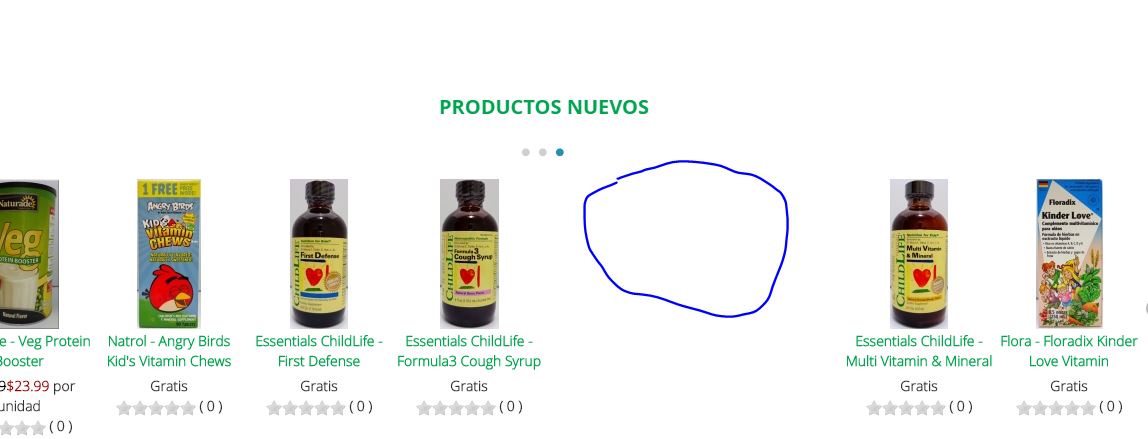

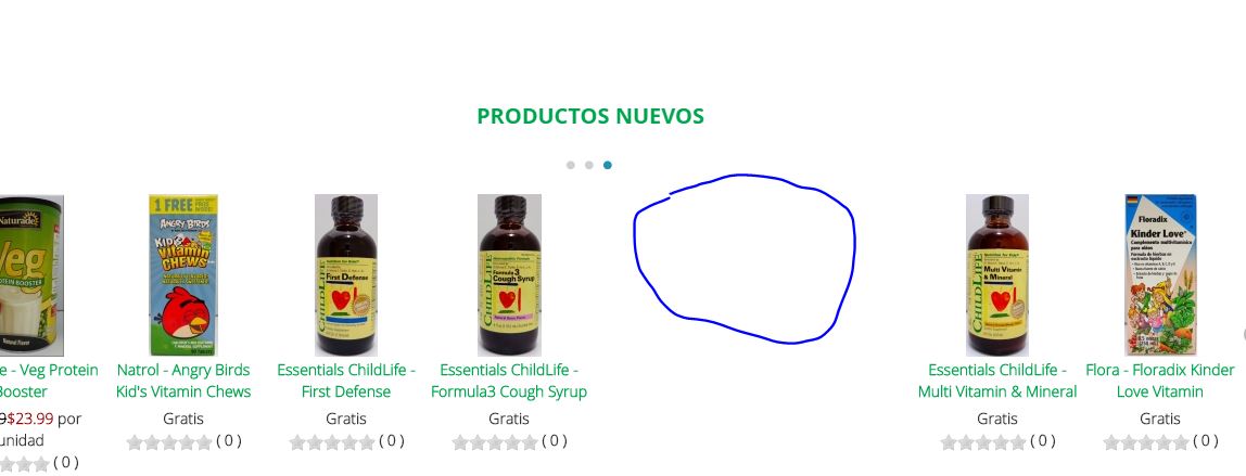

  • Posts: 86058
10 years 8 months ago #224185
The issue is that you have 6 products per slide now but with only 8 products displayed in total. So the second slide page has only 2 products placed in the middle of it and you get some blank. So again, it's just a matter of configuring the settings of the module the way you want it to behave.

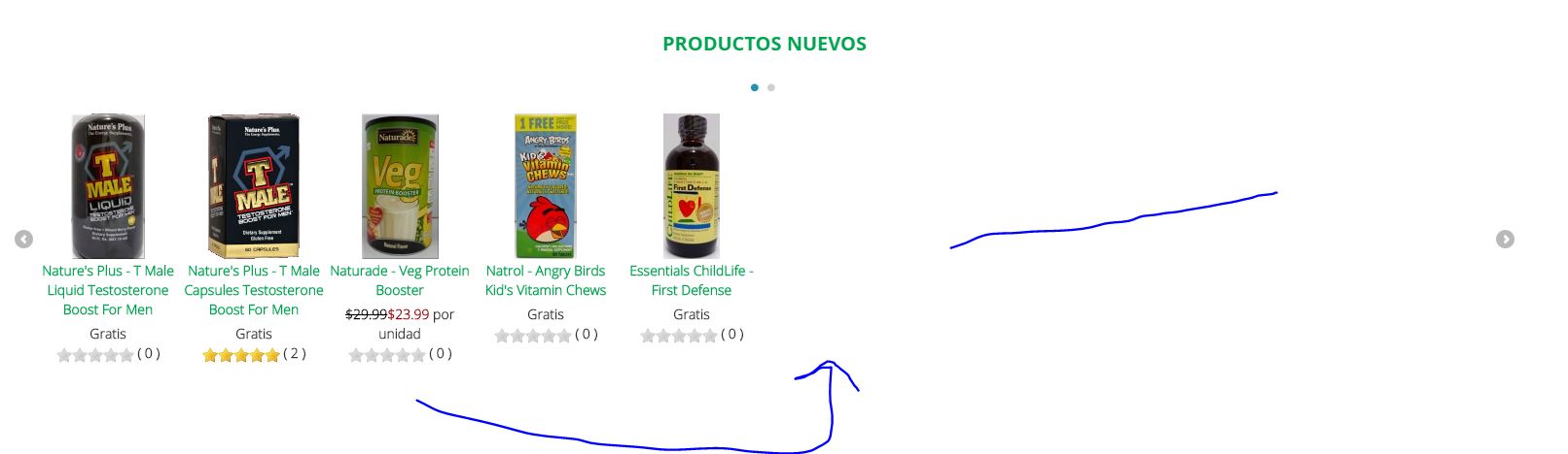

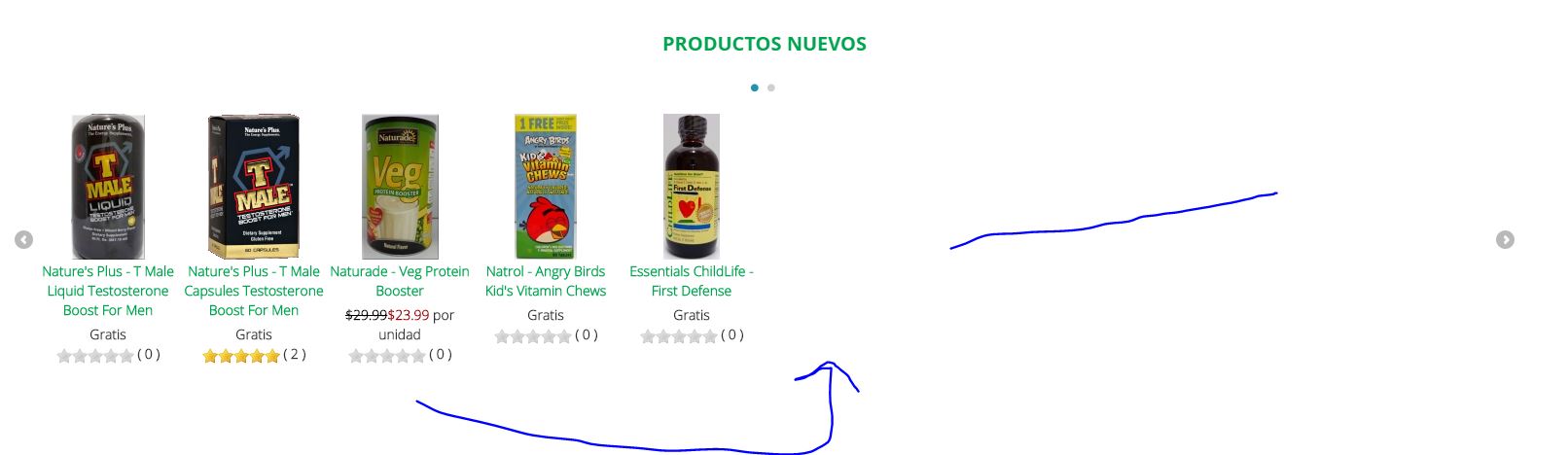

  • Posts: 73
10 years 8 months ago #224267
Ok, I see...
Then, how I can control the width? I mean to center te slide.
I include a picture with what I say.
Thanks for your help...
10 years 8 months ago #224346
Please try to add this css property at the end of your css file:
#hikashop_main_slider_hikashop_category_information_module_178{
    width: 600px !important;
