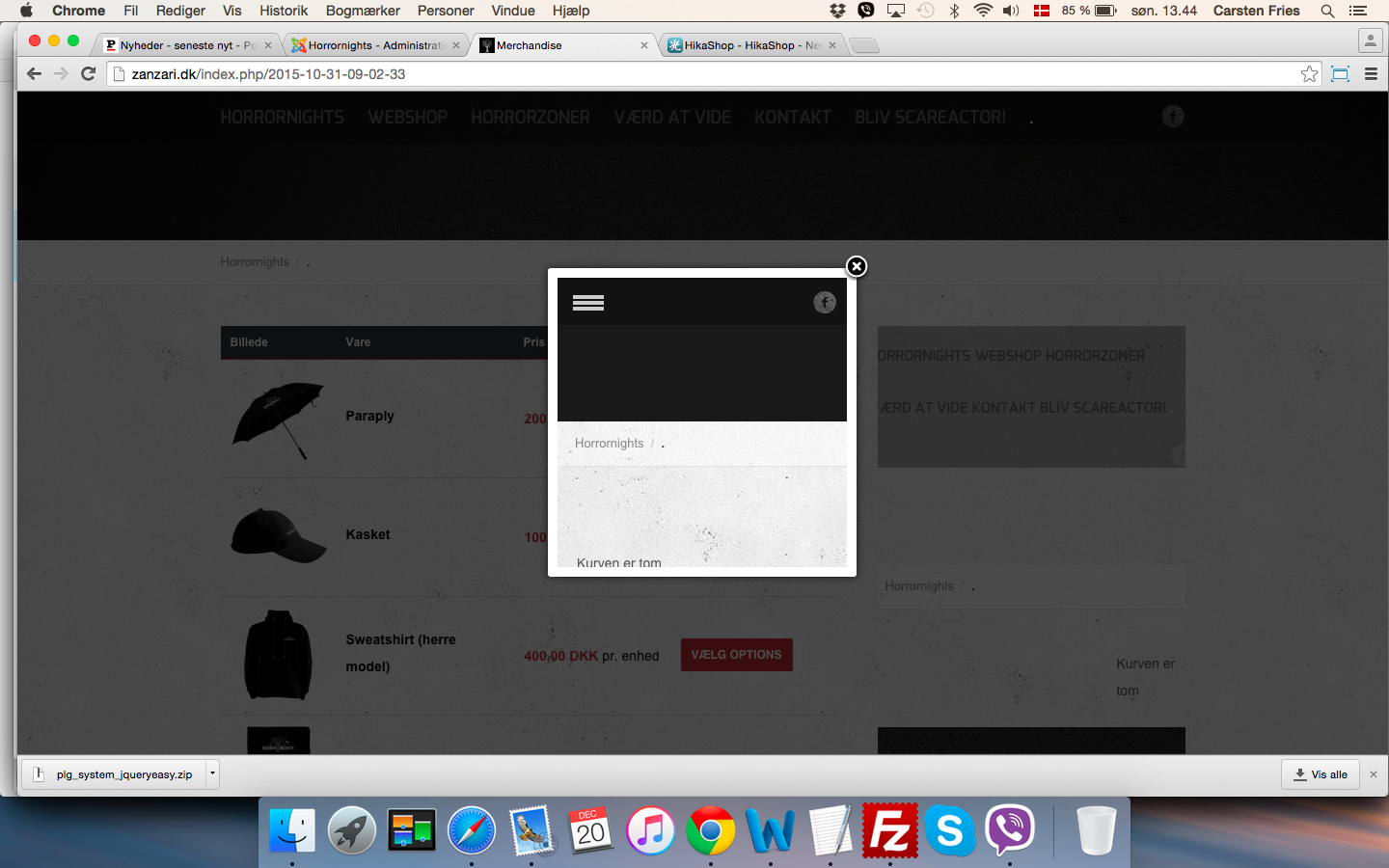

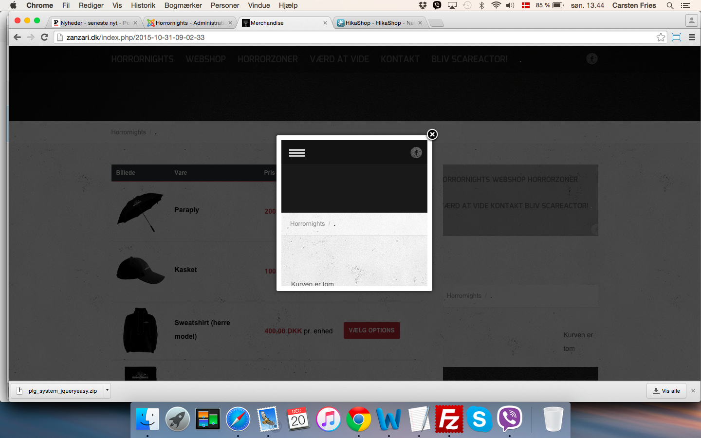

I have this problem:
When I add a product to cart, the popup is not reacting as normal. Instead of adding the product to the cart - it displays another view of the website in the popup, as well as in the cart view.
Best regards
Carsten

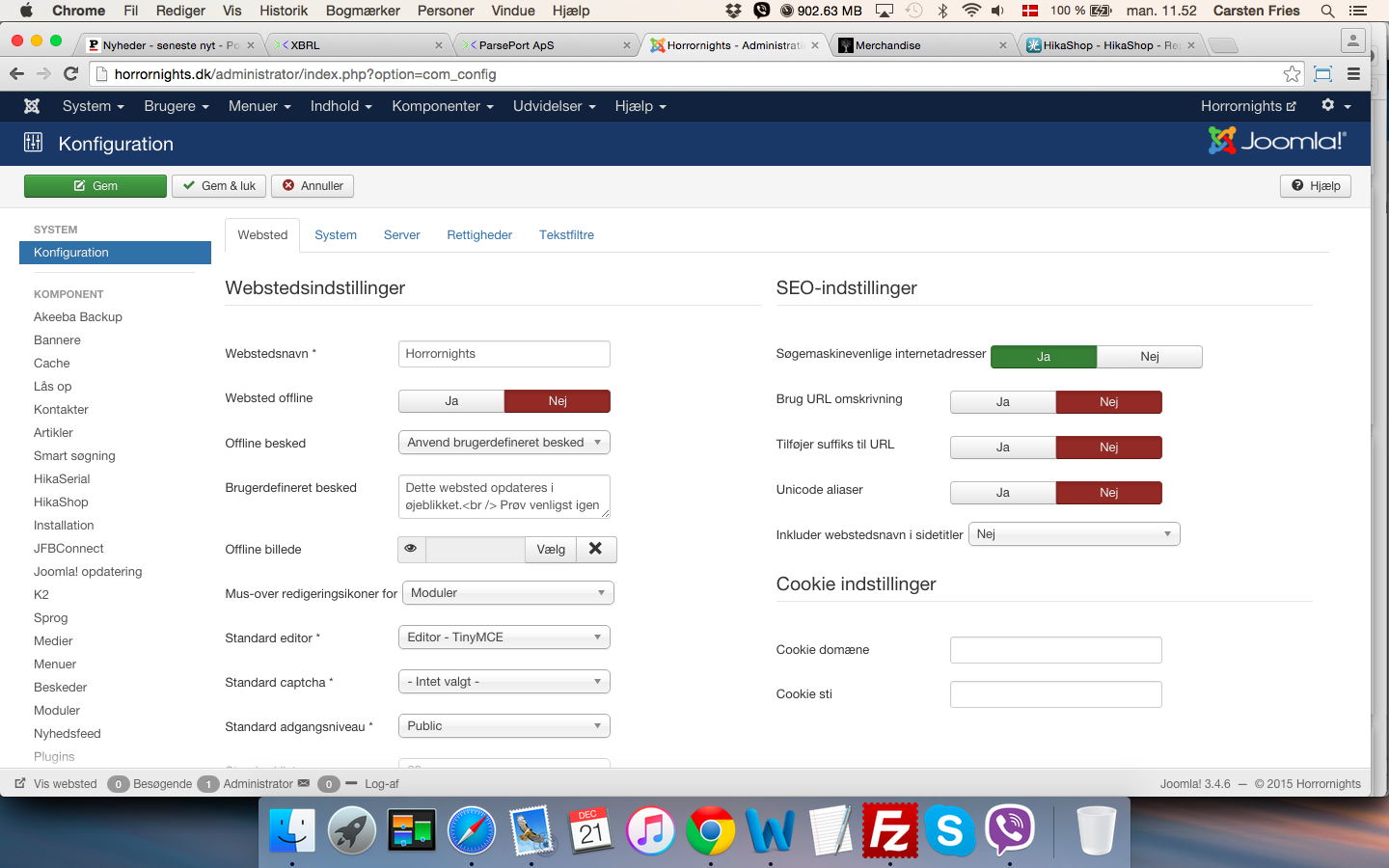

10 years 8 months ago #224749

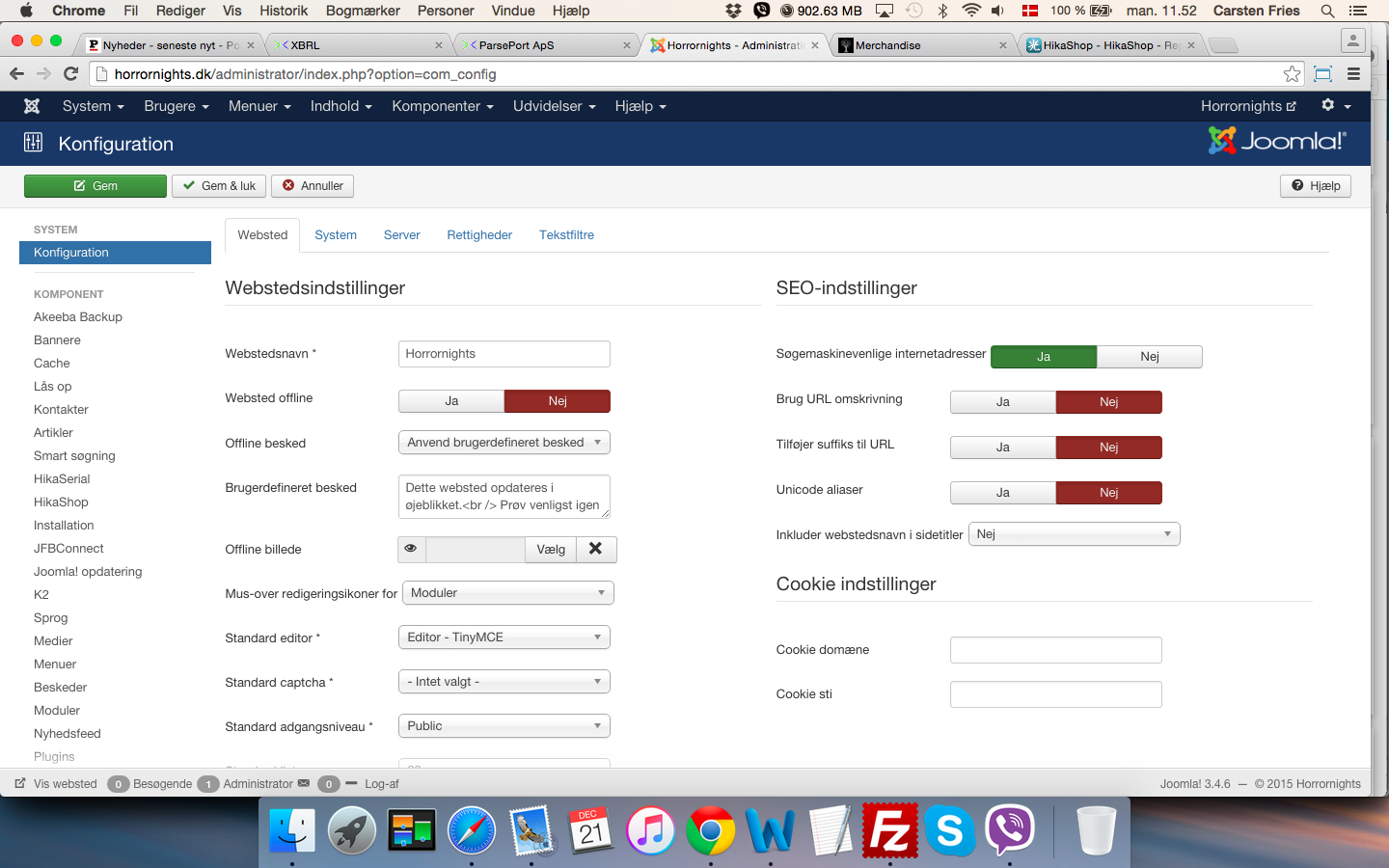

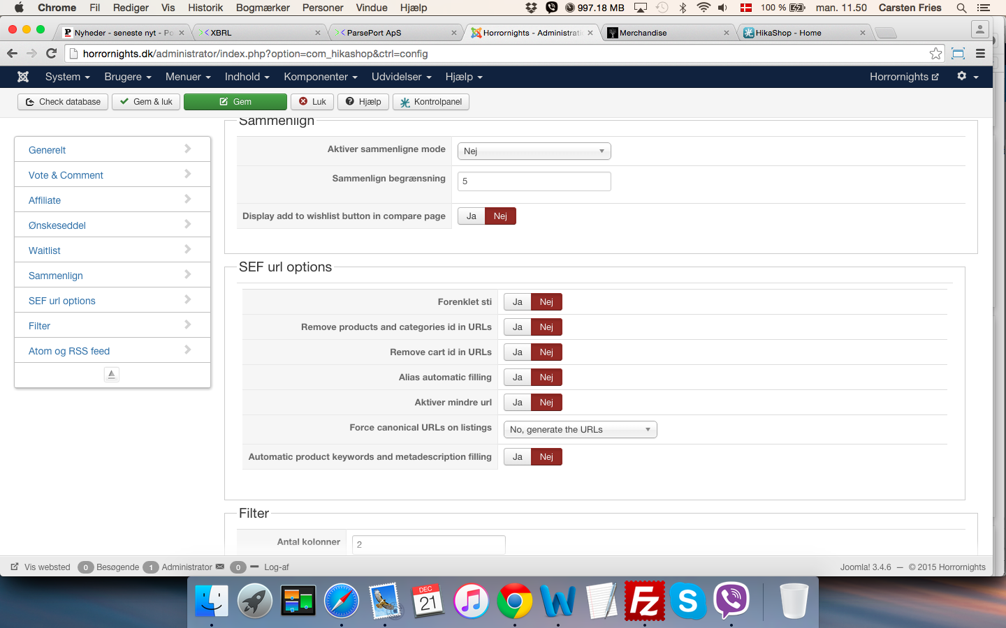

Hi Nicholas
Yes it is truly strange. Attached are screenshots of SEF settings in Hikashop and Joomla Global Configuration.
Do you think it is a javascript conflict?
Best regards
Carste
  • Posts: 86058
  • Thank you received: 14184

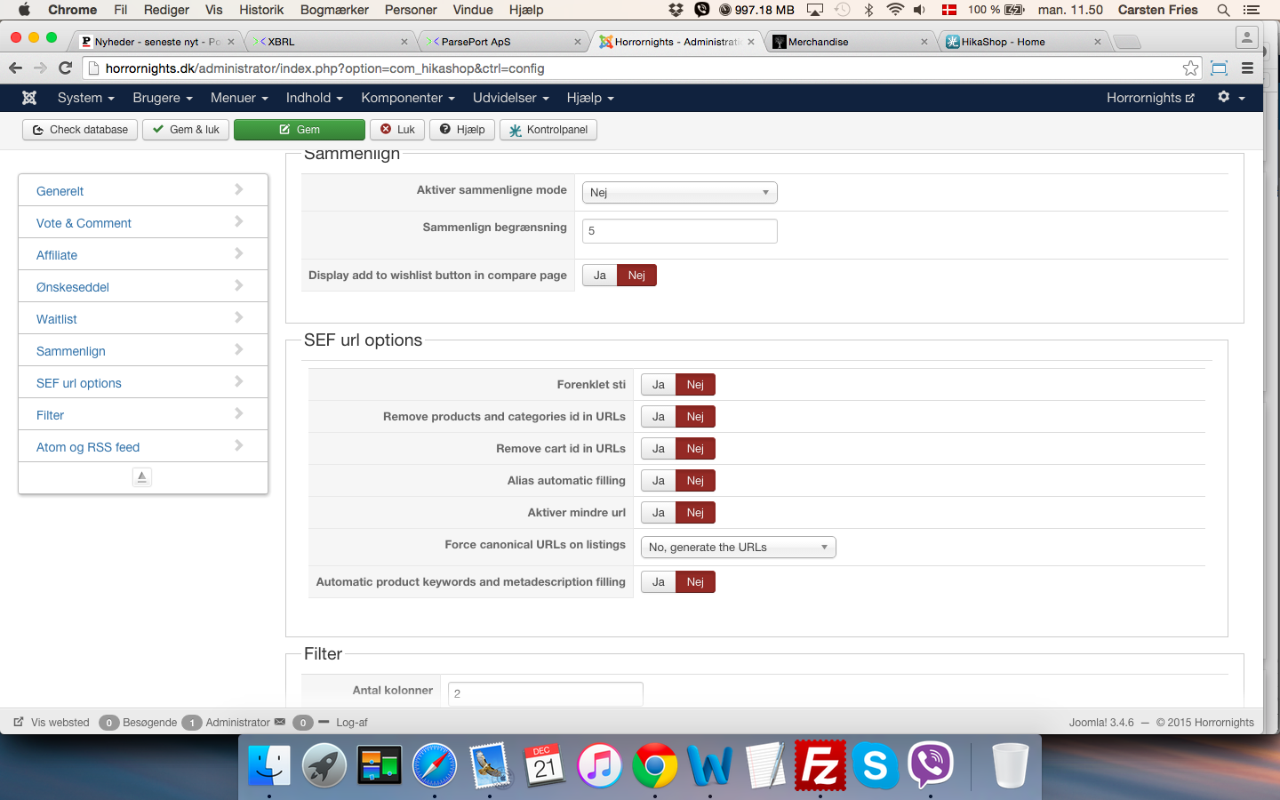

10 years 8 months ago #224752
Mmm. It's probably linked to the "activate mini URL" setting that you have in the HikaShop configuration. Try turning it on.
The following user(s) said Thank You: kontakt@friesbureau.dk
  • Posts: 43
10 years 8 months ago #224811
Yes it works now. Thank you :-)

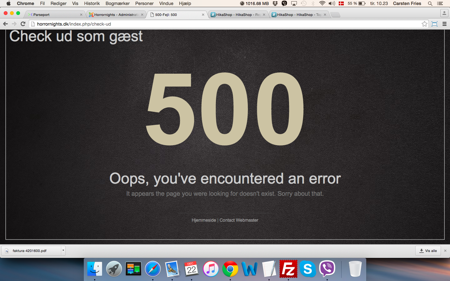

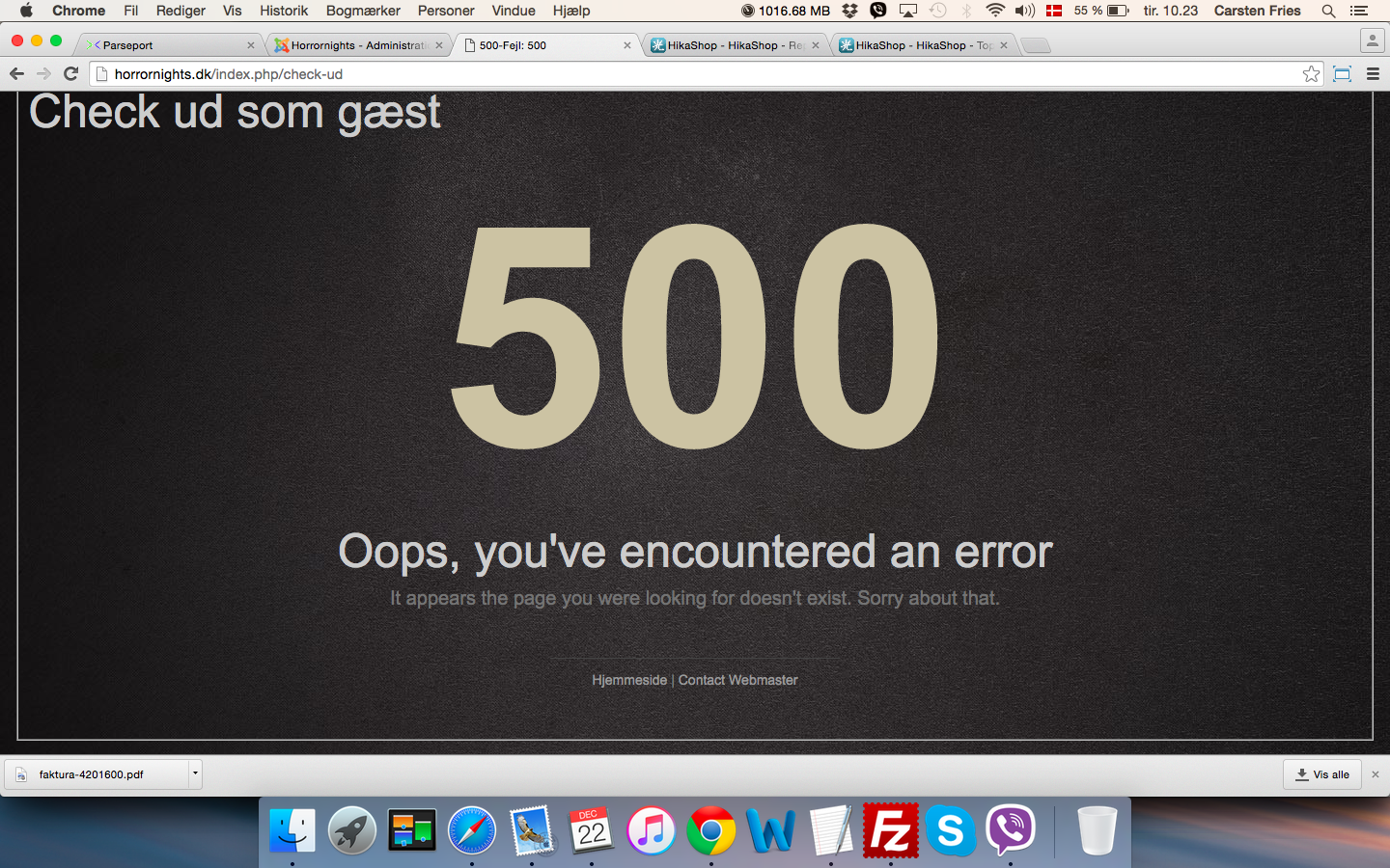

Subsequently i received an error 500. I looked it up in the Developer Tools Console.
"Failed to load resource: the server responded with a status of 500 (Layoutet registration_form ikke fundet.)" Translated = Layout registration form not found.
Maybe I have to transfer a new installation manually via ftp?
  • Posts: 86058
10 years 8 months ago #224860
Mmm. That layout doesn't exist.
So it might a problem with your template.
Try renaming the folder templates/YOUR_TEMPLATE/html/com_hikashop/user/ via FTP and see if that helps.

10 years 7 months ago #225111
In the FTP you provided the issue comes from the file /templates/gk_fest/html/com_hikashop/user/registration.php
which has been incorrectly customized by the template. I've renamed it to registration_.php and that should fix the problem.
So the problem was indeed coming from your template, not HikaShop.
