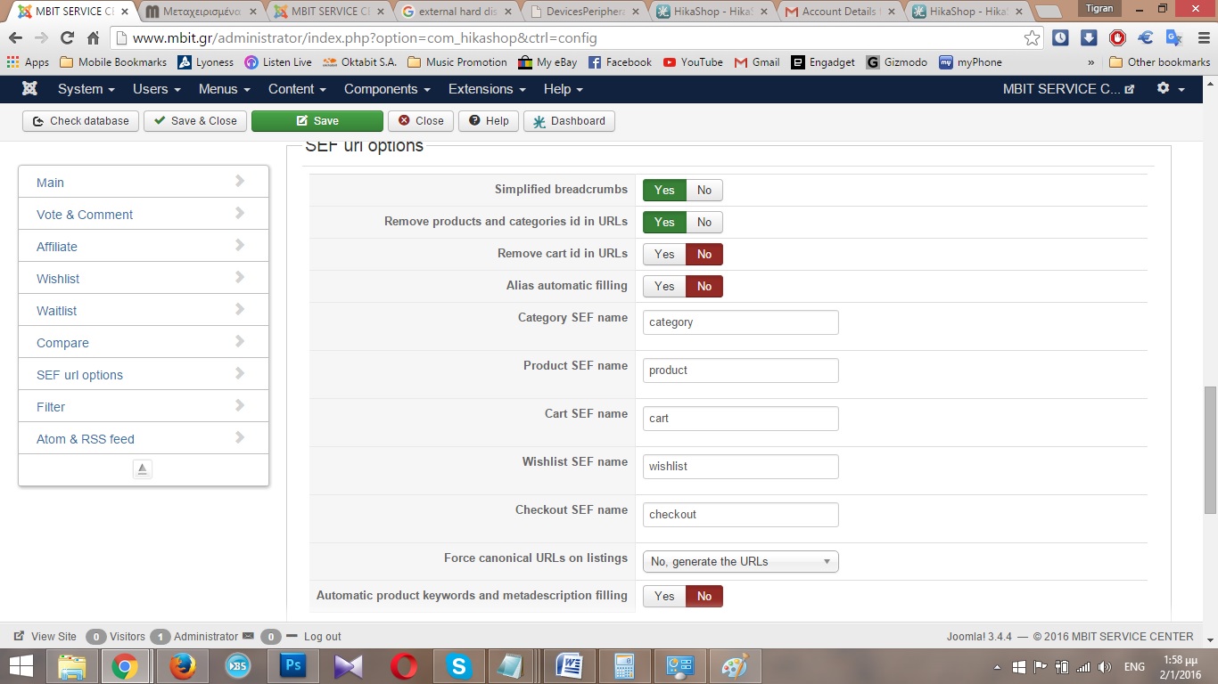

  • Posts: 252
9 years 8 months ago #226024
Before I do something wrong.
Are these the correct settings for resetting the canonical url?
9 years 8 months ago #227288
For the type it is better to select "String" instead of "Int", else it is correct.
As usual a backup of the database is always recommended before launching a mass action.
